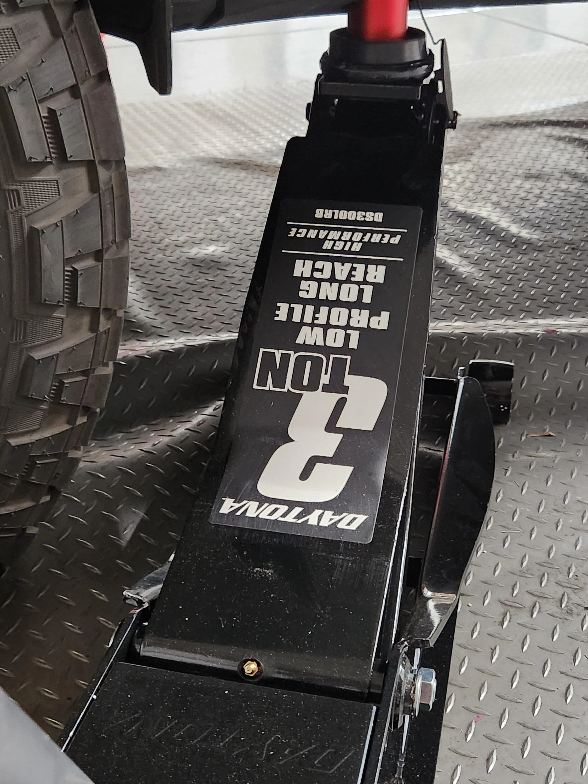

Discount has worked with Rivian to have their own variation of pucks made that will work with their low-lift floor jacks. Cheaper to buy some variant of a puck, than to purchase thousands of new floor jacks.
Any DIY person should immediately purchase the HF Dayton 3T unit with the 24 1/2" lift height. It is the best overall option out there. Robust, affordable and readily available to most of America. It will lift the front or rear wheels off the ground without a struggle.
FYI: The rear on the R1's has more suspension droop, so it requires more lift than the front wheels to get the tires off the ground.

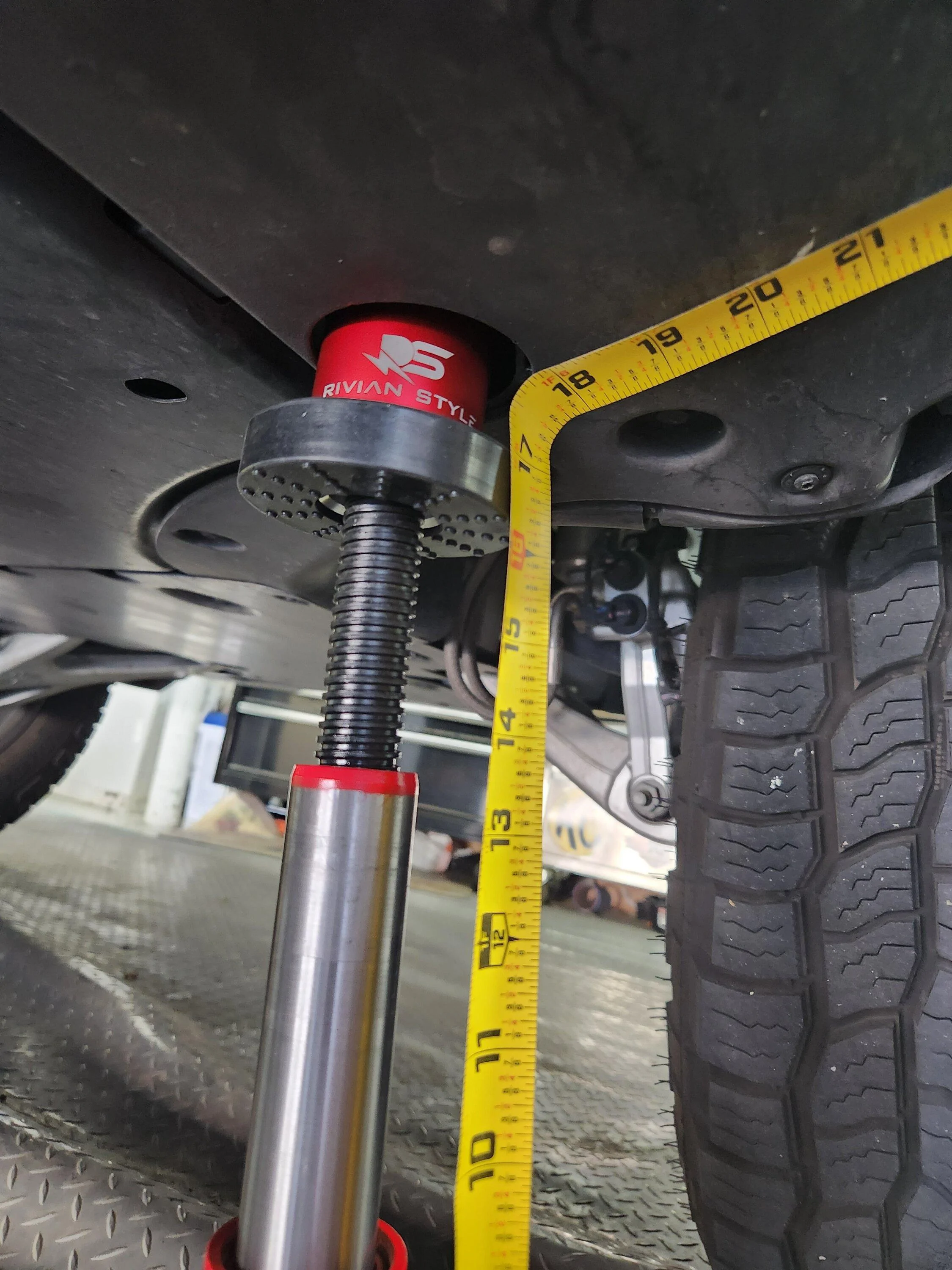

@Mark_AZR1T
With the suspension droop, how high does the jack stand need to be? When placing the vehicle in Off road All-terrain and the highest ride height, the ground clearance should be 15 inches. Some jack stands that I've found only go up to 16.5 inches.
https://www.ecstuning.com/b-schwabe...Ujm2IBDrtFtE33Ulx6aTPZoHrbonTa4RoCpm0QAvD_BwE
https://shop.teslarati.com/products...urw81kTxnMKqFCK-H1BBAt57PPSVEKdRoCJBIQAvD_BwE
While expensive, the Rennstand looks really nice since it can be placed directly under the lift point with the bottle jack in place, and it looks like the tESLA specific pad (0.75" diameter) would accept the MagJaxx puck (1.3" diamater).
There are some that do go over 20", though.
https://www.grainger.com/product/33...6aG0kMav7g5NOcS2OoBoCqBMQAvD_BwE&gclsrc=aw.ds
https://www.grainger.com/product/AME-Jack-Stand-Pin-33W486?opr=PLADS&analytics=FM:pLA&a2c_sku_original=33W485
https://www.amazon.com/BESTOOL-Stan...22-b445-b65037083fba&pd_rd_i=B09KN15PB8&psc=1
So what is the ideal height?

@Mark_AZR1T
I'll measure this sometime today for you on the rear. As noted previously I use the 4T jack stands below, because of four main factors. Robust weight rating, flat top for use with our magnetic jack pucks and lift height. The front takes approximately 18" to get the tire off the ground and the rear approx. 21", affordability. They are sold in pairs (not by me).
