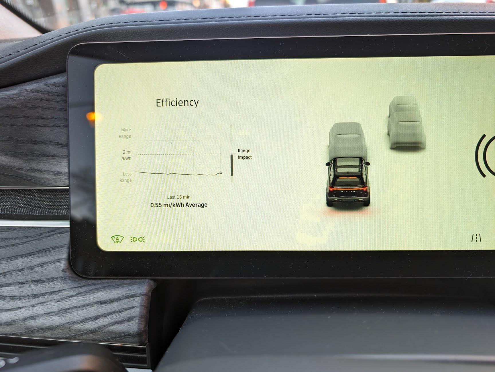

While I am not terribly bothered by this (as it's somewhat a worst case scenario) I can't say it still wasn't a little surprising to see it...
Cold battery, heat on 70, seat warmers (2) on 2nd pip, steering wheel heater on, stop and go Chicago traffic for a short trip and...
Rivian R1T R1S First real winter weather with R1S JK8psDdIgL_4Z-tKPTM=w1728-h1301-s-no-gm?authuser=0
And to be fair, on the way back, I dropped the heat a bit to 68, turned off the seat and steering wheel heaters, and the battery had warmed up above 50F and things got to about 0.7mi/kWh which is still not great, but I suspect on an actual drive where you're covering actual distance and not just "idling" running multiple resistive heaters and having the inverter and motors artificially heat themselves up to soak heat to the battery (which came up almost 10 degrees during the drive) things would be at least above 1mi/kWh or a bit better (around 1/2 normal efficiency). This was just my first chance to test "everything on" as you'd have it in an ICE vehicle. It's not a pretty picture, but it just becomes planning and optimizing for it, possibly setting the charge a bit higher and kicking it in before I leave to get a headstart on driving some heat into the battery and having the cabin pre-warmed off the wall vs the battery itself.
I do feel like that last bit is kind of a shortcoming if it works as I think it does - maybe someone can confirm? If I am plugged in but NOT actively charging, the vehicle will not use the "supplemental" power available at the wall to run supplemental systems right? If I AM charging I can see the estimated time change as I engage heating or cooling or whatever so it IS "siphoning" off power then to systems outside the battery - or I guess it isn't. It's still coming off the battery, it's just offsetting the charge by the commensurate drain of the systems - I truly wish there was a way to just "bypass" the battery and use the wall to run systems in the vehicle "directly".
Anyway... musings for another time. I'm glad I finally got to see cold weather performance myself for the first time. Will definitely need to adjust habits and plan ahead a bit more than I ever typically would before.

Sheesh! We've had some colder mornings in TN lately and I am seeing similar efficiency issues in stop and go city traffic. Not as bas as .55 but nowhere near the usual 2.0 that I average.

very basic question....new owner....how o you get that efficiency graph?

Press and hold left side steering wheel buttons and you can cycle through the various panels

thank you very much....i know basic q....but still learning
