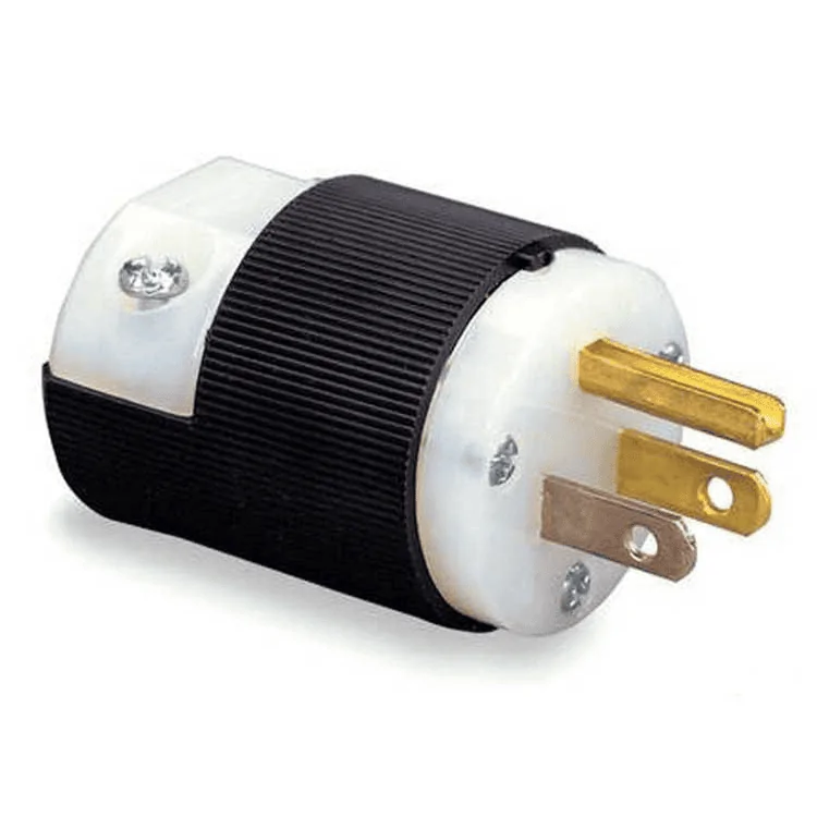

My $0.02 and I am not an electrician but I play one on TV.
A 12/3 extension cord is just fine. If you buy a 10 gauge cord, you are paying extra money for ampacity (30 amps) that will never be used or needed. The Edison connectors are rated for 20 amps at best but more often they are only 15 amps (hospital grade are the only ones I've seen that are 20 amps) and will fail long before that cord is ever loaded close to capacity. The outlet that you are likely to plug into is also going to be only 15 amps though outdoor GFCI circuits can often be 20 amps. The Rivian travel charger only draws 12 amps when plugged into 120 volts. At that draw, the Home Depot cords mentioned above are technically fine. They are 14/3 and rated for 15 amps but that said, I would not use them unless I had no other choice.
I would recommend getting some nice 12/3 SJOOW (which Home Depot actually sells by the foot) and some high quality connectors, and making your own high quality extension cord. I am fond of the Hubbell style connectors (sometimes Home Depot has these as well):
Rivian R1T R1S Extension Cable for 110V charging 1681576456838
For the record, I literally own hundreds of this style of extension cord. They can also be purchased pre-built online. You can find them at sites that cater to motion picture or live event production. Heck... I've got some for sale. Here's an example. Or Google "12/3 Stinger". You'll end up with a high quality cord that is reliable and supple. That 10/3 cord linked above looks like it would take a half hour to coil up. These are easy to deal with.
Edit: Oh! But never wrap it around your elbow. Take care of it and it will take care of you.
