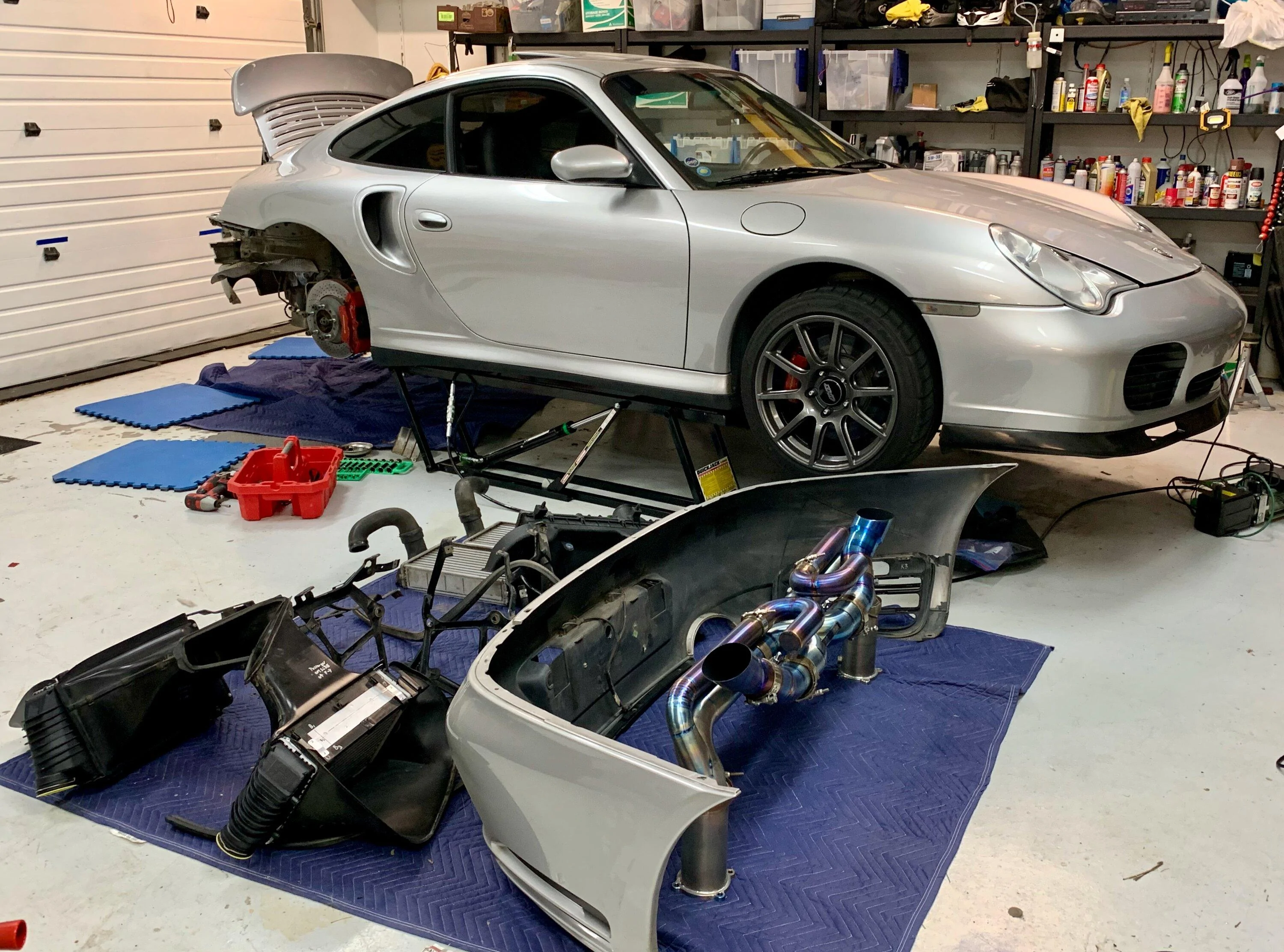

Maybe this is naive, but couldn't you just turn the jacks sideways (perpendicular to the vehicle)? With a flat bottom plus the jack pads, I assume clearance wouldn't be an issue.
(I am very obviously not an engineer.)
Yes, weight issues aside, the quickjacks are 'approved' for use sideways.
I use my quickjacks all the time with my 911's. They are great, particularly if you don't have the room or desire for a two or four post lift. I've also used them sideways for lifting friends cars that don't have close enough lift point spacing, as well as some Ferrari's which have very odd lifting points that are not in line front to rear.
Mine are the 5,000 pound version, so I won't be lifting the Rivian with them, but I personally would have zero concerns lifting a 7,100 pound R1T with a 7,000 pound rated quickjack!
Rivian R1T R1S EV Sportline Jack Pad Puck 996 quickjacks exhaust unobtanium apart - 1

pfbz
Jun 13, 2022
100
129
US
R1T (ordered), F150, Q5, 911 Turbo(s)
If it does 7000 you should be fine. You’re never jacking all the weight of the vehicle. The weight is always distributed to the ground by other wheels or other jack stands.
Actually that is *exactly* what the quickjacks do... Lift the entire vehicle. But still, I personally wouldn't have any issues with being 2% over over the QJ7000 nominal weight rating.
Beautiful turbo 996! Lucky bastard...
