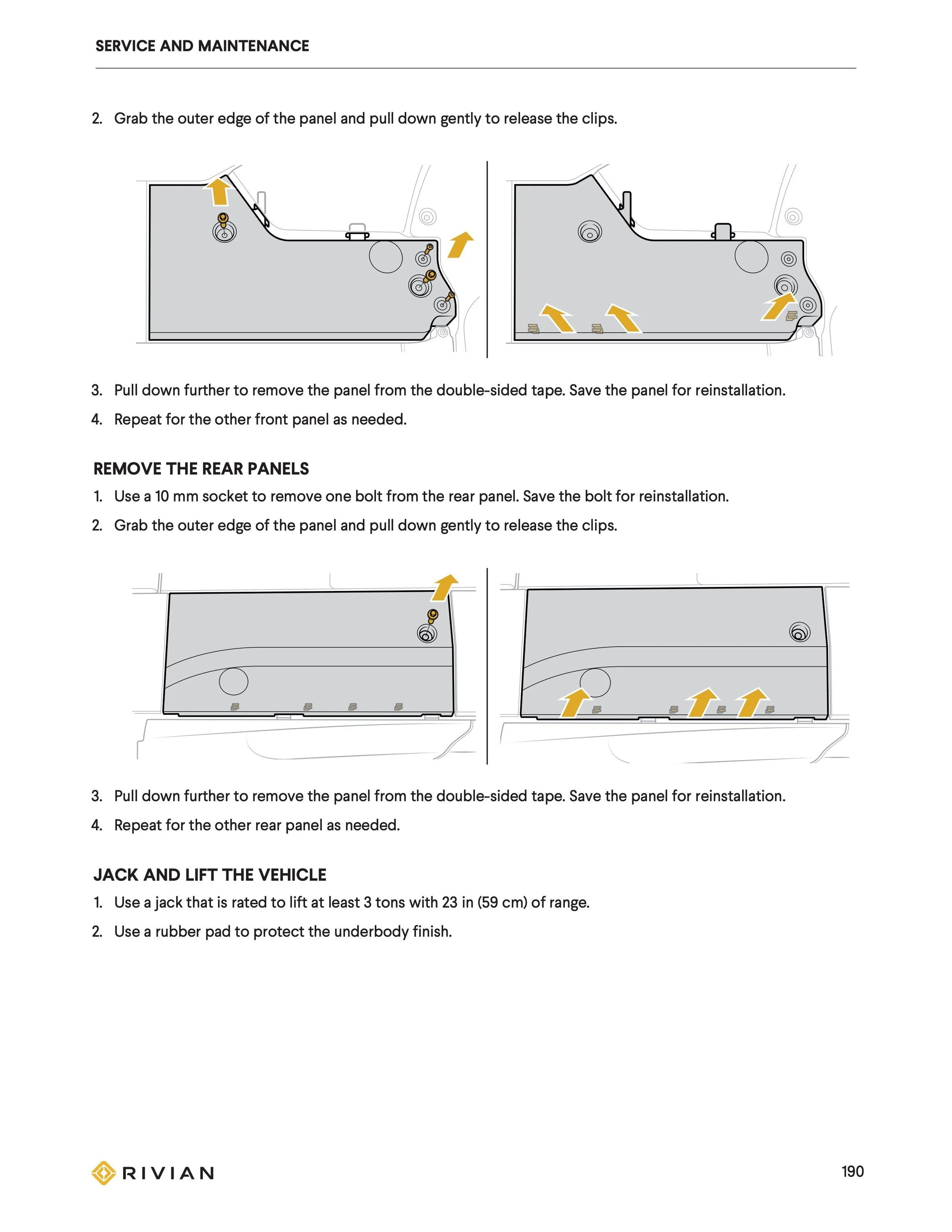

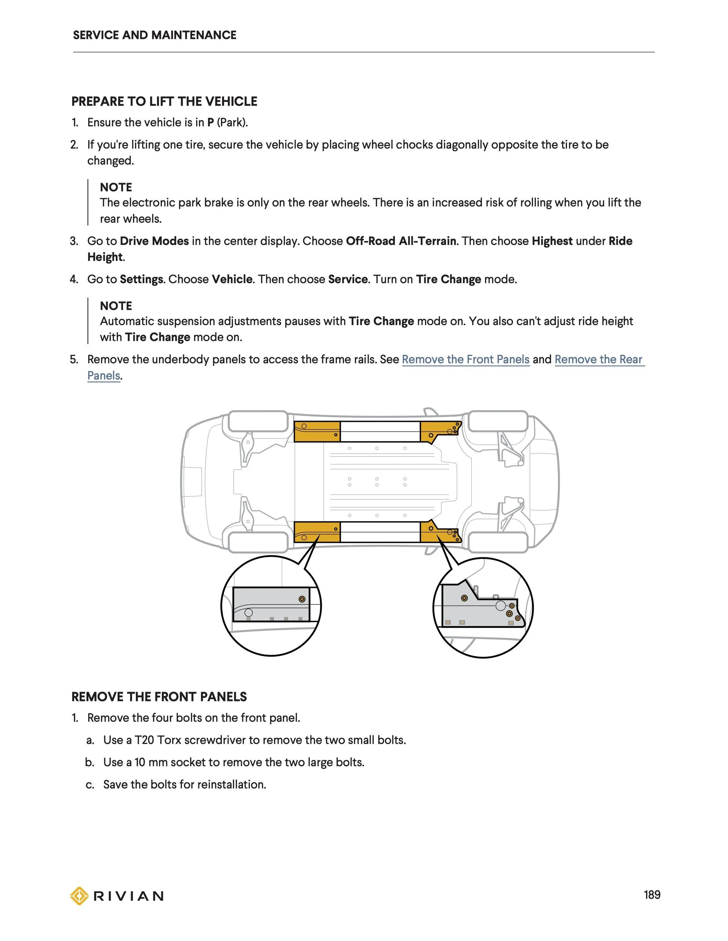

There are four small aero panels/covers that are designed to be removed when lifting the entire vehicle. They are fairly easily removed, but you will need a Torx T20 and 10mm to remove them.
Something like that lifting puck is designed for using a small portable jack and lifting a single corner, and not even needed for that. Seems a lot simpler to carry a T20 screwdriver and a compact 10mm tool than a fairly big and heavy $50 'lifting puck' (let alone *four* of them!!)
Rivian R1T R1S EV Sportline Jack Pad Puck rivian lifting excerpt  1
Rivian R1T R1S EV Sportline Jack Pad Puck rivian lifting excerpt  2

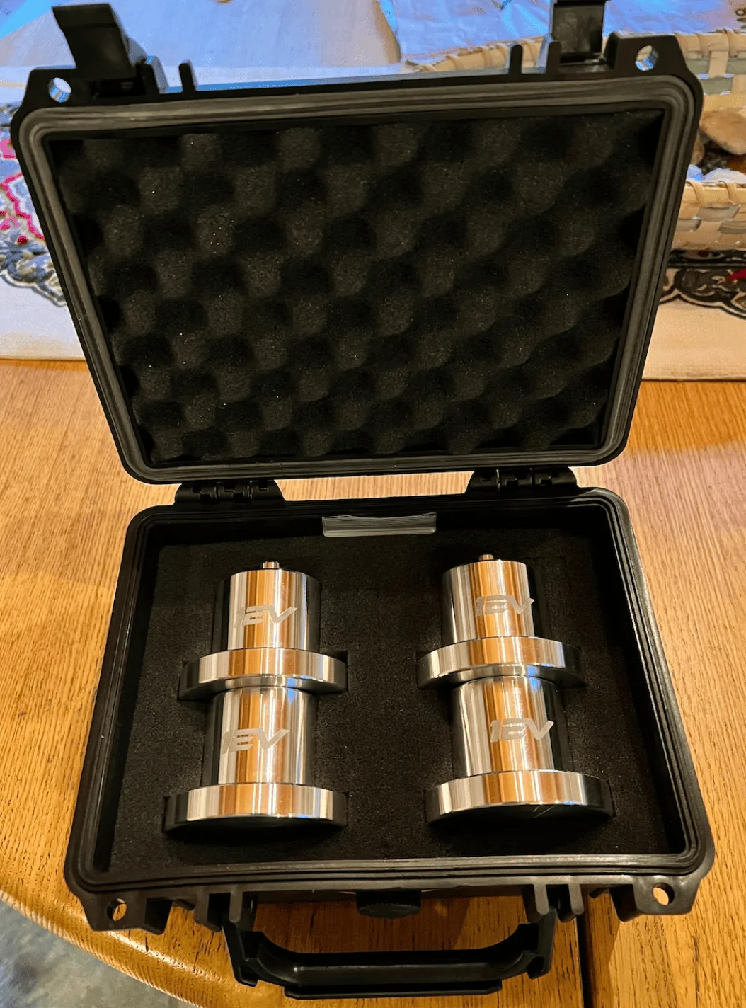

They are aluminum, I would not really call them heavy in the scheme of things. They fit pretty nicely in an inexpensive small case that easily fits in the rear underseat storage area. I would rather use a set of them than take off those access panels every time lifting the vehicle is needed. Photo courtesy of RS.
