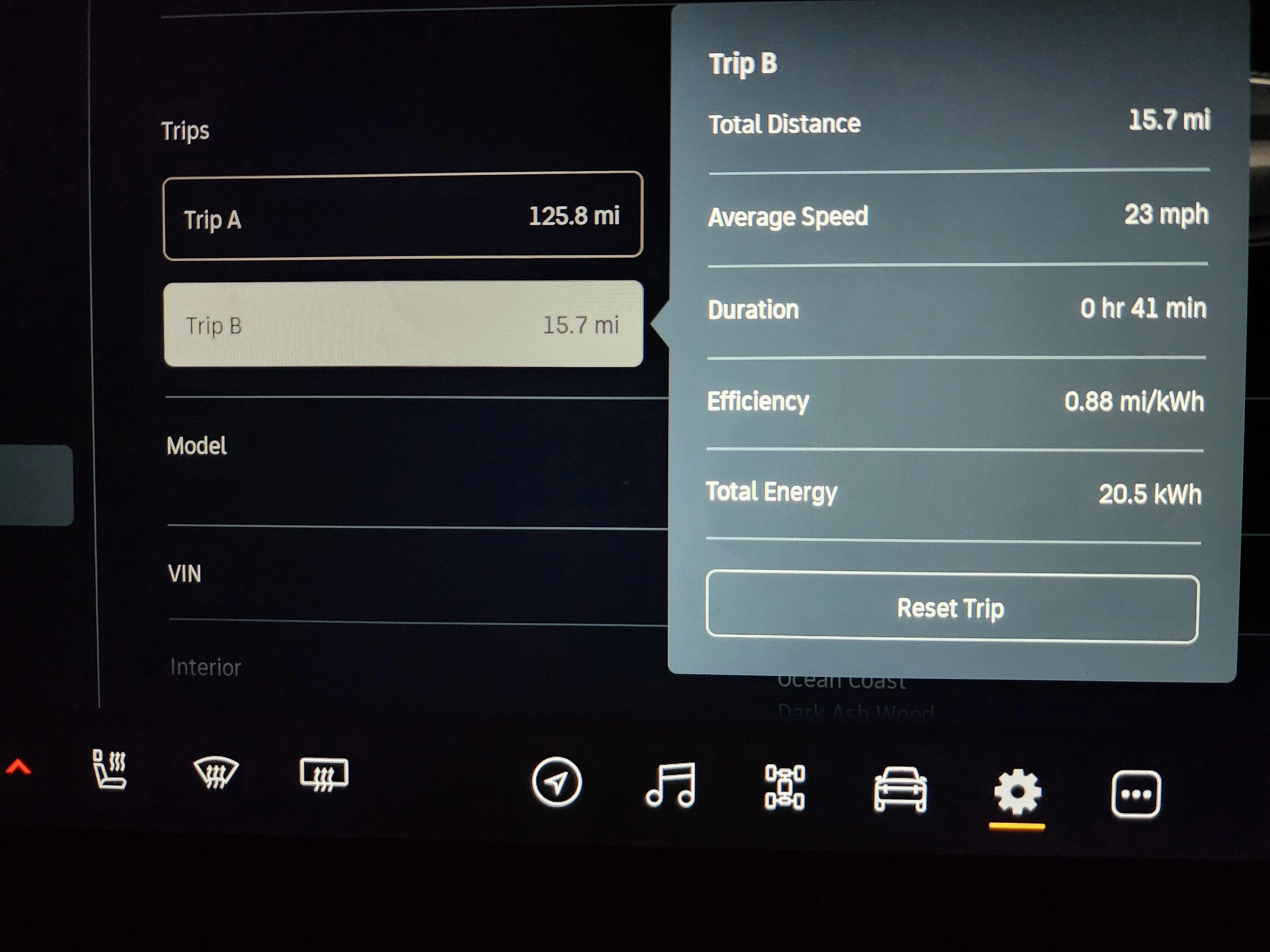

I recently got my R1S with 21" wheels. I did a test drive today in All Purpose mode to check the efficiency. Didnt accelerate hard the entire trip and it was all on local roads in 70F weather. Surprised at how bad the efficiency was at 0.88mi/kwh. Also, if you do the math on the distance I traveled divided by energy used it comes out to 0.76mi/kwh. Any reason why the efficiency is so low and the difference in the Calc?
i run 21s with running boards on R1T. ~7500 miles. Avg 2.3-2.4 mi/KwH. 99.9% all purpose mode. Driving patterns matter ( hard accelerations). Nothing kills efficiency more than standing still in drive( traffic, drive through at Starbucks, etc).

Thanks for all the answers. I'll reset and try again on a longer drive to see whether this is persistent.
I'm thinking the efficiency hit may be because the car was also sitting in the garage for three days and lost about 10% battery. Maybe that was included in the mi/kwh Calc.

It usually starts out pretty bad, like <2 mi/kwh for the first 5 minutes of driving. I suspected this was due to the battery needing to warm up. Work commute is about 6.2 miles each way (in town), i get about 2.5-2.6mi/kwh. On longer trips, about 20-30 mi each way(mixed freeway ~70-75mph and some in town driving <50mph), i get 2.75-3+ mi/kwh AP mode. 3+ mi/kwh is pretty easy if i drive in conserve. I live in Houston, so AC on the coldest setting and sometimes the seat coolers running.
The trip readings will never be accurate over the course of a day b/c the vampire drain will throw off the mi/kwh efficiency. Since my work commute is so short, I may only use about 5 kwh/day total for driving, but the vampire drain adds another ~1.0-1.2 kwh on the trip meter so the next day my 2.5-2.6mi/kwh drops to 2.0-2.1. When i'm in the office, it consumes about 400wh while parked over an 8 hr period and ~15-20 gg recordings.
