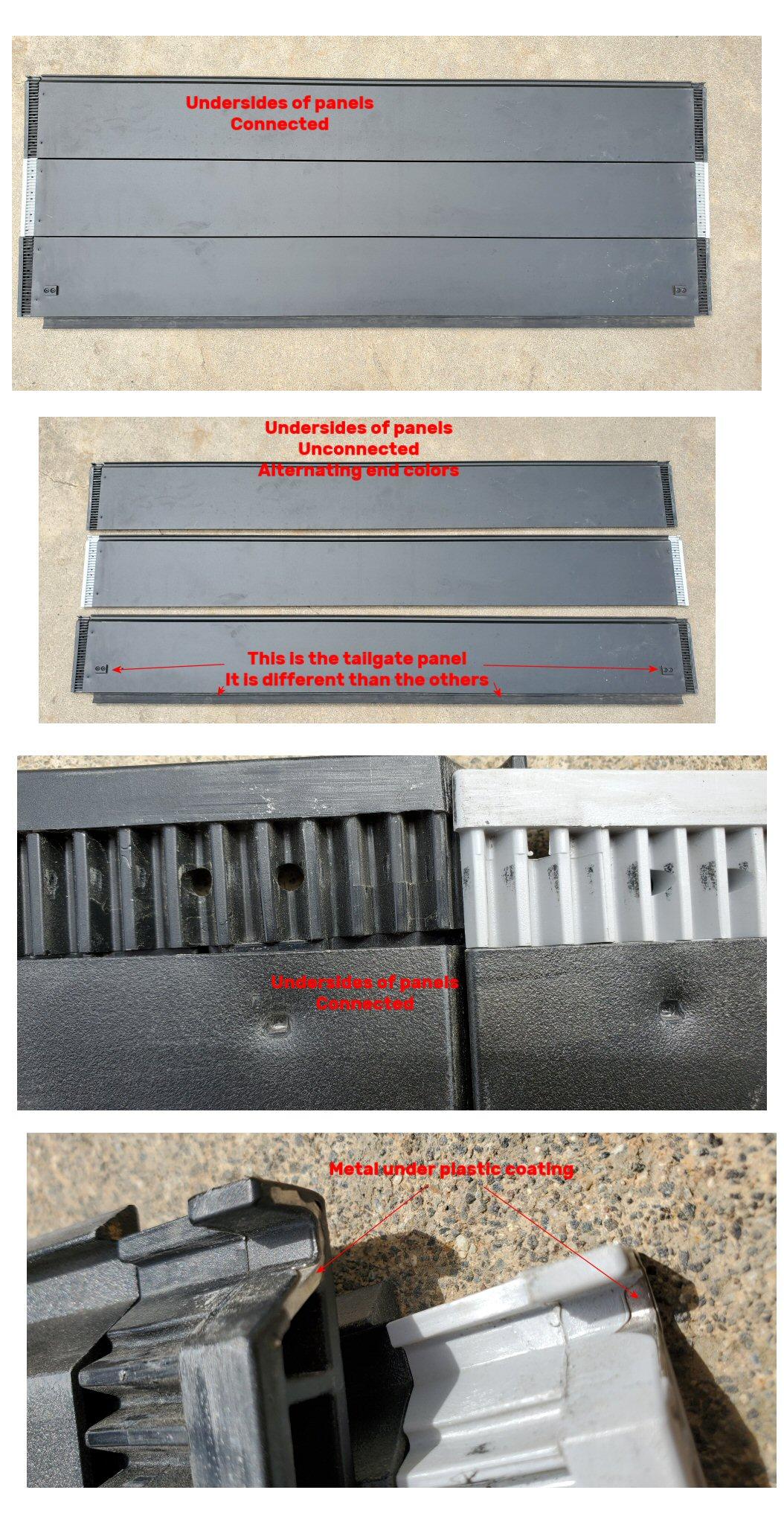

Here's a few photos of the undersides of the tonneau panels to help you understand more about how these work. The edge-teeth on the panels are metal with a plastic coating, so seem fairly substantial.
I'm not sure why there are exposed areas of metal on the edges (last photo). I didn't scratch the coating off...they were that way when we pulled them out of the railings. Either they chipped off during use or were that way when installed.
And, I should mention, I didn't notice any chipping of the plastic coating on the panel teeth shown in these photos. Didn't get a chance to inspect all the panels in the set that remained in the box stack, however.

Certainly looks like the design is destined to fail based on the wear patterns. Materials aren't durable enough to hold up against any grit destined to get in, and side to side tolerances might also be an issue based on the wear to the "panel end caps with the rack gear teeth. Finally, the end caps are being pulled out of the panel when they get tweaked. Once this happens it will certainly continue to bind up and stop moving.

Interesting, do all of the slats alternate white/black like that?
the coating that isn’t completely covering things is probably to reduce friction on the sliding parts and gear teeth.
