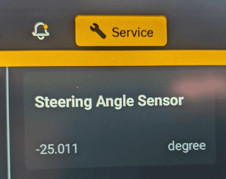

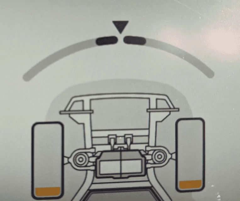

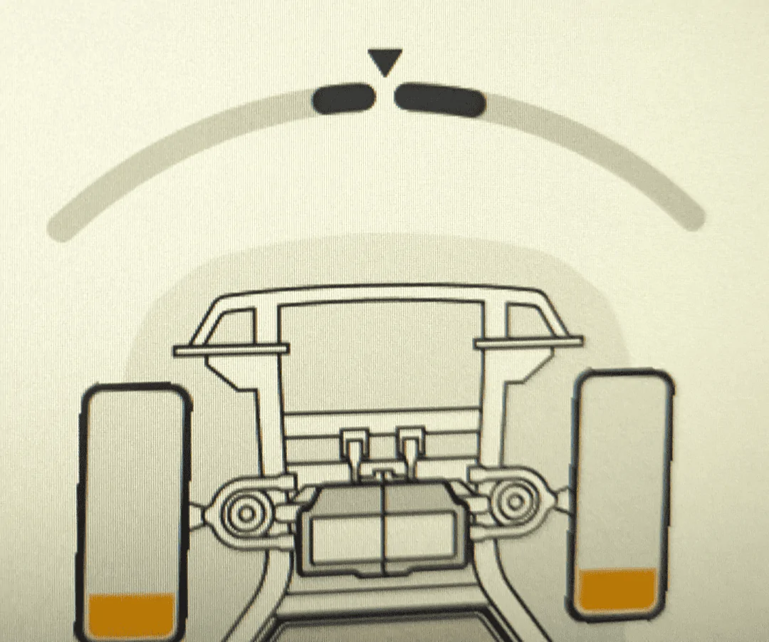

Watch this display next time it slows in a curve. I bet if you maintain speed instead of letting it slow, the little triangle gets small, meaning "too much turn, boss!" It occurs between 24-25°.
Rivian R1T R1S Cruise control slowdown in curves 1000011690
Rivian R1T R1S Cruise control slowdown in curves 1000011685
Rivian R1T R1S Cruise control slowdown in curves 1000011691
To all of the other curious folks on this or any other "Rivian problem," investigate the "problem" yourself and offer up your results to the group. It doesn't have to be a rigorous defensible dissertation, just give it the ol' college try before whining, you're very capable. Half of us are grease monkeys, half of us are computer-y nerds, and the rest fall somewhere in between (don't check my math, I work for the government).
