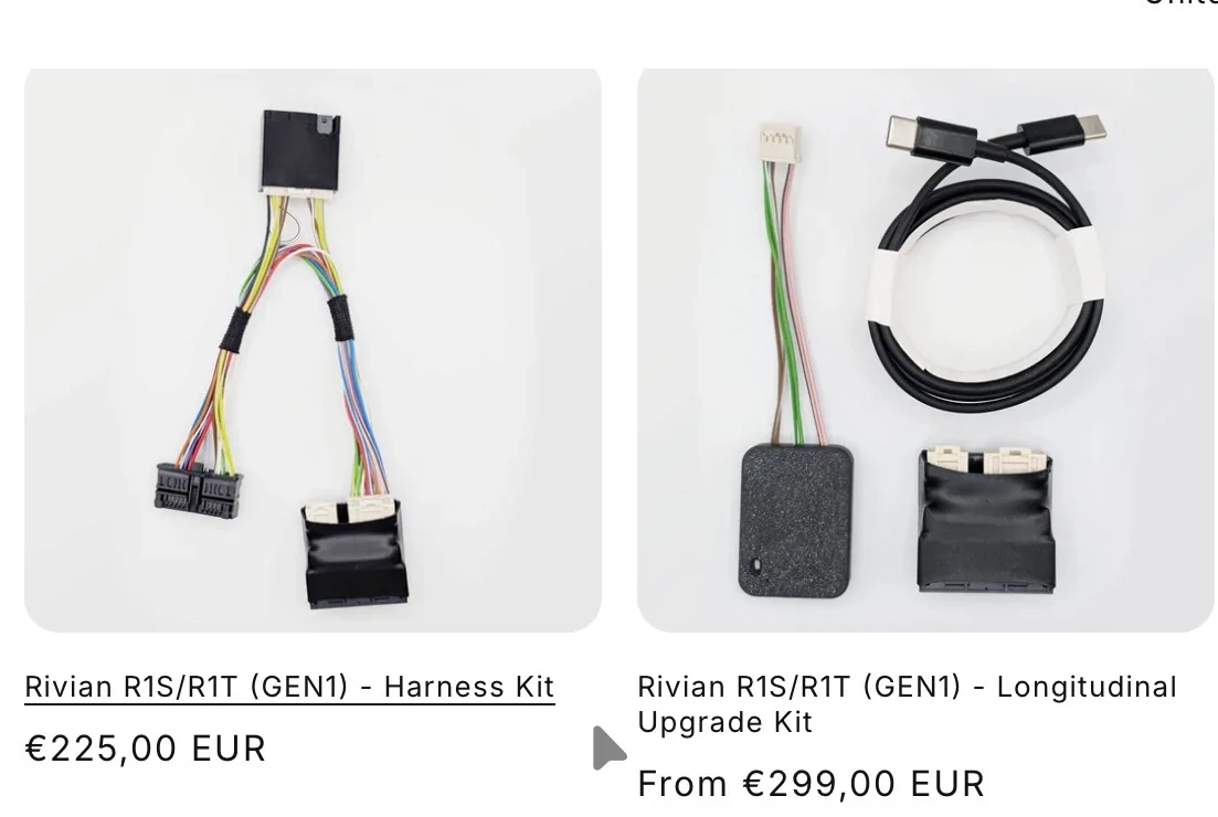

Still investigating all the Comma 4 options. In order to get maximum functionality, is it necessary to acquire both the Xnor harness and the longitudinal upgrade? Or, does the Xnor longitudinal upgrade kit use the Comma harness that comes with the Comma 4. I’m guessing the Longitudinal upgrade kit is all that is needed. Jeez, at over $300, plus whatever it takes to get it delivered, we’re starting to talk real money.
Plus there's gonna be the tarrifs on top of that. 🤮
If you already have the harness from Comma, you don't need to get the harness kit from xnor. They're basically the same thing - the harness from xnor just has the AXM power connection removed (which we also recommend doing with the Comma harness).
Just make sure you order the correct version of the upgrade kit for the type of harness you have (Comma or Xnor).

@Singletracker You also can add the longitudinal kit at a later time, doesn't have to be done all at once. With just the main harness, the comma can control lateral (steering) while the Rivian handles the longitudinal (speed) thru adaptive cruise - or with Sunnypilot you can utilize mads mode and control longitudinal thru 1 pedal driving all the way down to a stop. The other thing you lose is automatic lane changes with use of the blind spot monitors. You can still do them, but you need to check your blind spot!

Thanks, Gerry. So, the upgrade kit will be a $400-$500 item 😧
I saw someone posted about this on Discord, with currency conversion and tariffs it over $500!

Just checked by Xnor order from back in July. Both harnesses + fuse tap = €457,98, or about $600 delivered. I bought my 3X during the July 4th sale, so roughly $1,400 all in.
