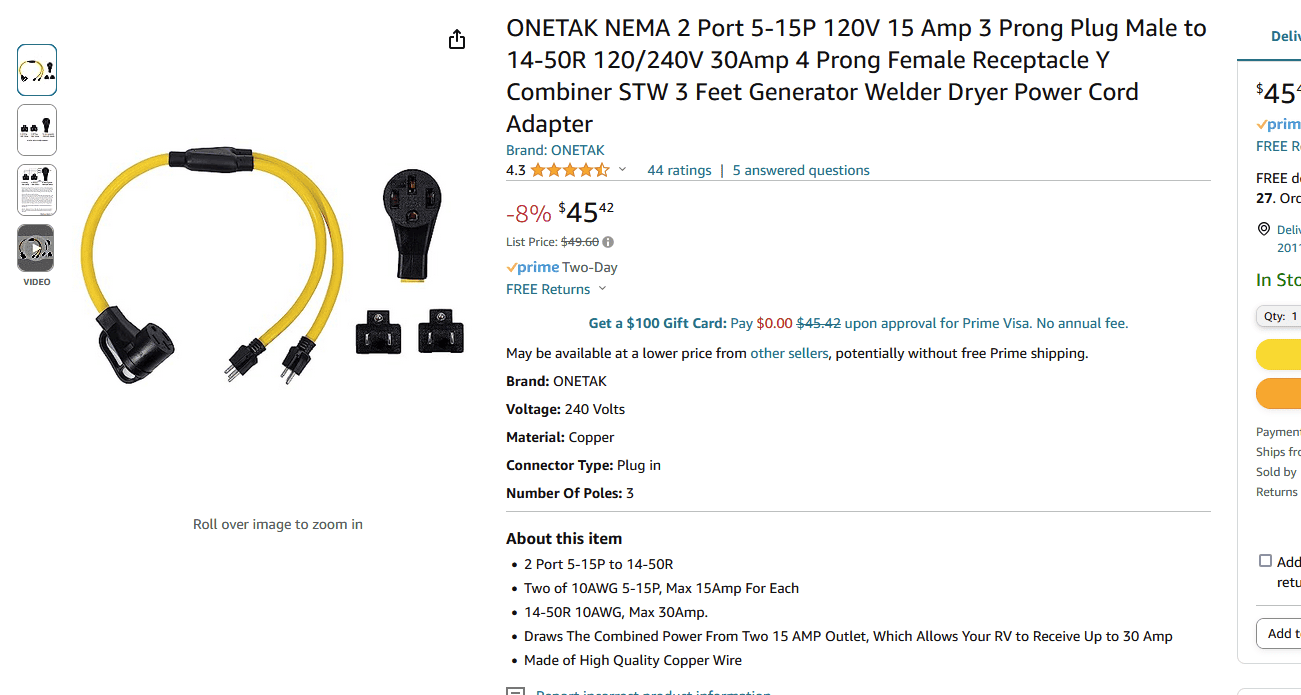

My dryer breaker is 30 amps. And the adapter supplied by Rivian doesn’t fit in …
would such an adapter work. And if so. Where do I get one? My wall charger won’t be installed for a month or so
thanks in advance and didn’t mean to hijacke the thread.
Yes, we had to do the same before we got our Wall Charger installed. This is the adapter we got (your plug might be different):
https://www.amazon.com/gp/product/B07K2FHT23/ref=ppx_yo_dt_b_asin_title_o08_s00?ie=UTF8&th=1
Just make sure not to use the dryer when you're charging (and limit the draw to 24 amps).

That is exactly what I wanted to hear....
You say Limit the draw to 24 amps... do I have control of that somewhere??
Thank you !!!
Yes, you can control that in the Rivian App or on the charging screen in the car. If you want to limit your charging to 24amps all the time until you get your EVSE installed, you'll need to set a charging schedule (Daily, from 12am-12am, at 24 amps). Otherwise, the car will reset to 32 amps next time you plug in. This might be confusing now, but it's very intuitive once you actually have the car.

Look into a nema 6-20 install. Depending on if you ha e a dedicated circuit/plug, you can convert a 120v to 240 using existing wiring.
Of course it's still limited to a 16amp at 240v, but better than nothing.

Identify the the dryer outlet
checkwire size to breaker
adapters on line or Home Depot
set Rivian charge session to 80% max breaker rate
