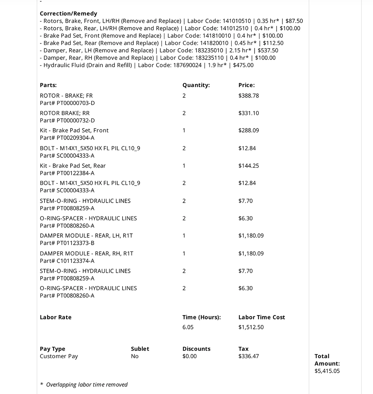

I had took my R1T to the Service Center and had them do a comprehensive check. They said that all four brake pads, rotors and rear dampers had to be replaced. The truck has 89,000 miles on it and had the brake pads replaced in June of 2024 because they were wearing unevenly. Is it normal that this much of the brake system has to be replaced at a cost of $5400? Most mechanics that I spoke with thought this was rather unusual. We were thinking about trading upgrading to a newer R1T, R1S or R2 but the cost of ownership of these vehicles has us reconsidering an upgrade.

Normal for premium priced cars that you pay someone else to work on. Brake job on my previous car, '13 BMW X5 Diesel, was even more. If you don't believe me, pick a similarly price car and look up OE brake pad and rotor costs on rockauto.com.
Plus, your invoice isn't just for brakes. Looks like the most expensive parts are new rear shocks and hydraulic lines.

For reference, replacing a rear air damper on my Model S back in 2022 was $1800. I've seen Model S brake prices quoted at twice what Rivian wants, but that's still too high for something so simple. $400/labor and $1152 for parts. You can find a set of ceramic pads and coated rotors for $370 all in and do them yourself. They probably need to be replaced only because the pins and pad edges weren't greased properly during installation. My first Model S needed brakes at 50k for the same reason.
The dampers are super expensive and probably not user serviceable since you can't bleed the hydraulic lines yourself. This is a big pain point for R1.

The dampers are definitely the largest part of the cost, no doubt. It doesn't seem overly expensive compared to what we have seen before or from other higher-end brands. And FWIW, no saleable R1s were hand-built. There may have been more manual validation, but it was in no way hand-built.

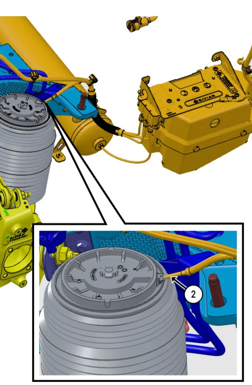

Bleeding and pressurizing the hydraulics is doable diy once you understand how it works. Did jounce lines at home, bled and refilled without issue.
The harder part is depressurizing the air bags since it's not easy to reach the valves and always risky loosening the fitting under pressure.
Edit: looks like air bag might not be too hard if you loosen the fitting near the air pump

That's good to know, I figured this would require the service menu to cycle things.

I wonder why one damper takes 5 times longer to remove than the other damper?

Short answer: Yes, this is normal.
Long answer: For what you got done I think you got a pretty good deal. As someone above noted, if you've ever owned a Mercedes, BMW or other equivalent 'luxury' car you're used to $800 brake jobs and $1500 shocks.
Like someone else said though - dealer pricing is based on willingness to pay, not cost of parts. If you shop your own parts you'll get a much better deal, then you just need to find a mechanic crazy enough to work on your truck!

It's the suspension, $4k to replace 2 dampers, top of the line technology you probably don't want to screw with.
