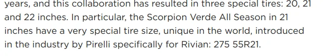

The 21ā€ size is unique to the Rivian. There is only 1 supplier with pirelli. The 20ā€ size is very common and the 22ā€ size is used on current generation gm pickups and suvs.
Rare, not unique.

Rare, not unique.
Pirelli has stated otherwise. And as far as I know, it is still a size that is unique to Rivian and manufactured only by Pirelli unless someone else has brought another tire to market in this size in the last 12 months.

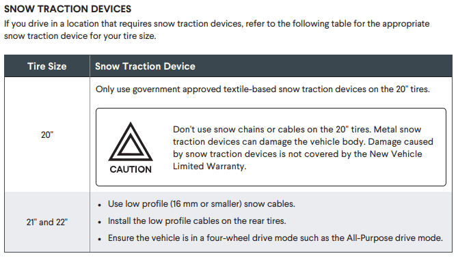

This makes me wonder if the R1T will accept tire chains. I don't recall it was stated one way or the other in the owners manual.
From latest version of R1T Owners Manual:
"Modern-day vehicles with 21-inch tires include the Lexus LC 500, Tesla Model S, BMW X5 and X7, Porsche 992, Volkswagen Atlas Cross Sport, Audi e-Tron, Lincoln Aviator Grand Touring and Range Rover. "
https://www.bridgestonetire.com/size/21-inch/
Nobody is saying that a 21" tire is unique. The statement is that a 275/55R21 (the 21" fitment for Rivian) is currently a unique size. It is not OE fitment for anything other than Rivian and only Pirelli makes that specific size.
