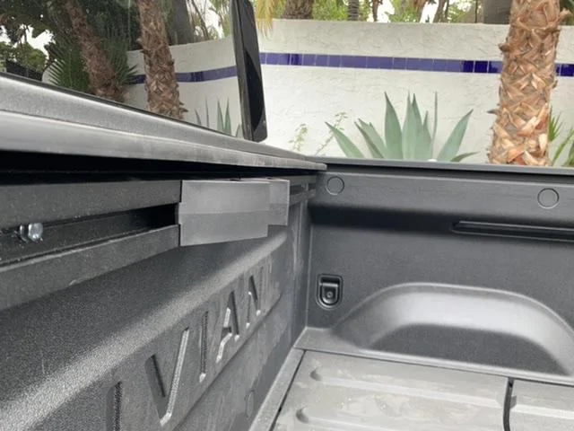

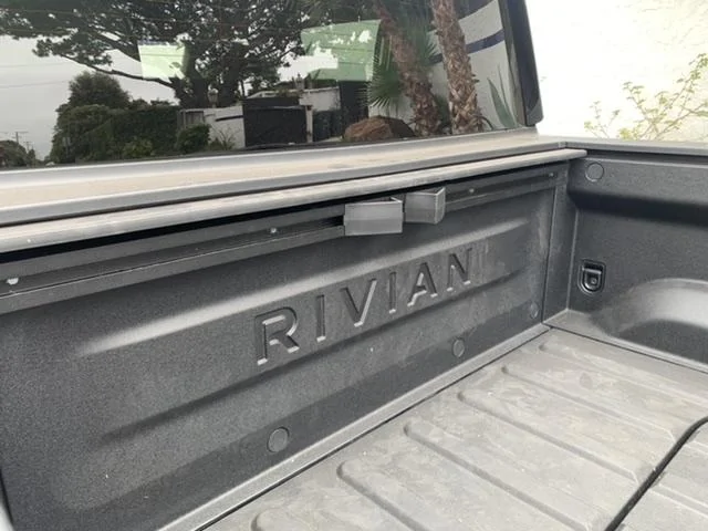

I found this one. Seems like the top lip is angled down and might clear the tonneau coverThere's not many chock choices that I found as the L track sits so high.

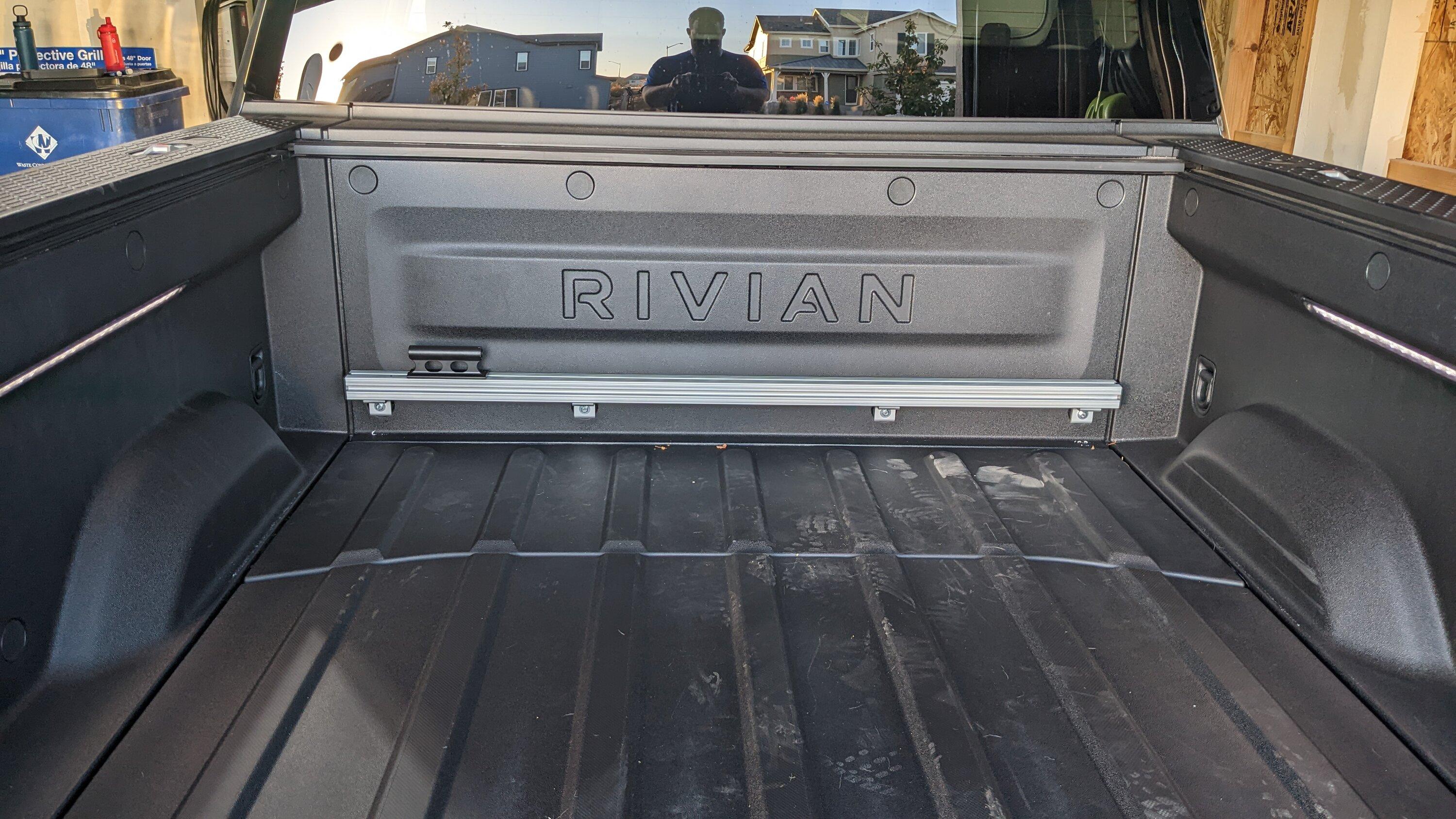

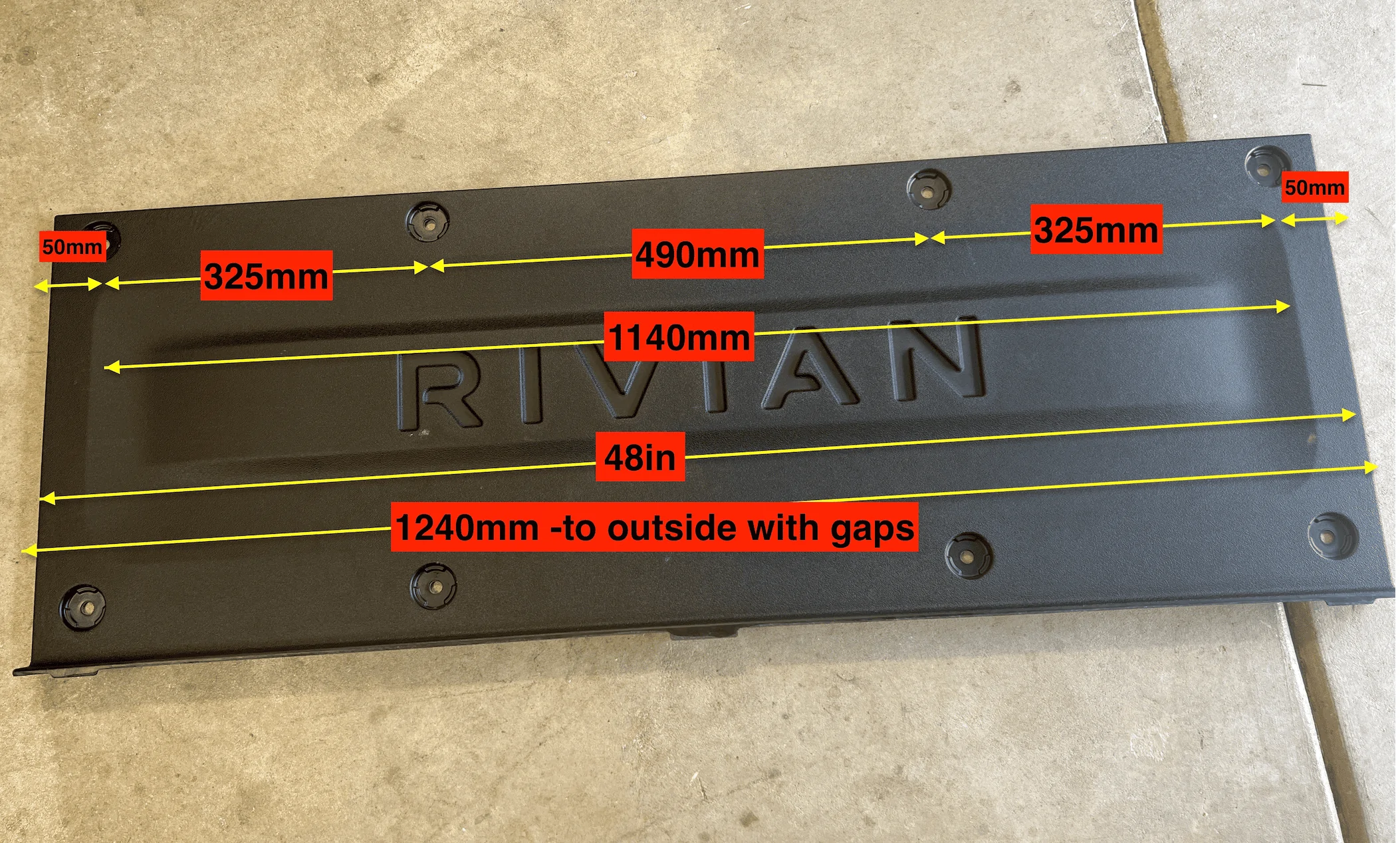

I'm about to do this as well. I checked for 48" standard L Track, there are 10 mounting points, each are 5inch apart. The bed mount points are 325mm and 490mm away from each other, which is not really a multiply of 5inch? I counted the holes in your picture and there are more than 10 points? Did you have to drill the L track too?Here's what I measured for the bed wall
Yes, you'll need to drill holes in the L track. The 5" spacing is not compatible with the Rivian holes except for one hole at the end of the 48" L track. I also had to countersink the newly drilled holes.I'm about to do this as well. I checked for 48" standard L Track, there are 10 mounting points, each are 5inch apart. The bed mount points are 325mm and 490mm away from each other, which is not really a multiply of 5inch? I counted the holes in your picture and there are more than 10 points? Did you have to drill the L track too?

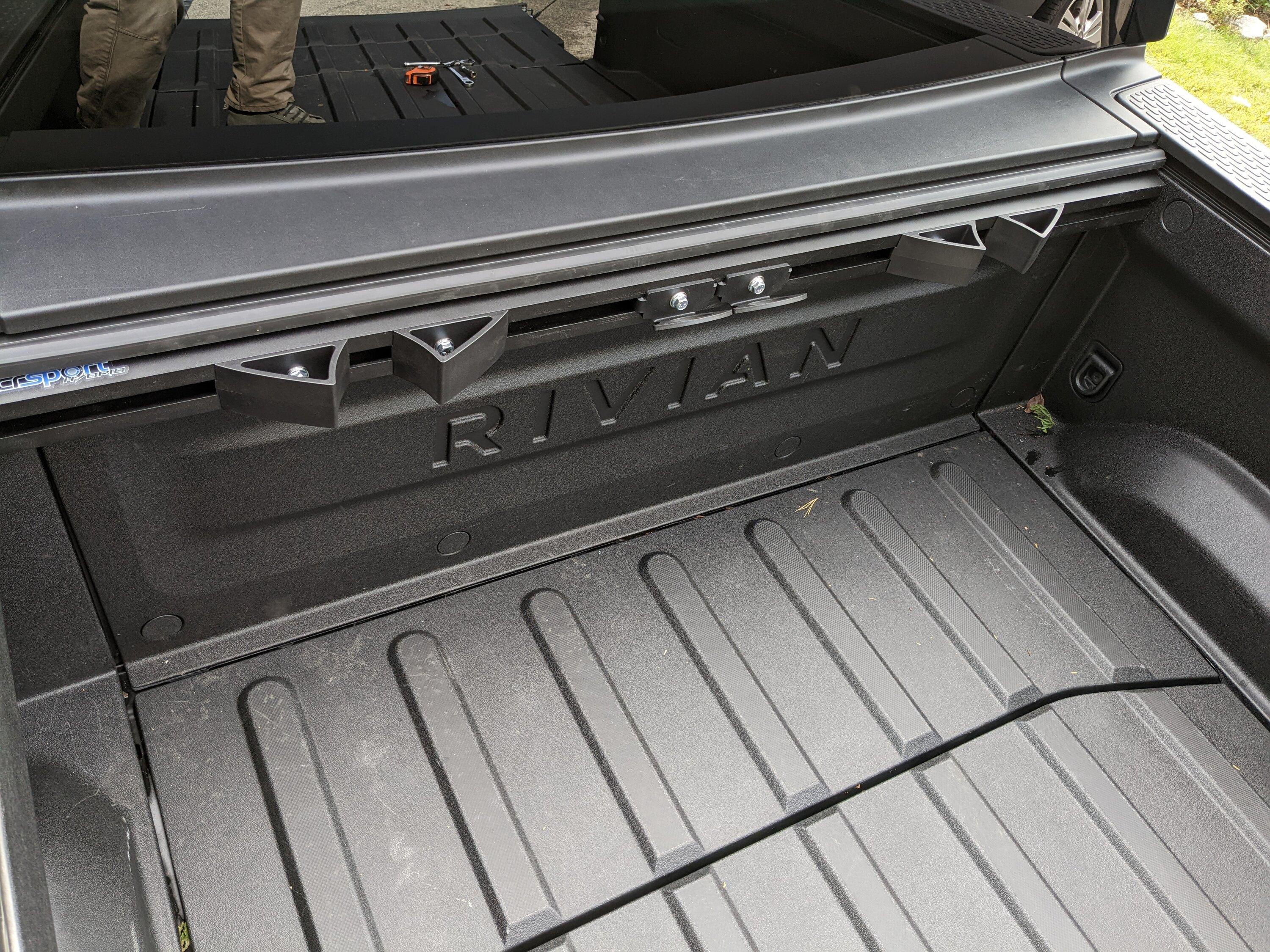

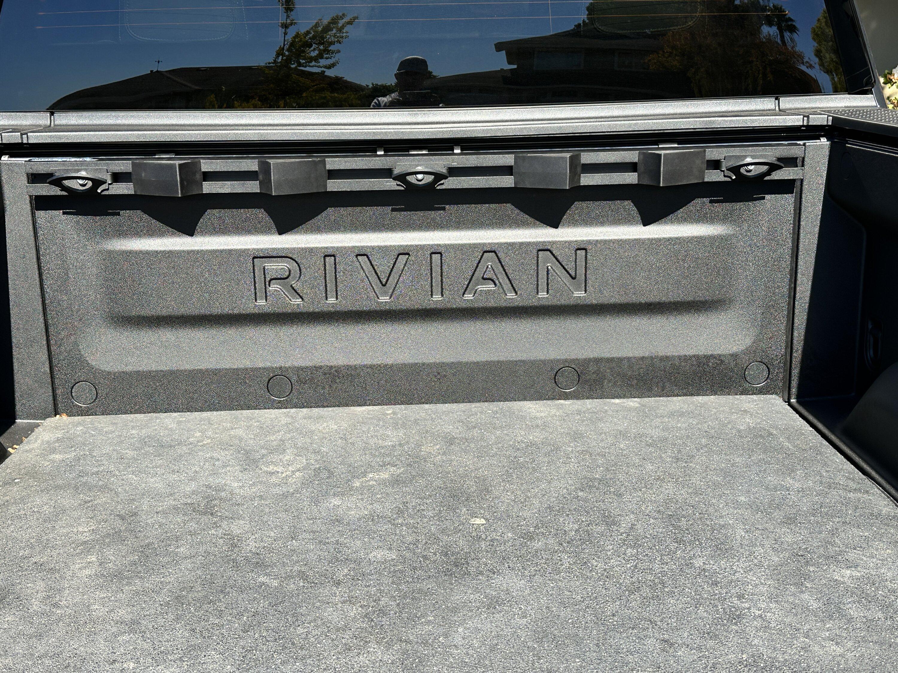

Thanks for posting this, I wouldn't have known about the CCR System otherwise but after seeing your setup I ordered and installed one as well. I'm very happy with it, it's nicely made, installed easily enough and looks so good that people who see it assume that it's a factory option with the truck.Here is my setup. Went with a CCR hybrid system . . .

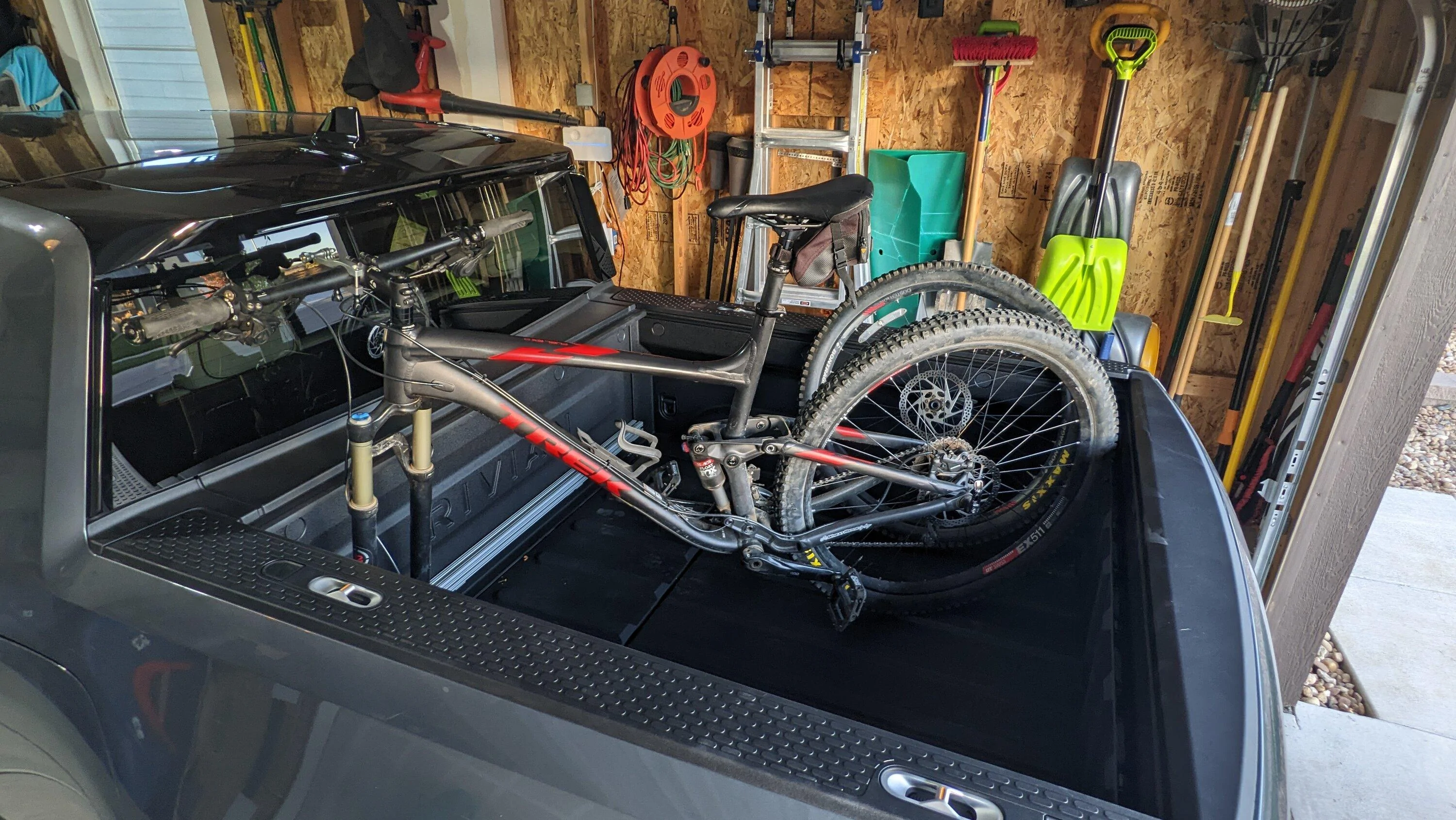

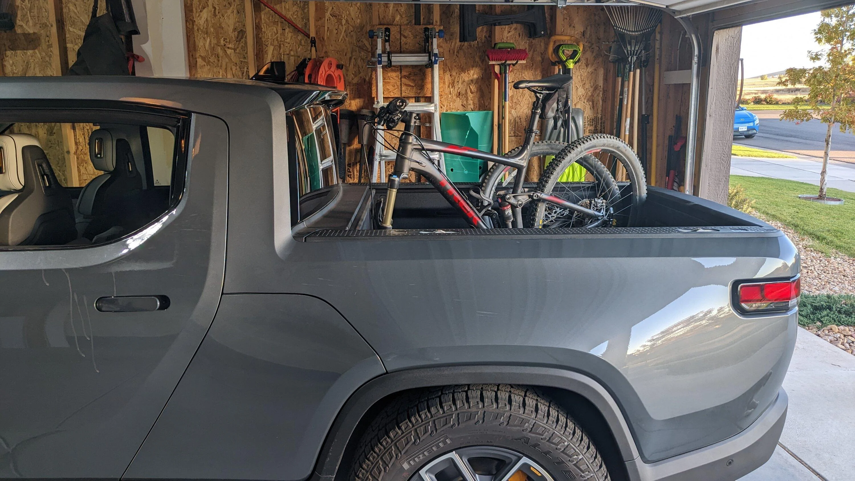

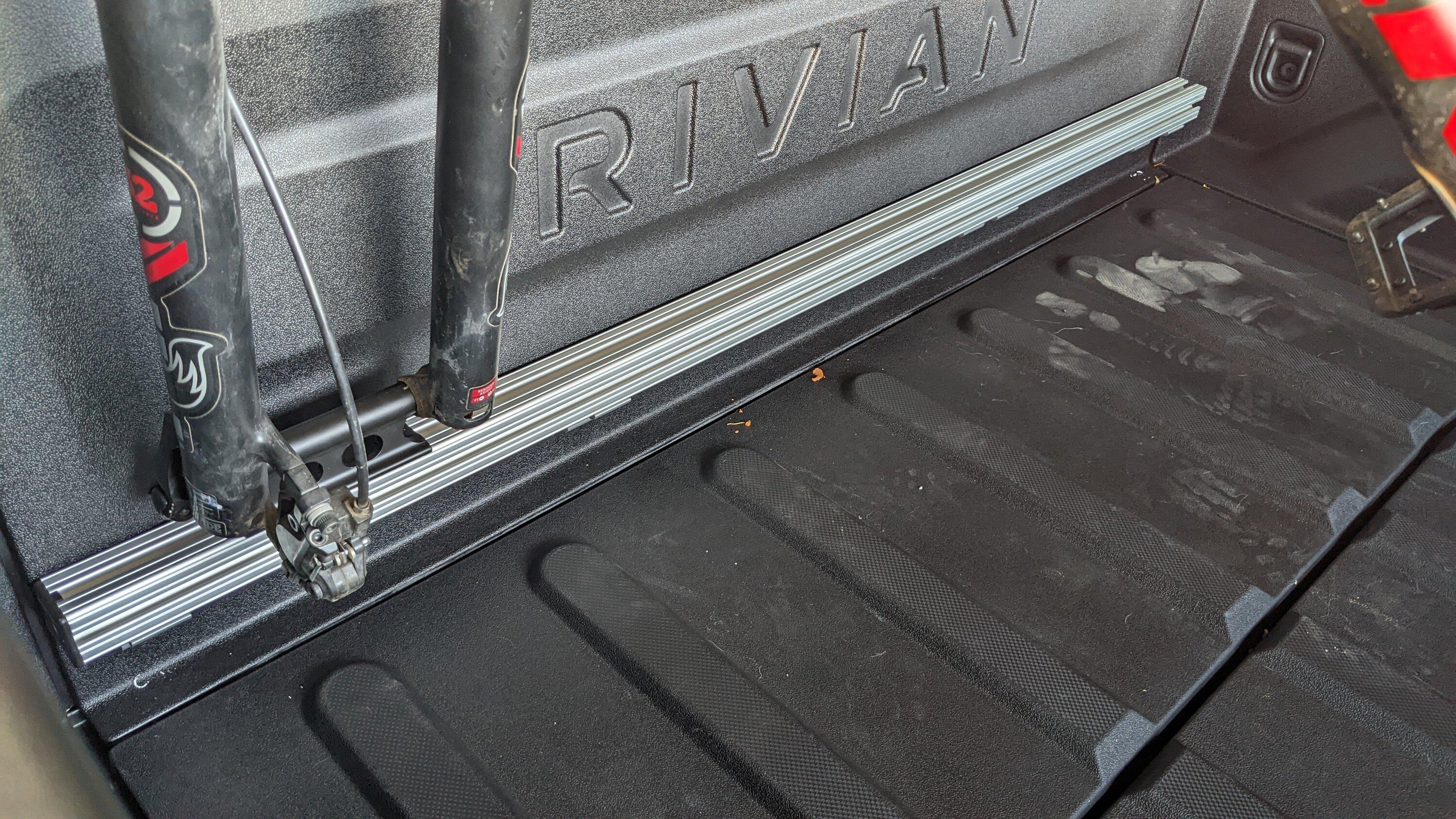

I will be doing something like this for my mtb. However, I will be flipping it around, so that the fork mount can be easily accessed from the tailgate area.Installed a DIY bedrail using some T-slot extrusion to make a fork mount bike rack. It fits my XL frame 29er MTB if I angle it a bit, with the tail gate closed even. Used a simple fork mount. Just need to come up with a clever way to secure the front wheel in transit so I don't have to store it in the cab. I used the existing lower bed fasteners, so it's fully reversible if I ever want to take it out, but low profile enough to always leave in the bed. I like that it keeps my bike low in the bed so I can pull into the garage and keeps the bike mostly out of the air stream while driving.
Bonus, the extrusion gives me a flexible option to add additional tie downs or other mounts as needed.
Is that a Stepramp? All of those upper bolts are just into the panel holding the tonneau cover correct? Nothing structural?Thanks for posting this, I wouldn't have known about the CCR System otherwise but after seeing your setup I ordered and installed one as well. I'm very happy with it, it's nicely made, installed easily enough and looks so good that people who see it assume that it's a factory option with the truck.
Yeah, it's a step ramp which is great, very highly recommended!Is that a Stepramp? All of those upper bolts are just into the panel holding the tonneau cover correct? Nothing structural?
