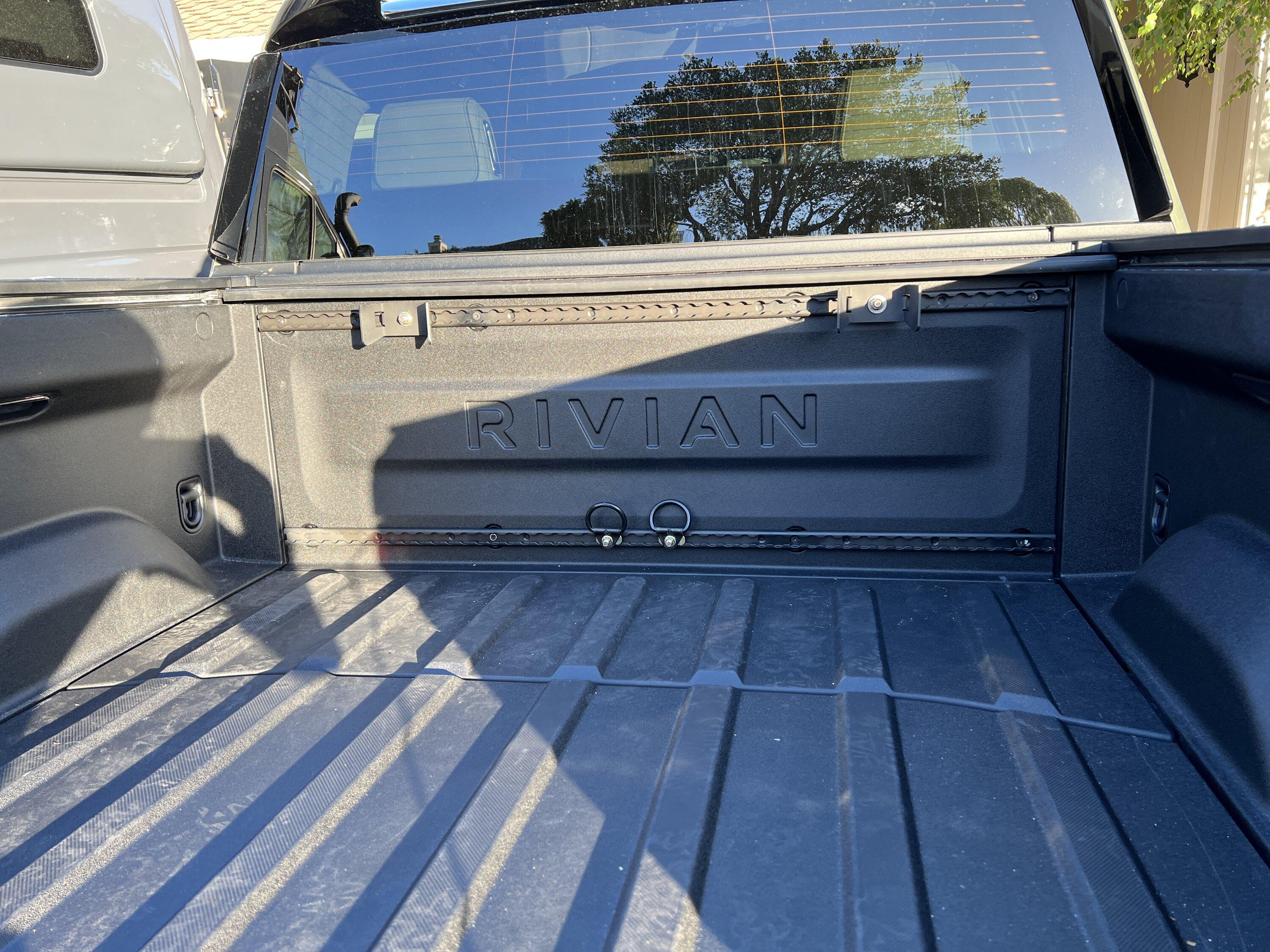

I’ll post my L track (airline track) pics and solution next week. Two 48” pieces of L track on the front bed wall and two other ones on the side of the bed. All screwed into the metal bed behind the plastic cover using existing holes.

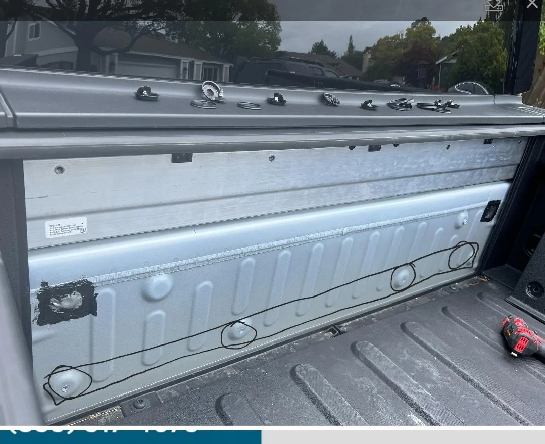

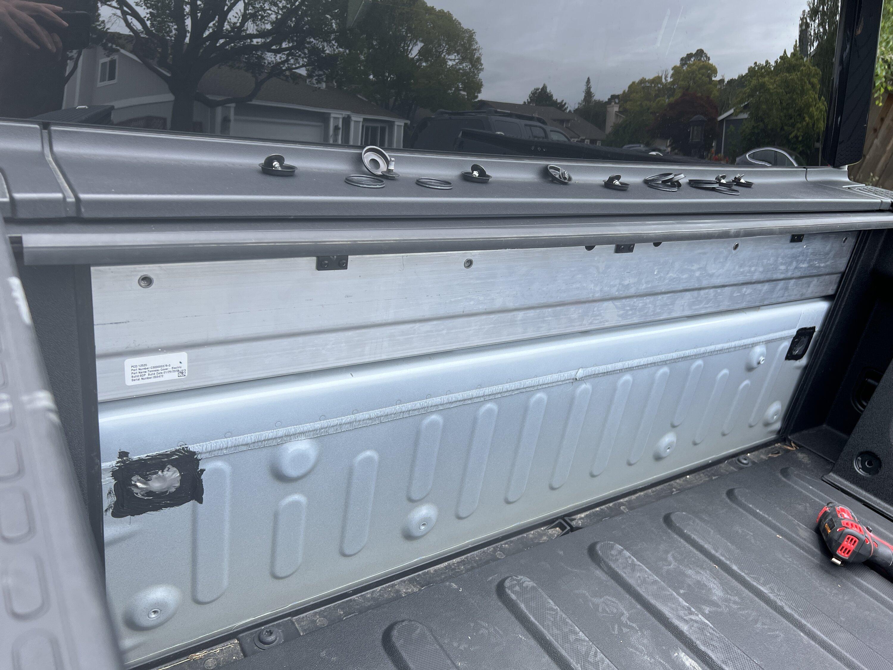

Take lots of pics of the disassembly / attachment points please!

Some 8020 bolted through the liner to the factory bolts here would work pretty well....

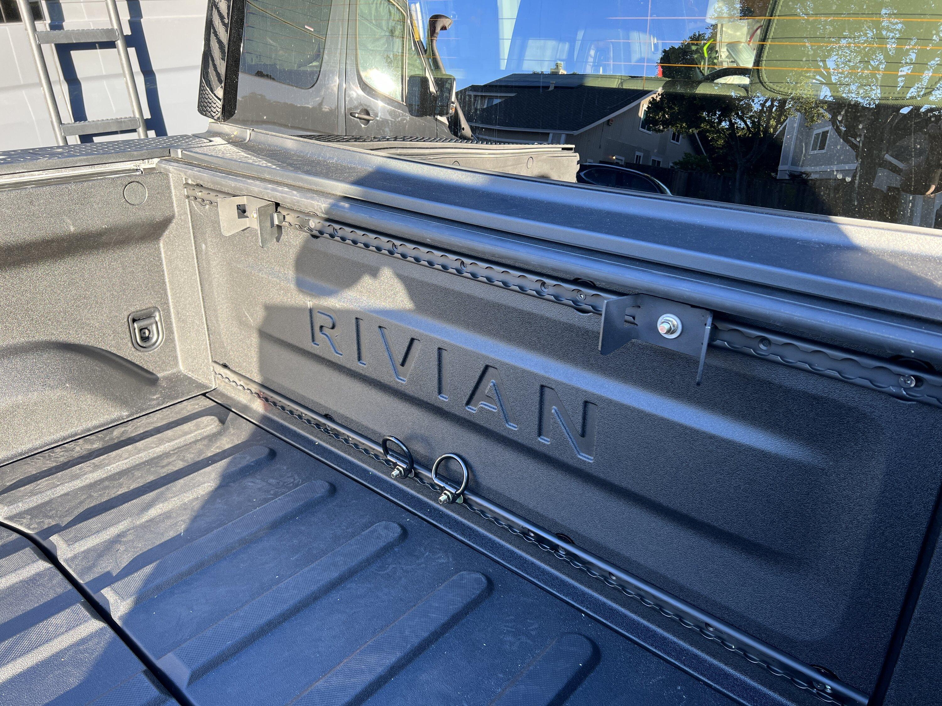

Here you go - two 4 foot sections of airline track, a box of screws from Amazon (M6 - 1.0 x 30) some modified wheels chocks for my dirt bikes and a couple tie down loops I had lying around.
Yes, those are Rivnuts and they go thru to the gear tunnel. You could easily add more if needed - both for the bed or securing something in the gear tunnel.

You mean the bottom row only correct? Isn't the tonnear cover plates piled up undeth the top row of rivnuts?
Great job! I run this airline track on my Hummer and love the versatility and options. I will probably do this same mod to my R1T.
I'd like to do exactly this. It'd be a great place to hold traction boards and whatever else

@RivianXpress Did you do the side of the bed too? I wonder what that looks like
Btw where did you get the wheel chocks? CCR Sport?
I was planning to do the side of the bed as well but I haven't found any pics showing how those bolts are secured so that project is on standby.
I bought the wheel chocks here:
https://ccrsport.com/ccr-sport-protrack-motorcycle-wheel-chock/
I did have to cut down the top edge so it would fit under the tonneau cover. I also used some L track bolts to secure them instead the ones that were included.

Thank you! I wish the L track can sit a bit lower so the chock can clear the tonneau cover. Or I guess find some other chocks so I dont have to cut it
There's not many chock choices that I found as the L track sits so high.
