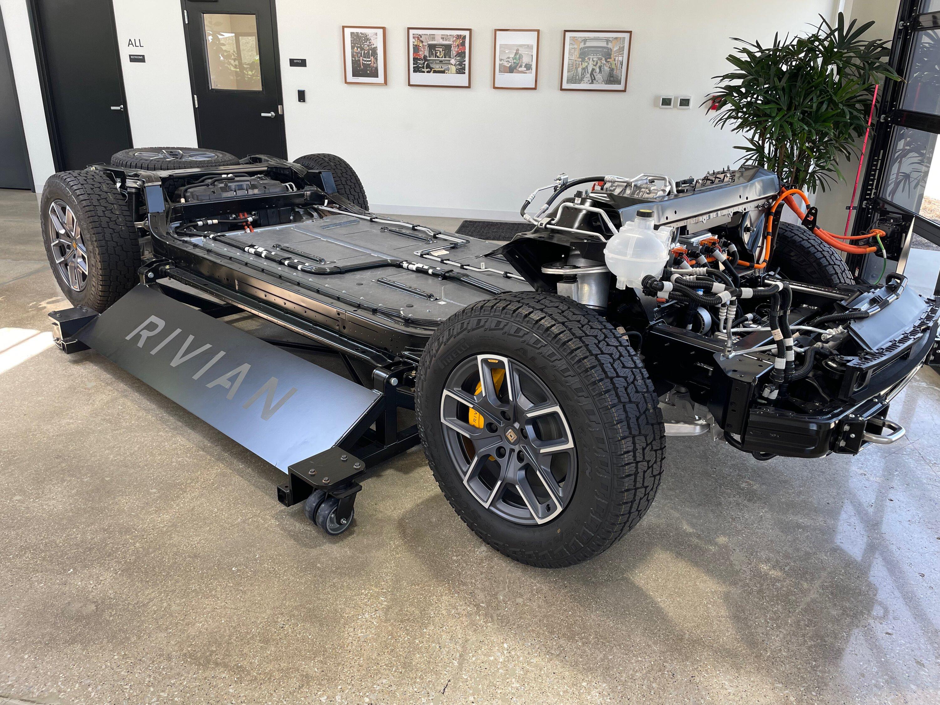

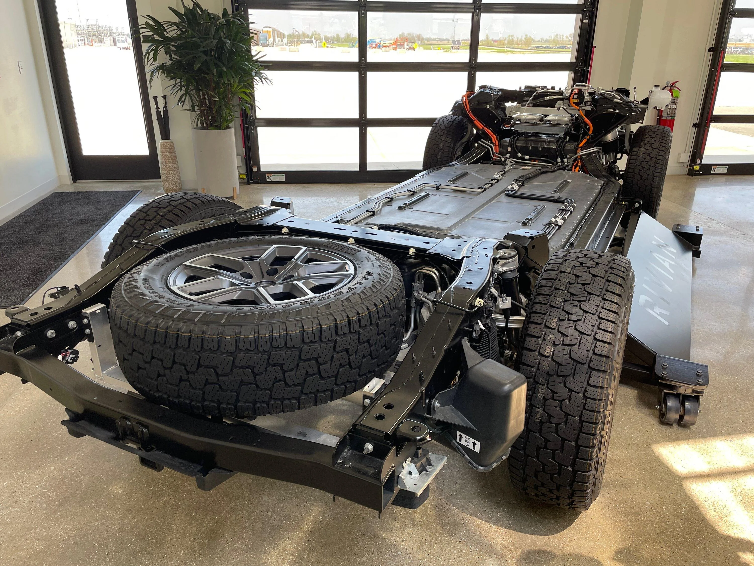

How close is the floor of the bed to the battery pack? Drilling holes could be problematic.

Might want to A: consult rivian how drilling or tacking to the bed, and B: watch the Munro video where they have the plastic pulled off it as well as where they lift the body off the skateboard. Would be instructive.
IIRC it should be fine drilling anywhere roughly spare wheel well and back, as well as a decent distance in front of it on the large pack trucks.

The rear motors and suspension components are under the area in front of the spare tire. The battery is under the passenger compartment. Here are some pictures from the skateboard platform at the factory delivery center.
Rivian R1T R1S Bed Rails IMG_4437
Rivian R1T R1S Bed Rails IMG_4436

Videos take a while to make, but this should give OP all the info they need about the possibility of adding rails. I'm really curious about the amount of void space that still exists in places- behind the battery and behind the air compressor tank. I'm going to investigate putting a larger compressor in and a larger buffer tank so it can switch modes quicker and more reliably.

it's not metal under the plastic cover? What is it then?
There’s a frame, but the plastic isn’t like a bed liner. There’s no bed underneath the plastic.
Edit: looks like I was already beat with pics. I don’t see how you think you just “sand through to the metal”.
