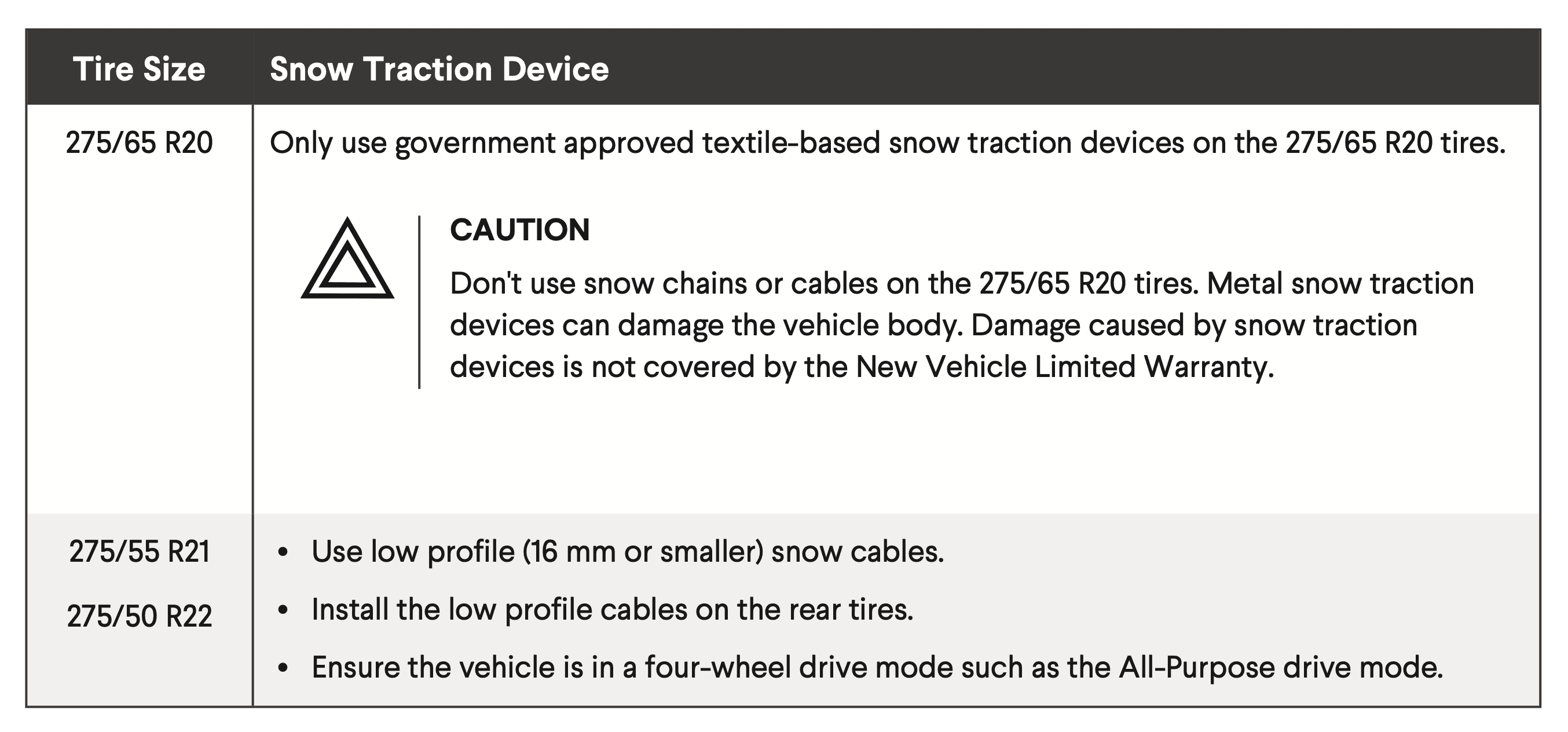

Why rear instead of front for the socks?
SPITmadFIRE
Jul 27, 2021
842
1,388
2024 R1S PDM Max Pack 20" AT
To be clear, OP did it on all four wheels for their trip.
But if you're wondering why a single pair would go on the rear wheels, then I'm assuming that would be to follow the guidance the user manual provides for all other tire sizes when using chains:
I think that guidance is only because of clearance issues with chains on the front.
