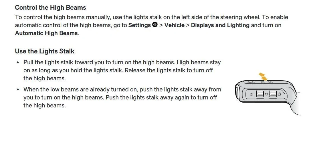

You can temporarily disable the automatic high beams by pulling and releasing the signal stalk...no need to fiddle with the headlight switch settings.
But that's only temporary, right? Or does that disable the automatic high beams?
It disables automatic high beams until you return the stalk to the forward position - which returns it to auto mode. I use this frequently when the automatic mode starts flashing too much due to traffic. I agree that messing with the headlight rocker switch while driving is not easy or safe.
