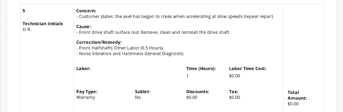

The front half shafts need to be greased. I've been to the service center twice for this issue. First time it came back the next week, second time the regreased and tightened the half shafts and I have a few thousand miles and it hasn't come back.
Ditto

I think it’s a version of the creaking/tocking as everyone said. I had a minor tock sound for a while and then one day it sounded just like yours. A few days later it went back to a single tock when starting/stopping. Mobile service lubed and tightened the half shafts and it went away. Been a few thousand miles and still good.
