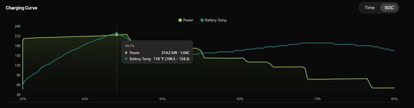

Hell yeah, my battery gets hot. Here in Texas, that's a given. And now that RivianRoamer just added battery temperature to it's tracking, you too can obsess over how hot or cold your poor battery is. For example, here is my battery being AC charged in a garage with the door partially open!

Pretty toasty, is that just after driving?
Also, in case others stumble upon this. RIvian has not started exposing battery temp for Gen 2 R1 yet. Just R2 and Gen 1 R1 right now. I suspect it'll be soon though.
Sep 26, 2025
Yes, but now it's been over an hour since I plugged it in and it's still sitting at 108F.
Also, just looking at a DC fast charge that I did earlier at 8AM, after a 174 mile drive, battery temperatures are much higher than that. I don't really know what to expect, but I heard Gen 1 cooling systems are not that good.

Nothing to worry about until the temps hit 140F. The bms won't waste power to cool the pack while parked.

These are pretty normal. Batteries get pretty hot.
