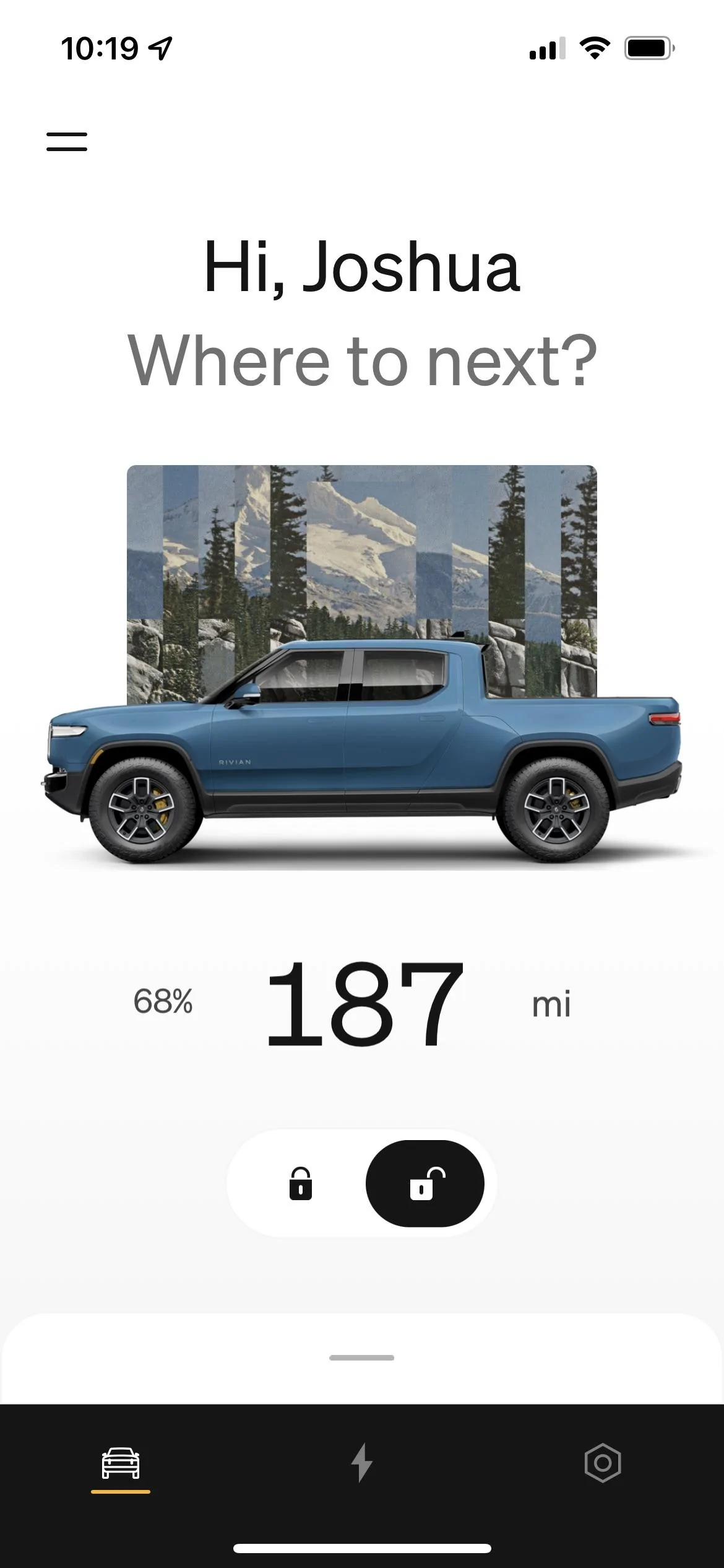

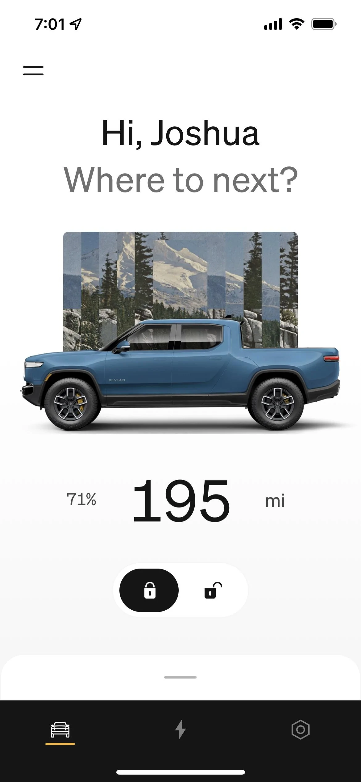

jjswan33
Joshua
Sep 17, 2021
135
4,455
9,880
Sandy, OR
.19 didn’t seem to improve things for me. Was losing 6 miles per day before, and lost 9 miles in 36 hours after the update. Time to play with some other settings (proximity, PaaK) to see if that improves things.
Same here. 27 hour test with .19.
