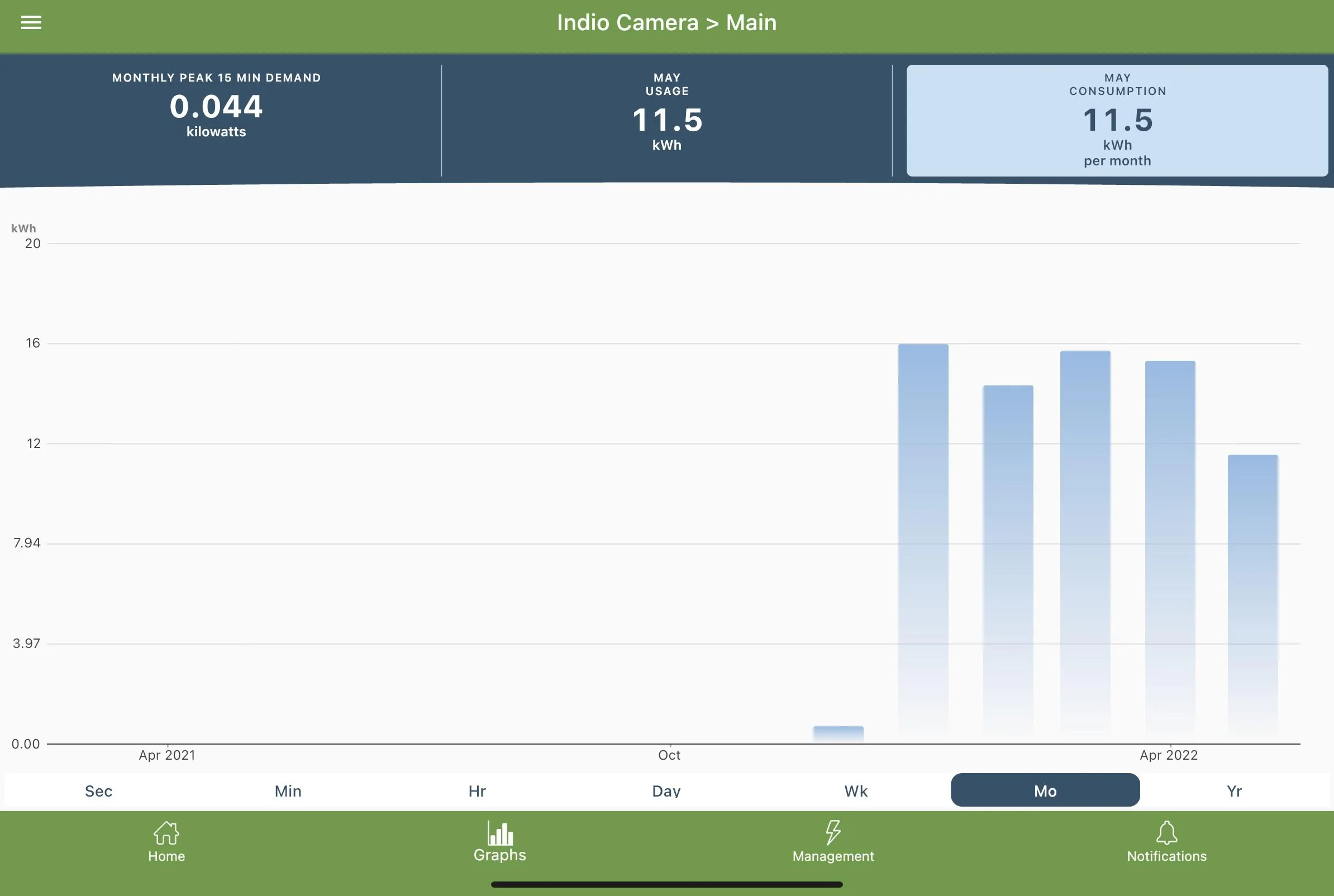

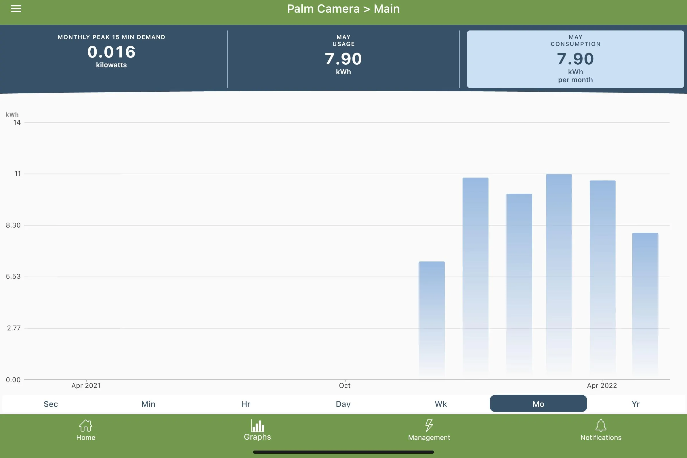

Any DVR/NVR surveillance system I've ever built/worked on actually streams all feeds from all cams 24/7/365 to the recorder but only saves "motion events" if triggered by motion as analyzed from it's image sensor chip... no PIR sensors, etc.. The NVR CPU constantly analyzes frame by frame data from every feed from every cam then saves image streams as required by user "rules". This method is what allows us to "pre-record" events that actually happen before a motion trigger is activated. We don't have a magic time machine that allows us to go back in time to before something happened.. but we do have the always recording stream from every cam in the buffer or temp HD file, and it's easy to save from "trigger" -30 seconds to "Trigger" plus 30 seconds so you capture the events that lead up to the trigger event.
If Rivians Gear Guard works like all the other NVR's.. it's constantly recording and analyzing all those cams frame by frame for events- which would explain the large amount of energy used by the Gear Guard system.
That is how the security DVRs I have work.
I have them on a smart plug that captures their energy usage, the house with a newer 8 camera DVR uses 8-11 kWh a month, the one with an older 5 camera DVR system uses 11-16 kWh a month. If gear guard is the main consumer instead of using around .5 kWh a day like the home systems are using, at 5% of the battery a day it is using 6.25 kWh a day, just does not seem reasonable to me.
