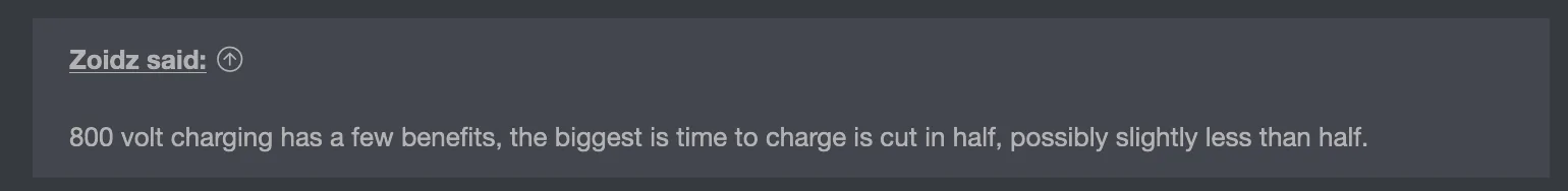

Not sure what "come on now" means? Are you disputing that if a manufacturer doubles the voltage while keeping the the same battery capacity, the charge time can't potentially be cut in half?
No. Not disputing that at all. What I am disputing is that it is necessary to go to a 800V architecture to double the charging rate and thus halve the time.
Consider a 100 kWh battery pack configured for 400V with an internal impedance of 0.01Ω being charged at a 400A rate. That would require 404 V out of the charger and the losses would be 1600 W out of the 161.6 kW being delivered by the charger i.e about a percent. Now suppose we want to double the charge rate (not that we'd want to do that because we don't want to charge the battery at 3.2C). We now need to push 800A requiring 408V from the charger. Voila! The power delivered is now 326 kW but, hold on, the losses are now 6.4 kW or 2% of the power delivered. So it is a little less efficient and, of course, we have to go to a cooled or huge cable from the charger. This is the approach Tesla has taken.
Now of course we can reconfigure the cells and charger into an 800V architecture. As the cells are now more in series we might assume Z = 0.02. To get 161 kW into the battery so configured will take about half the current and accordingly the losses will be less. The same is true if we double the charge rate. Having to run half the current to the car means much less robust charging cable and connector. This is the approach Lucid has taken.
HP350 chargers will deliver up to 920 and up to 500A in any combination that produces less than 350 kW and will, thus, charge either 800V or 400V architecture cars. But they can't charge 400V cars at 326 kW because they can't deliver the current.
