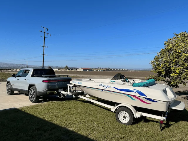

I left SB with about 95 SoC. The truck handled as if there was nothing behind it. Despite the boat's small mass (~2500 lbs) the impact to range is substantial. The change in drag coefficient reduced my efficiency to about 1.6m/kWh. It dropped as low as 1.31m/kWh with a substantial (~25mph) headwind.

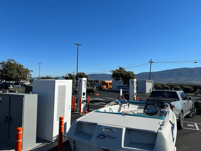

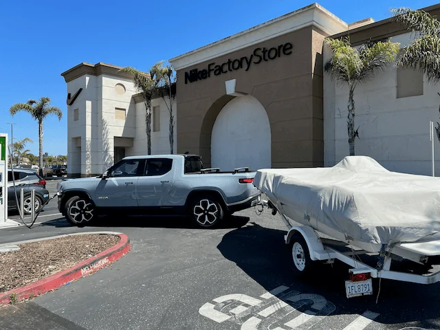

I charged at an EA station in Pismo Beach and pulled a peak of 212 kW from the 350kW nominal dispenser. I had to partially block one of the exits to the shopping center with the trailer. Fortunately, it was a lesser used entrance and didn't seem to impact the flow of traffic too greatly. People seem more amused than frustrated.
I stopped again in Soledad anticipating usage of EA hardware located there that I have used many times. The location and density of the dispensers pretty much ruled out using this station without substantially impeding the flow of traffic or unhitching the trailer. Luckily, EV Range, an up until then unfamiliar network to me, just installed four new dispensers on the other side of the parking lot. Not a user in site despite a full station across the lot.
I figured it was worth a shot and hooked up to the 200kW nominal unit. I pulled 165kW deep into the pack after going through their slightly clunky but functional registration and signup process. I say clunky in that it required manual entry of CC details. PayPal, Apple Wallet, card scan, tap, anything, really is more convenient that manual entry. In any case, the charge was sustained until about 90% when the dispenser kicked off. I had about a 20 mile buffer beyond my destination, so I didn't bother reinitializing.

I see a picture with a tarp or cover on the boat and another without.
DId you do your trip with the tarp on or off? If it was off, that could have impacted your drag coefficient giving you a worse number and subsequently, worse range.
I pulled the tarp as it was inflating and impeding my visibility in the rearview behind the boat.
Removal happened to also align with start of 30mph headwind zone...hard to decouple those variables, but I suspect the wind was the larger factor.
