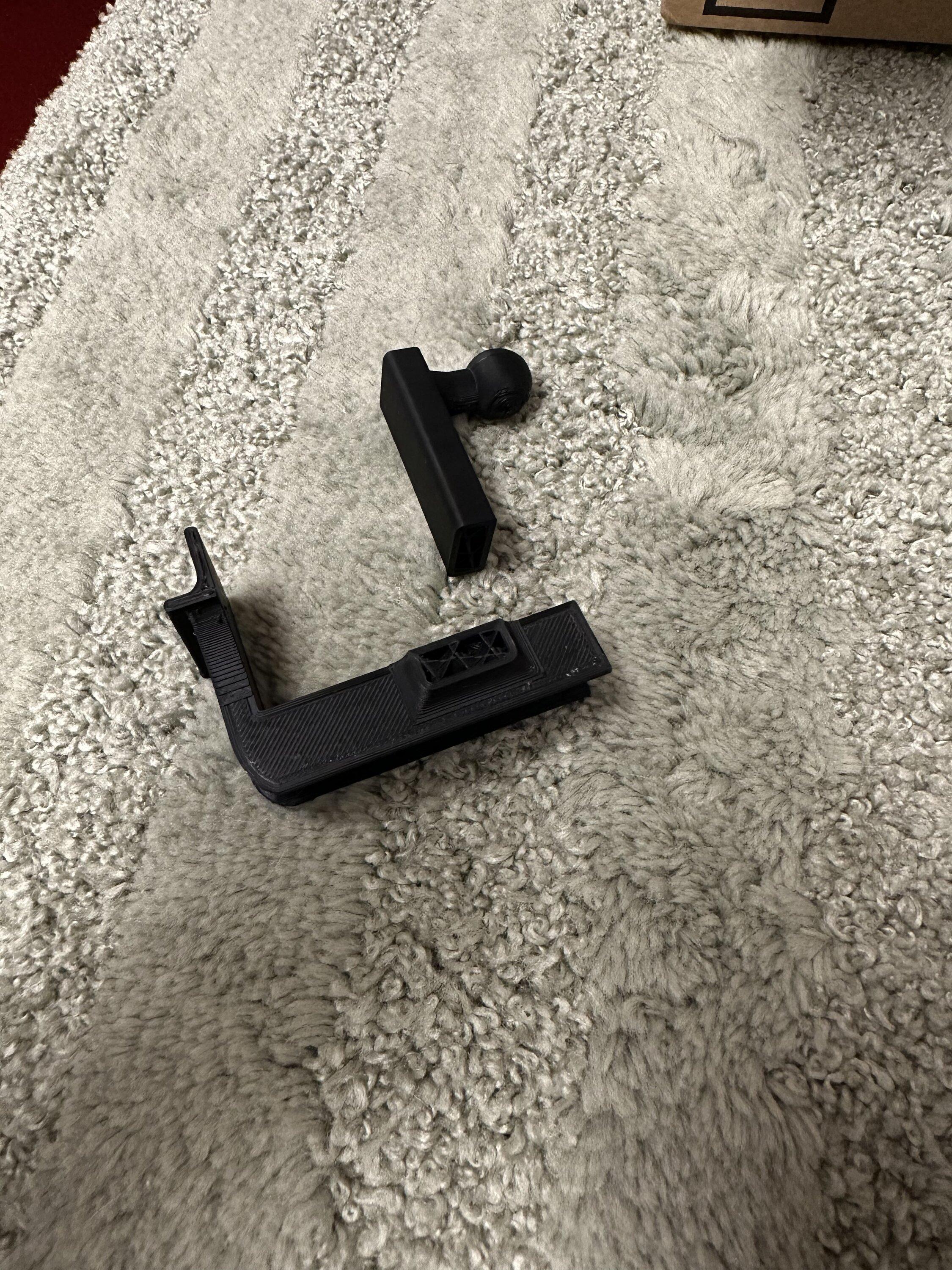

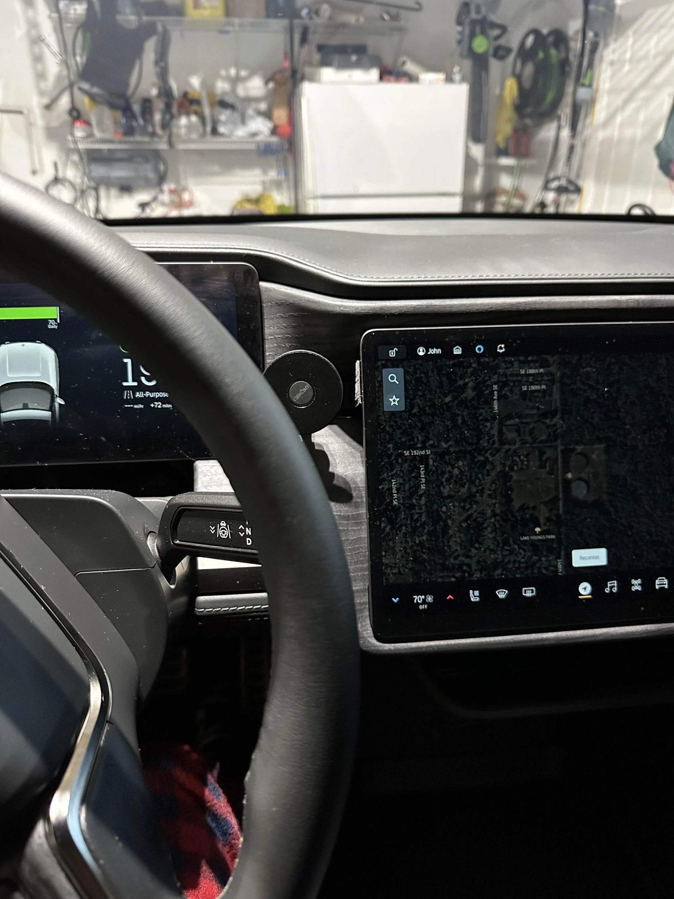

UPDATE:
My error for not checking the geometry of the dash location... It turns out that the ASH wood trim jets out as you move higher and interferes with the extension I asked @ATX_R1S to add for me. You just can't extend the ball straight up.
The joint between the original body and the added extension is too weak as well - easily snapped off. Seems like the extension arm needs to be affixed to the face of the original, and not the top. That would address both issues, me thinks. See attached photos.
So, this model can be scrapped and removed from the cloud.

UPDATE:
Noted. I actually thought about the dash interfering, but too late, my order is in production. I will mess around with it when I receive it and see what angle works best. I will try sanding it down if it doesn't need all that much clearance from the dash.

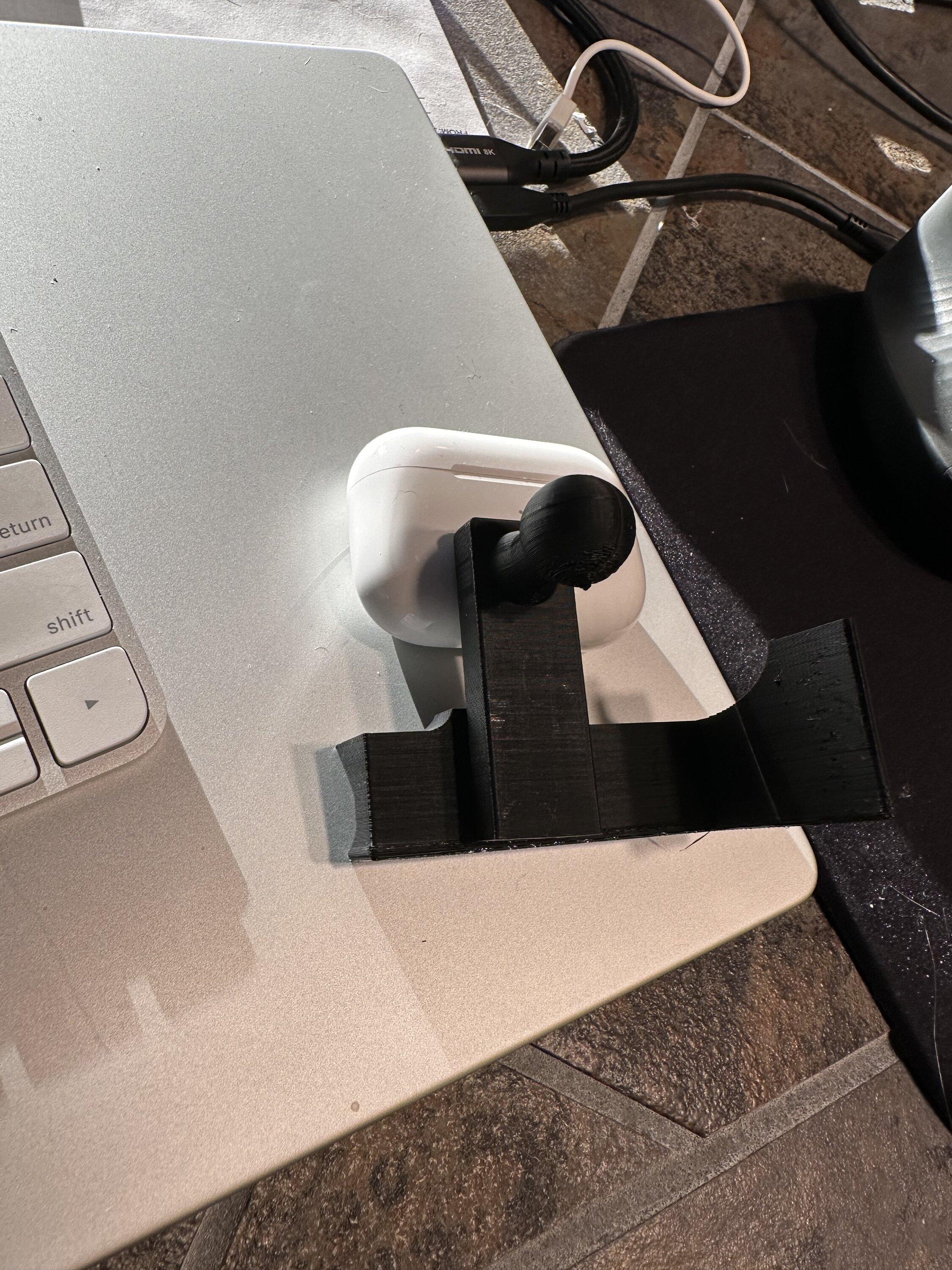

Wish I had a 3D printer... wouldn't mind a little more height on the otherwise perfect 17mm Pro mount.
EDIT: Ordering it from Craftcloud. Did ABS with 60% infill... hope I chose properly, I have almost zero idea how this stuff works. Thanks for the file!
I wanted it higher too. Check out what I did redesigning that 3D printer model.
