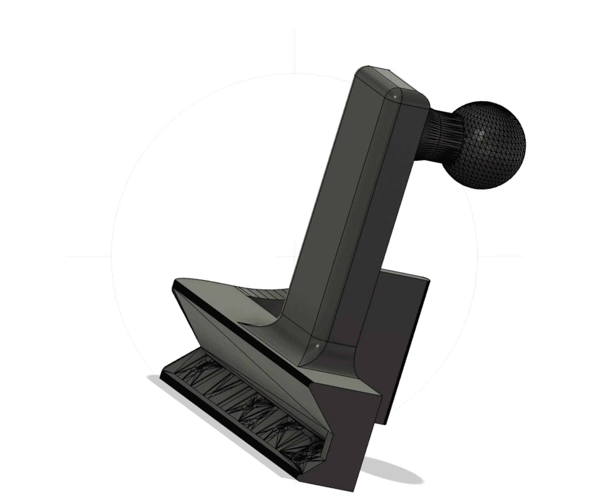

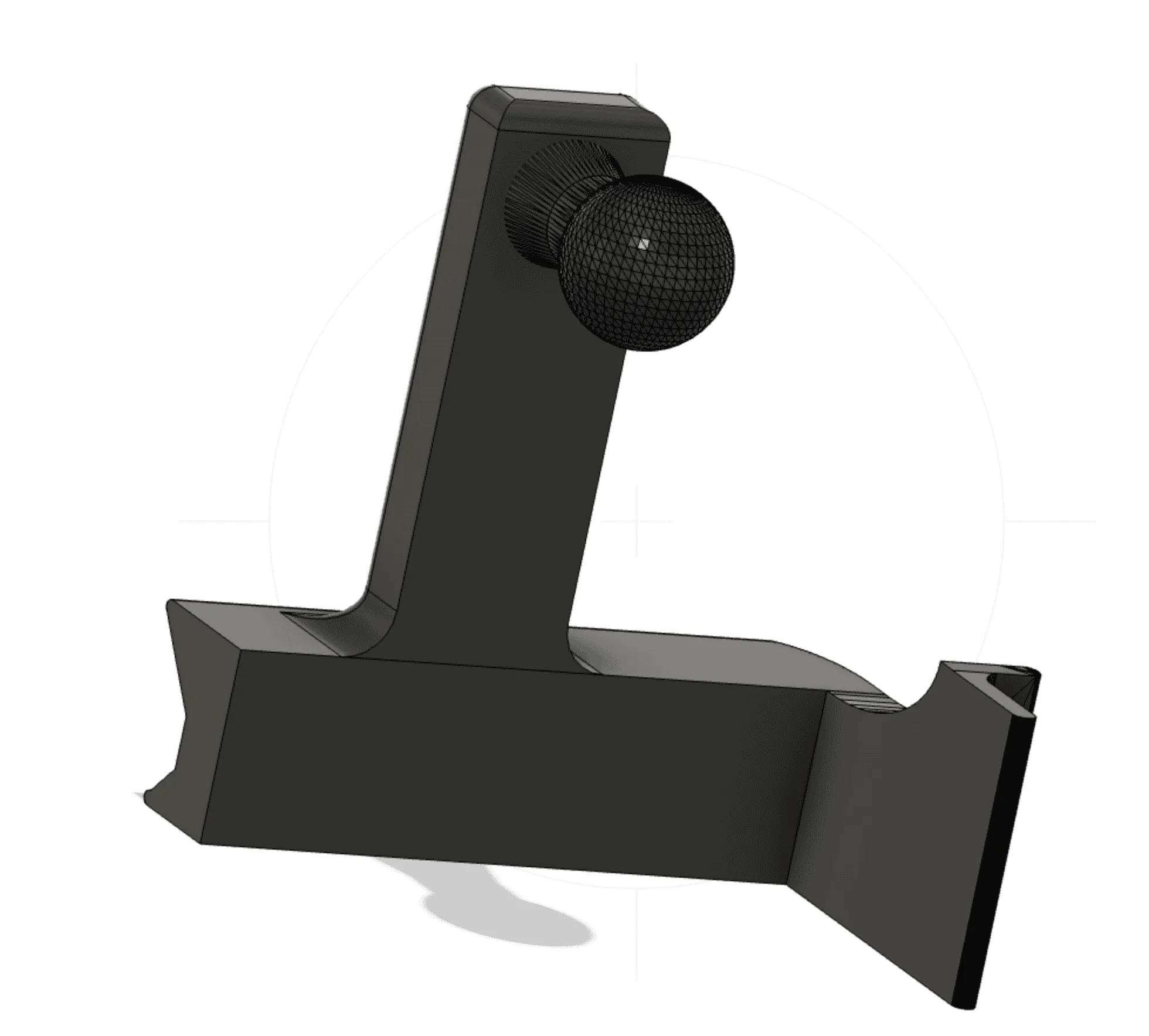

Nice work @ATX_R1S !!
What program did you use to modify the original file... looks very professional and no "this is not a manifold" errors.
Thanks! I used Fusion360 to modify it (converted mesh to object, made my edits, glued it all back into a single body and exported).

Ball centered, and slightly redesigned the riser. Can tweak it more if you want.

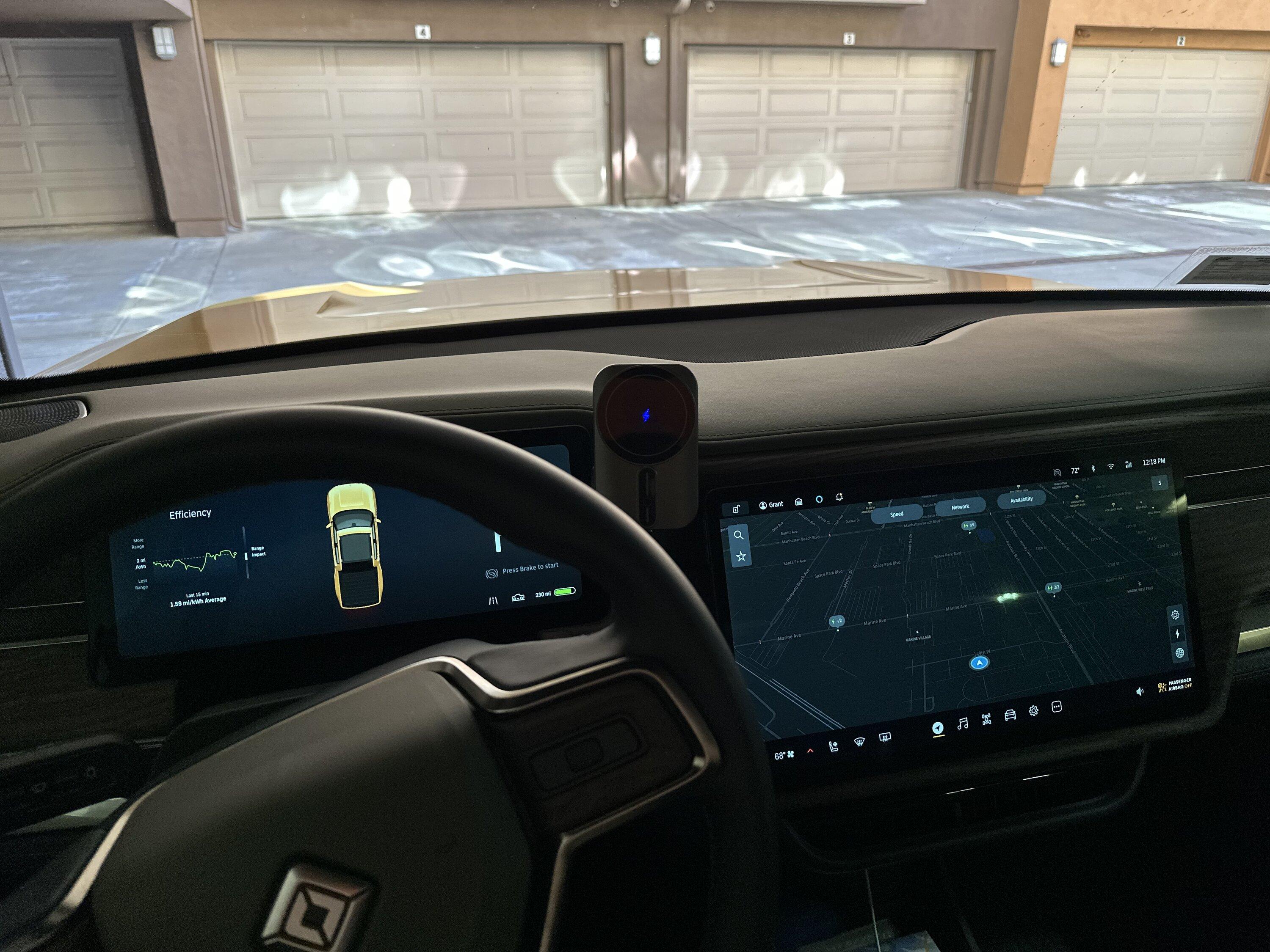

UPDATE:
My error for not checking the geometry of the dash location... It turns out that the ASH wood trim jets out as you move higher and interferes with the extension I asked @ATX_R1S to add for me. You just can't extend the ball straight up.
The joint between the original body and the added extension is too weak as well - easily snapped off. Seems like the extension arm needs to be affixed to the face of the original, and not the top. That would address both issues, me thinks. See attached photos.
Rivian R1T R1S 3D printed ball mount remodeling help needed IMG_5377
So, this model can be scrapped and removed from the cloud.
Rivian R1T R1S 3D printed ball mount remodeling help needed IMG_5373
Rivian R1T R1S 3D printed ball mount remodeling help needed IMG_5376

UPDATE:
Noted. I actually thought about the dash interfering, but too late, my order is in production. I will mess around with it when I receive it and see what angle works best. I will try sanding it down if it doesn't need all that much clearance from the dash.
