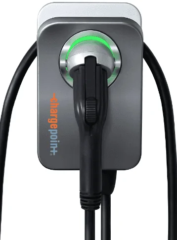

Check with your electric utility, I had to use a specific wifi capable model to take advantage of off peak discounts and a $700 rebate. The Charge Point Home Flex is usually one that they support.
I got the Charge Point Flex for free (including installation) from my utility. Works great and app tracks usage.

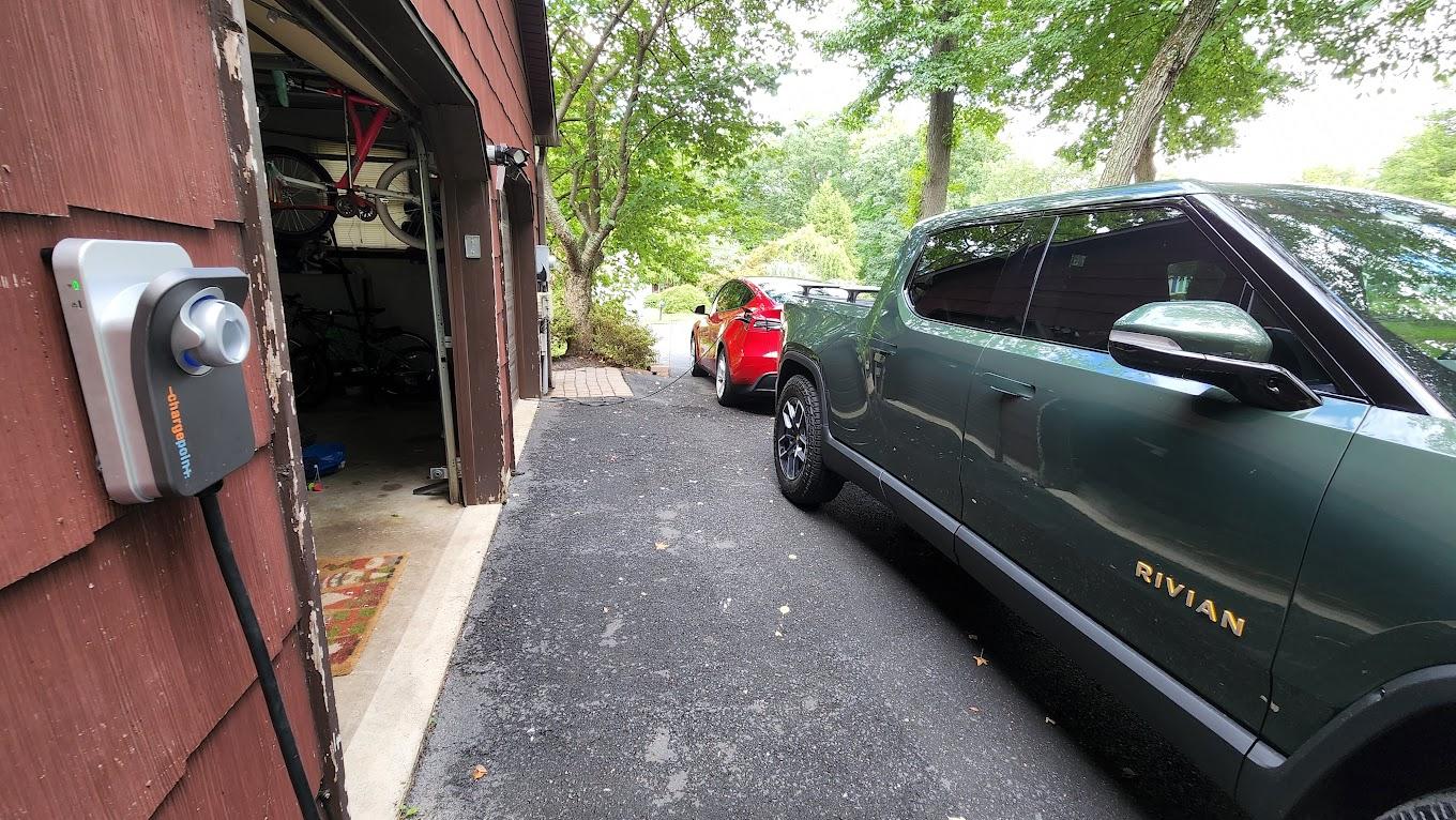

Another Chargepoint happy camper. The 18' cable is a godsend, can easily wrap around the truck so don't have to reverse in
Rivian R1T R1S Is the Rivian-branded Level 2 charger the best available for home charging? 1691764496897
