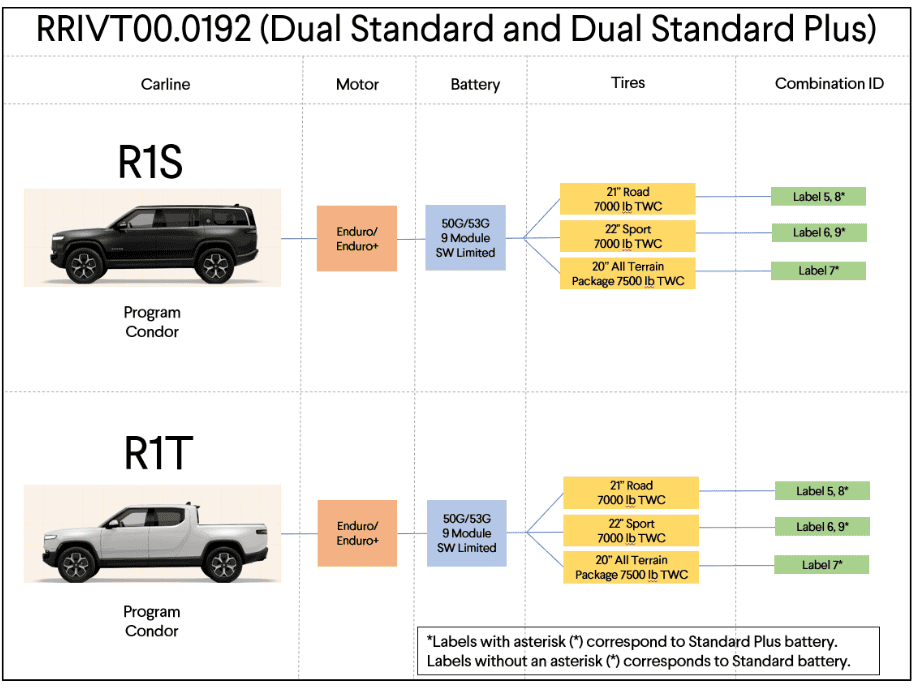

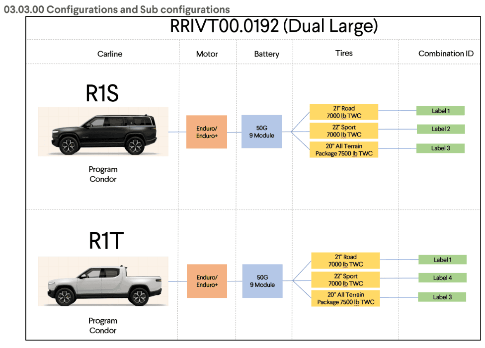

Also seems to confirm that the Max Pack batteries are using the 53G battery cells.
Infographics from here
I haven't gone through any of the remaining data in the testing document.
Rivian R1T R1S EPA Test Data confirms Standard Battery and Standard+ are software locked versions of either Large or Max pack batteries 1714679136860-4s
Rivian R1T R1S EPA Test Data confirms Standard Battery and Standard+ are software locked versions of either Large or Max pack batteries 1714679176623-se

Max Pack is already known to be the same physical size as Large, just with the "53G" cells instead of the "50G".
Standard+ is just the Max pack cells in the "Standard form factor" (same % SW lock, apparently.)
This is surprising to me, as I would have thought Standard/Standard+ would have just been the 50G/53G cells with only 7 modules instead of 9, since the range of Standard is 7/9th the range of Large, and the range of Standard+ is 7/9th the range of Max.
Since the whole point of the Standard packs was to theoretically save money, the rather large discount for buying them (especially S+!) is wild.
Standard is a $9,000 discount over Large, for what we now know is the same pack. While Standard+ is a $16,0000 discount over Max! (Even bigger discounts if you qualify for the tax credit, since Large and Max don't qualify.)
