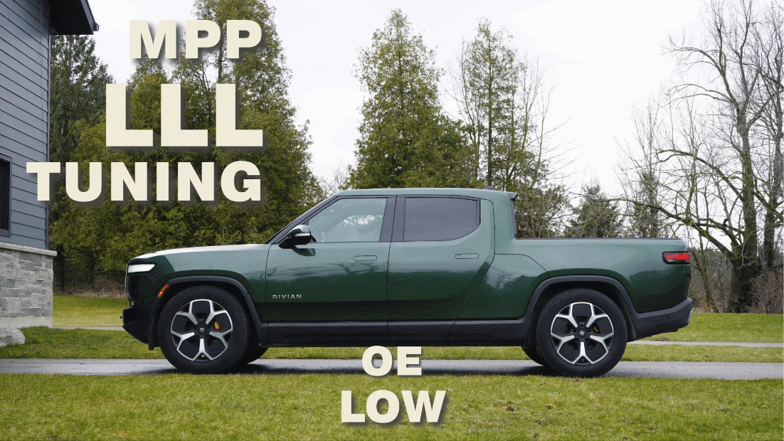

For myself, the main motivation to design this product was the dislike I have of the excessive rake the truck has in low mode. This also causes a rough ride as the front axle is riding on the bump stop all the time, while the rear has comparatively plenty of travel. This results in a lot of seesawing! Enter our "Triple-L" ride height adjusters, which allow you to Lower/Lift/Level your truck. What a great tacky name we came up with!
After raising the front slightly the truck looks much better, and the ride quality is soooo far improved. Most of the time the front bumpstops are no longer significantly engaged, and when they are the truck now lands on both front and rear bump stops evenly and the fore/aft seesawing is gone.
Now about the parts - normally "lowering links" are complete link replacements that are adjustable in length. In the case of the Rivian, there are brackets on the control arms which we've been able to redesign making them easily adjustable. This is a unique approach, and I don't think anything similar has been done before - but it gives us the great benefit of being very accessible and easy to adjust compared to lowering links. We can make adjustments to the full truck in less than 2 minutes - without removing the wheels! (but we've also done it about 100 times now to be fair)
Adding laser-etched marks allows for repetitive and precise adjustments (although don't bother getting too OCD about it - the truck works within a window, so ride heights will always be moving around a little bit). The front is a bit more challenging because it is impossible to see the marks without a mirror or some kind of micro drone flying in your wheel well. To make life easy for everyone we laser cut some "keys" and designed slots both top and bottom in the adjusters to allow for consistent adjustments even when running blind. Yes, it's so easy even a blind person can do it. You probably shouldn't let them drive your truck though!

Rivian R1T R1S **NEW** MPP "Triple-L" Ride Height Adjustment Kit For R1T/R1S - Lower/Lift/Level Rivian LLL Height Tunin

Thanks! This is what we recorded hub to fender:
OEM Highest:
Front - 566mm
Rear - 587mm
Triple L's at the highest setting:
Front - 601mm
Rear - 605mm
We did notice a larger-than-usual variation in the ride heights that are achieved at the "highest" setting, so it's possible the system is also logging air spring pressure rather than just level sensor signals.
