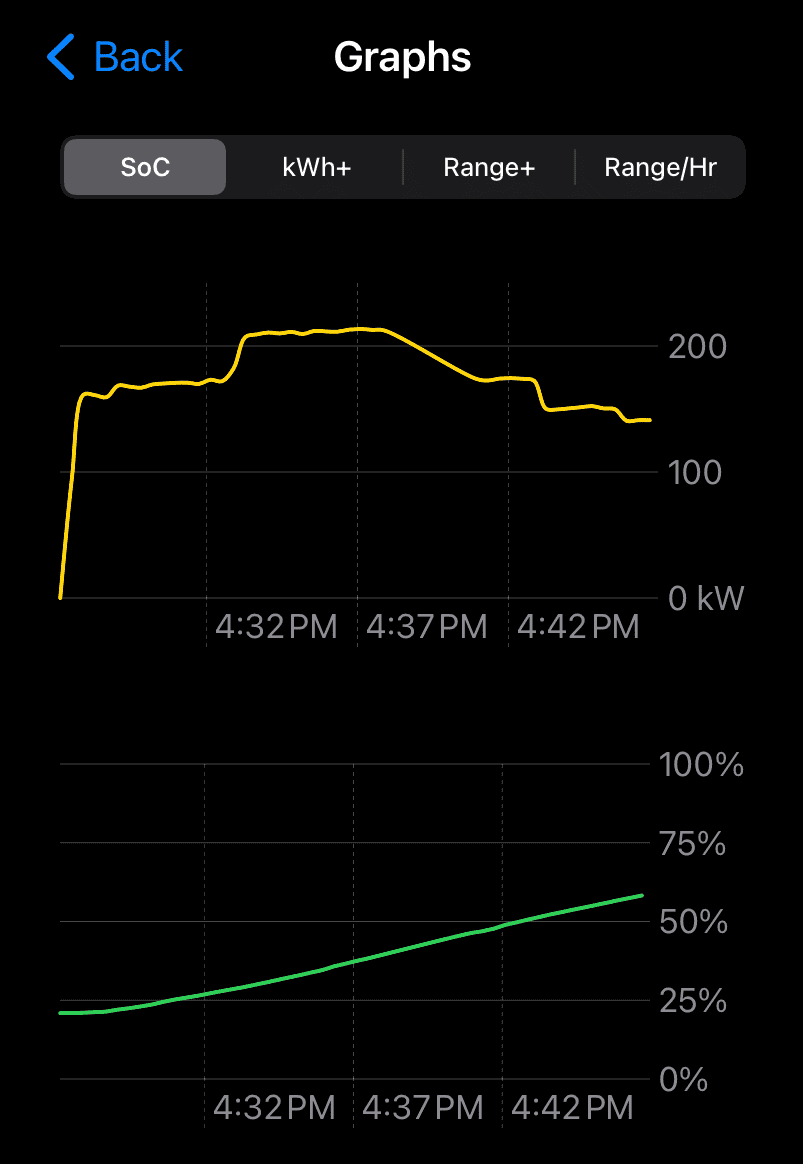

Hi Everyone,
With Tesla's opening of supercharger access for Rivians opening up on the 18th, we were eager to get to a supercharger and experience the process. The pain here in Canada of Level 3 chargers is unberaable, and you'll see in the video we have some rather pointed words for the charge operators who we feel have done a massive disservice to EV adoption as a whole.
Our motto is "The only thing worse than no charging is bad charging." This couldn't be more true, because no one in their right mind would plan a road trip to somewhere without charging if it was beyond range, but when there are some Level 3 chargers along the way, we all trust them to work!

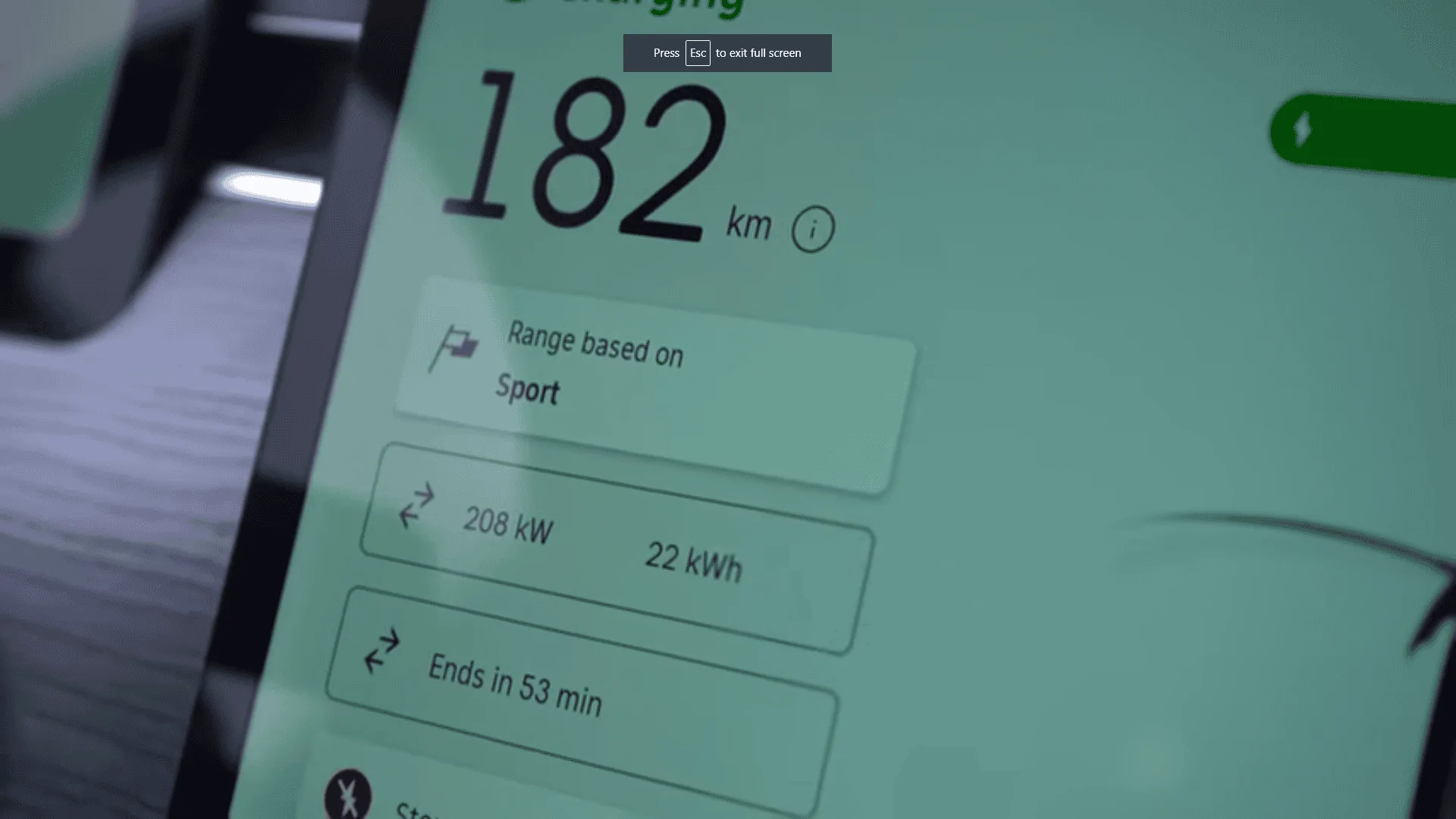

We arrived at the charger with around 25% battery, and with the battery preconditioned to 24 degrees C. In this video, we used the A2Z EV NACS adapter which worked great other than a little bit of fiddling with the "lock" latch which is required for the charger to work.
In Canada at the time of the video, we weren't able to just pull in and charge. Perhaps that is coming in the future, but we had to either use the Rivian app or Tesla app to select a stall and start charging. Overal the process isn't as seamless as charging a Tesla, but compared to other chargers it was so much better.
The video covers some of the other steps on how to get connected if it's your first time (it won't be your last!!)

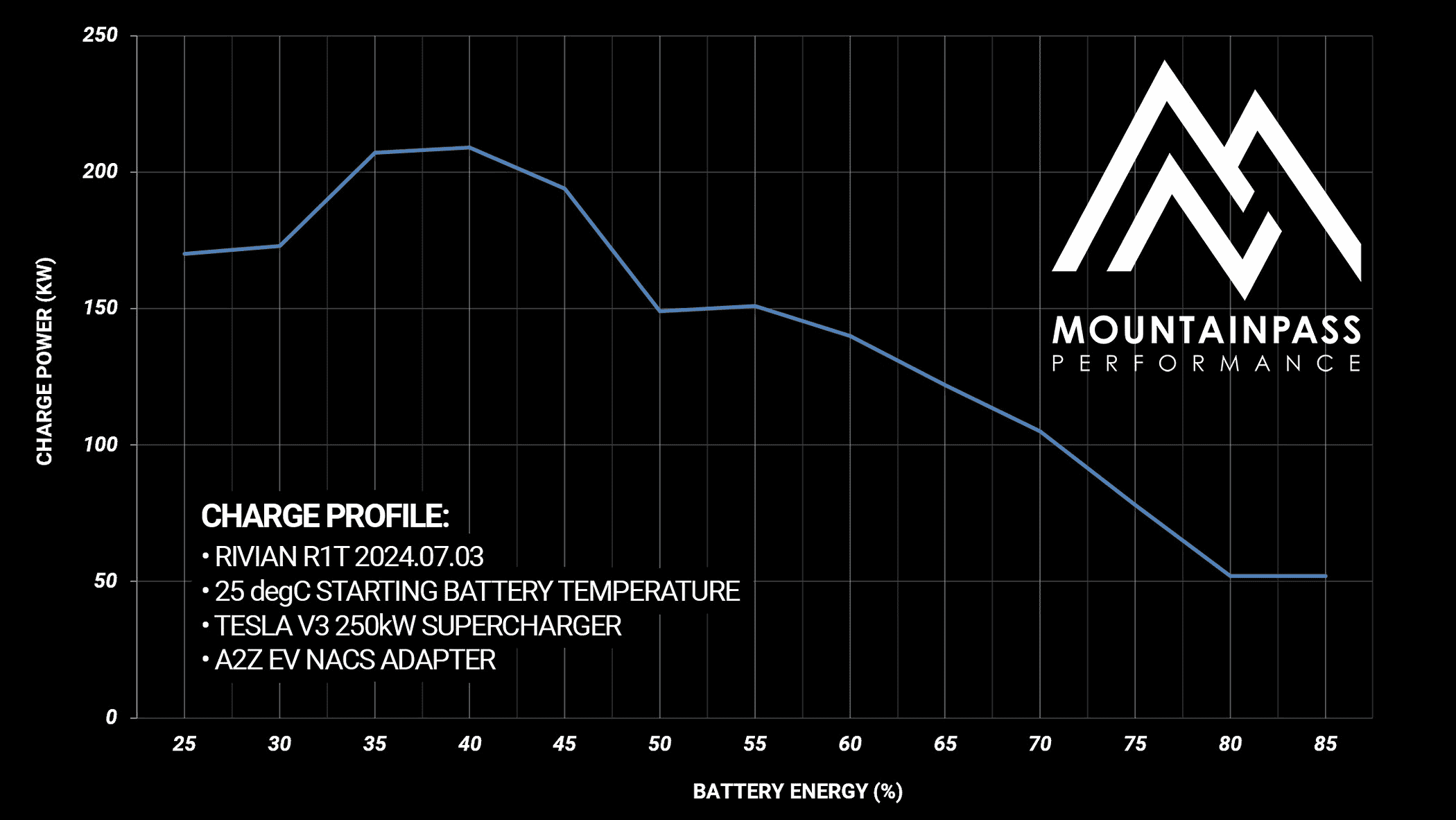

Here is a coarse idea of the charge power we achieved during our first session. The data points are input every 5% SoC.
In the end, we have to say THANK YOU Tesla for opening up your network to others. No doubt losing a significant competitive edge as this is by far the most reliable and useful charging network on the planet at this time. Yes we understand government incentives were involved, but none the less it is a big move for Tesla.

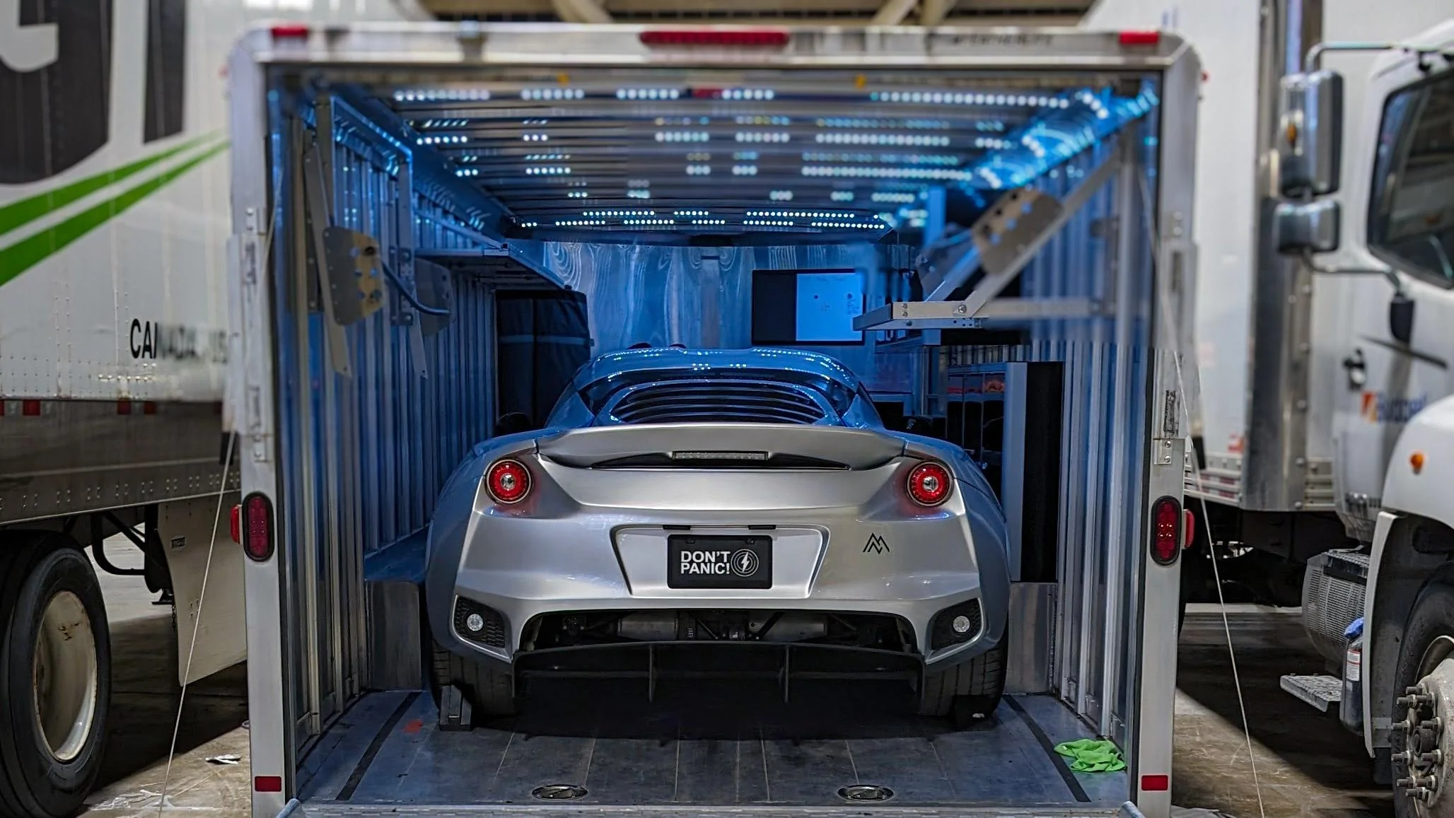

On that note, here's a photo of our Rivian and our Featherlite 32' aluminum enclosed trailer, towing our EV swapped Lotus Evora to the Canadian International Autoshow. The truck did an incredible job towing. It is by far the best and smoothest towing experience I've had, specifically when it comes to reversing. No flaring torque converters and overheating transmissions - just smooth, seamless torque and smooth ultra quick steering. Never thought towing could bring so much joy!

Thanks for sharing. Charging curve looks the same as RAN, EA and other high speed chargers, expected at this point but still great news.
Also thanks for sharing the info/explanation without making us watch the video :CWL:

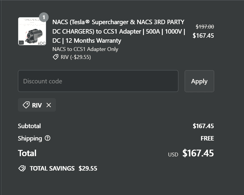

I just ordered one using discount code "RIV" and will use it until the official one shows up.
A2Z EV Link - NACS (Tesla® Supercharger & NACS 3RD PARTY DC CHARGERS) to CCS1 Adapter | 500A | 1000V

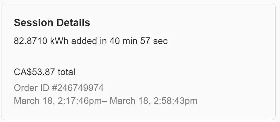

Time to charge from 25% to 75%?
That is pretty much the typical charging curve, but the charger, battery and ambient temperatures, and vehicle all can influence this. A recent 20 minute charge from 21% to 59%:
I typically see a step at the start into the 160kW range followed by the peak in the 215-220kW range, followed by the ramp down the higher you let the SoC go (I stopped at 59% so you don’t see mine drop below 100kW).
If you don’t see over 200kW within 5 minutes of starting then something is holding it back.

Interesting it didn't crest 200kW for quite a while, I would have thought it would have taken the full 500A right from plug-in.
Having said that, I've only used up to 150kW units so far in BC, and I've been able to get ~150kW from relatively low SOC starting at 20C up as high as about 60% SOC; I've used them a few dozen times and my average rate for an entire charge (usually around 20-30% SOC up to about 70% SOC) is ~140kW.
40 minutes - however getting 80kWh would take far less time if we arrived at 5 or 10%!
Thanks for posting Sasha. Very excited to have SC access out west, especially with several trips upcoming with our TT this spring & summer (Nelson to the Okanagan, Nelson to Whistler for Crankworx, Nelson -> Waterton -> AB Badlands tour -> Canmore).
Yes, it seems that Rivian introduces the power more slowly for a minutes to warm the battery gently. Even at 160kW that is just over 1C, so Rivian is being very gentle to these batteries compared to say a Standard Range Plus Model 3 Charging at 160kW (3C) right away.
Tesla also preheats their batteries to much higher temperatures from what we've seen.
I'm confident Rivian is playing it safe until they get more data on the long term degredation of the packs. Once they have more confidence, they could easily preheat to a higher temperature and charge at full power straight after charging.
As for the upper end tapering, without seeing the battery voltage I don't know. Hooking up a logger to this truck and capturing data would be really nice to understand.
It does seem that there should be more "in the tank" to charge at a higher rate, I highly doubt the battery is at the maximum cell voltage at 150kW at 50% state of charge.
Regardless - having chargers that can consistently work and output everything the Rivian is asking for is a massive massive step forward compared to the current state of affairs here. So we're very happy and any future improvements will be considered icing on the cake!
