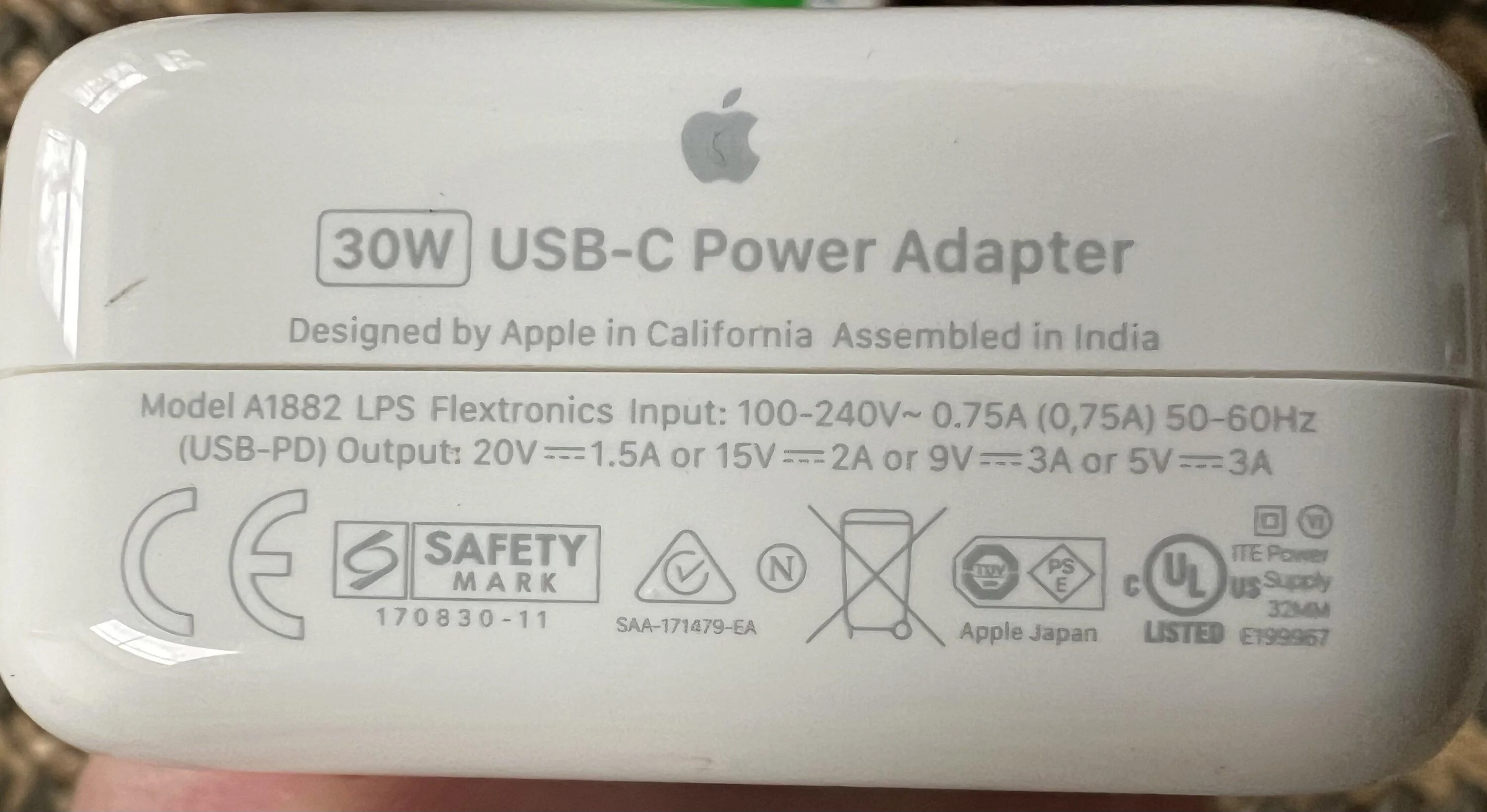

This is so helpful! Thank you for posting this info. My speaker has not consistently worked. This has to be the reason.
Edit: Hmmm. A MacBook 30w power supply seems to be working ok. Seems to have the right voltage output range as well
I have a similar Apple Power Adapter with those specifications and it still didn’t work. ??‍♂ As long as the light is pulsating on the Rivian Speaker you’re good!
Maybe Rivian hasn't paid Apple licencing fees? ;)

NOT COINCIDENTALLY, those are the exact voltages that are shown on your image from the Camp Speaker manual and on the Apple charger in #5.
