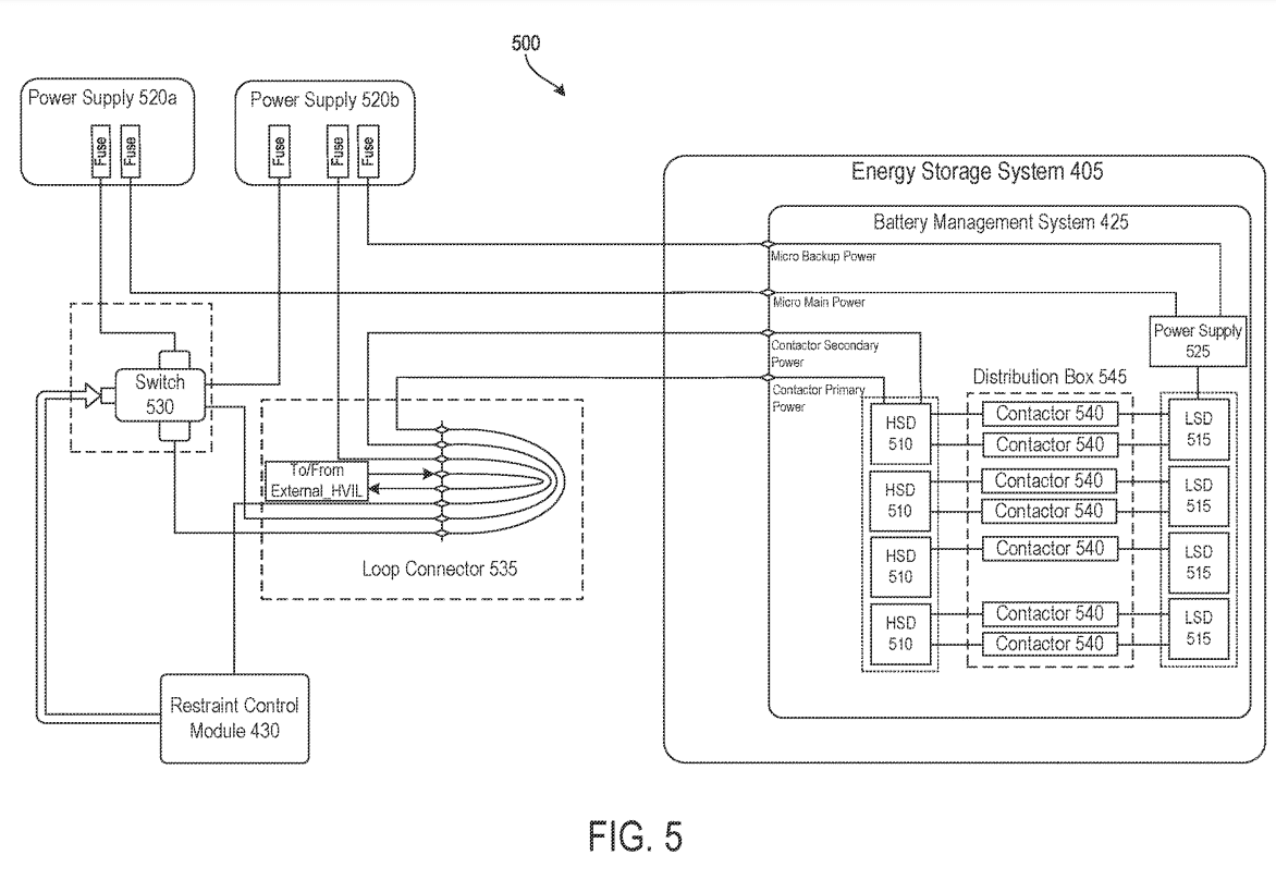

Rivian does have a patent that sortof maybe would cover how they could do this. But the actual implementation details are vauge like most patents tend to be.
https://ppubs.uspto.gov/dirsearch-public/print/downloadPdf/11794585
Claims
1. A system, comprising: an electrical circuit of an electric vehicle comprising: a plurality of power supplies;
Edit: Diagram from the patent.
Rivian R1T R1S New Battery Pack coming soon says Rivian... combination High Nickel and LFP cells ? 1707515229845
