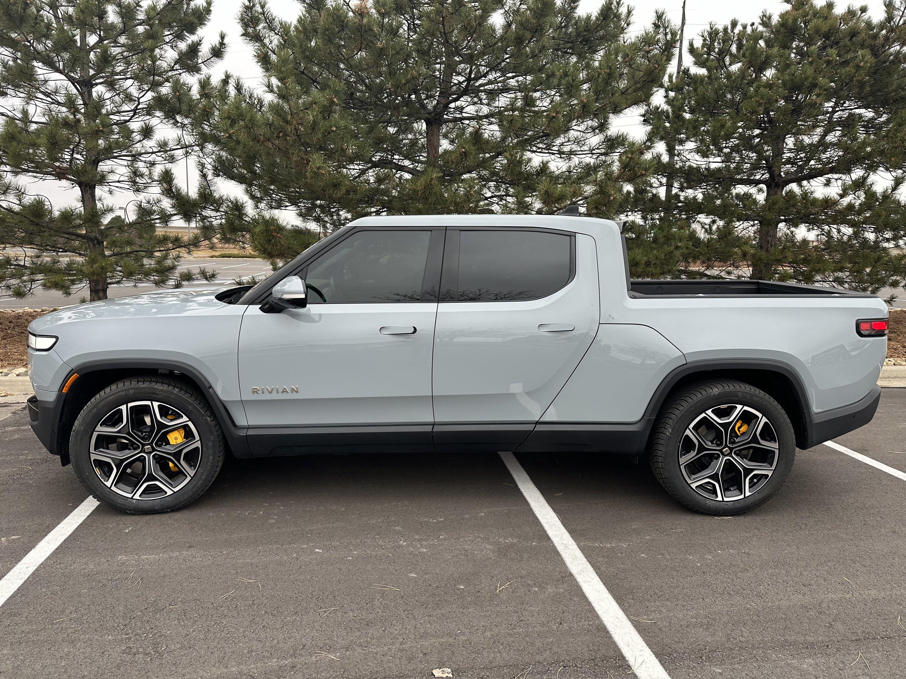

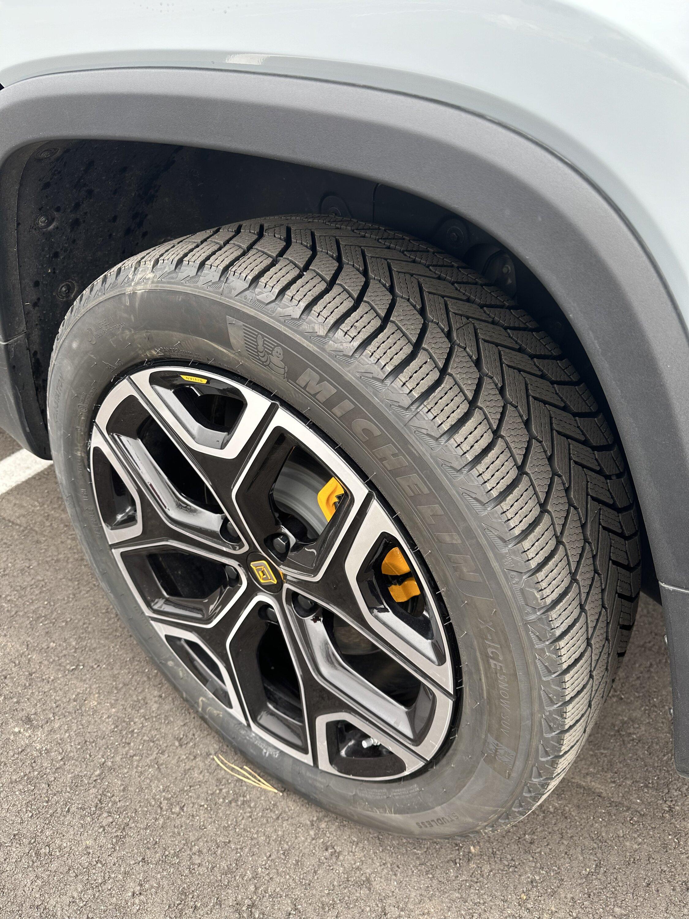

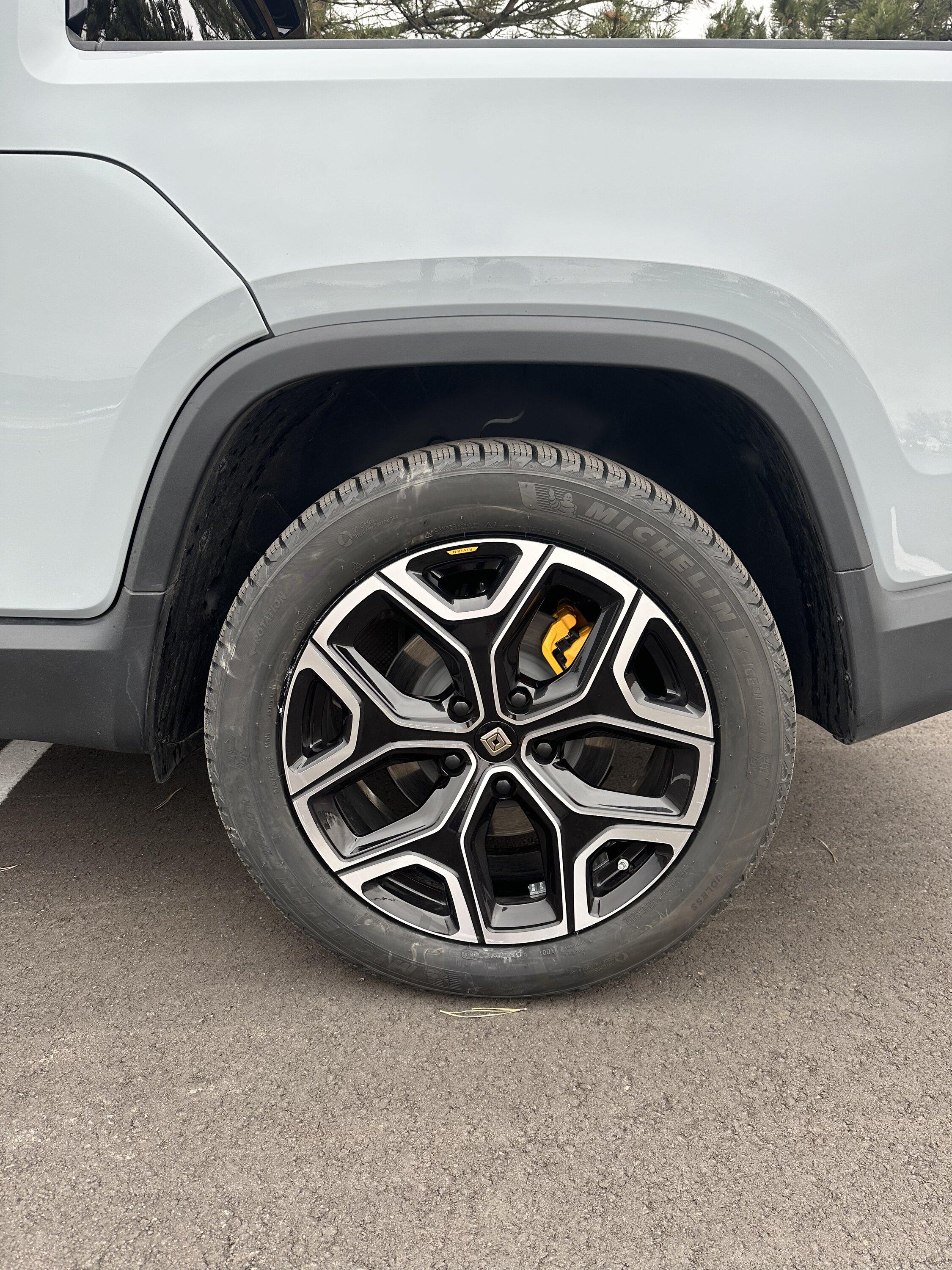

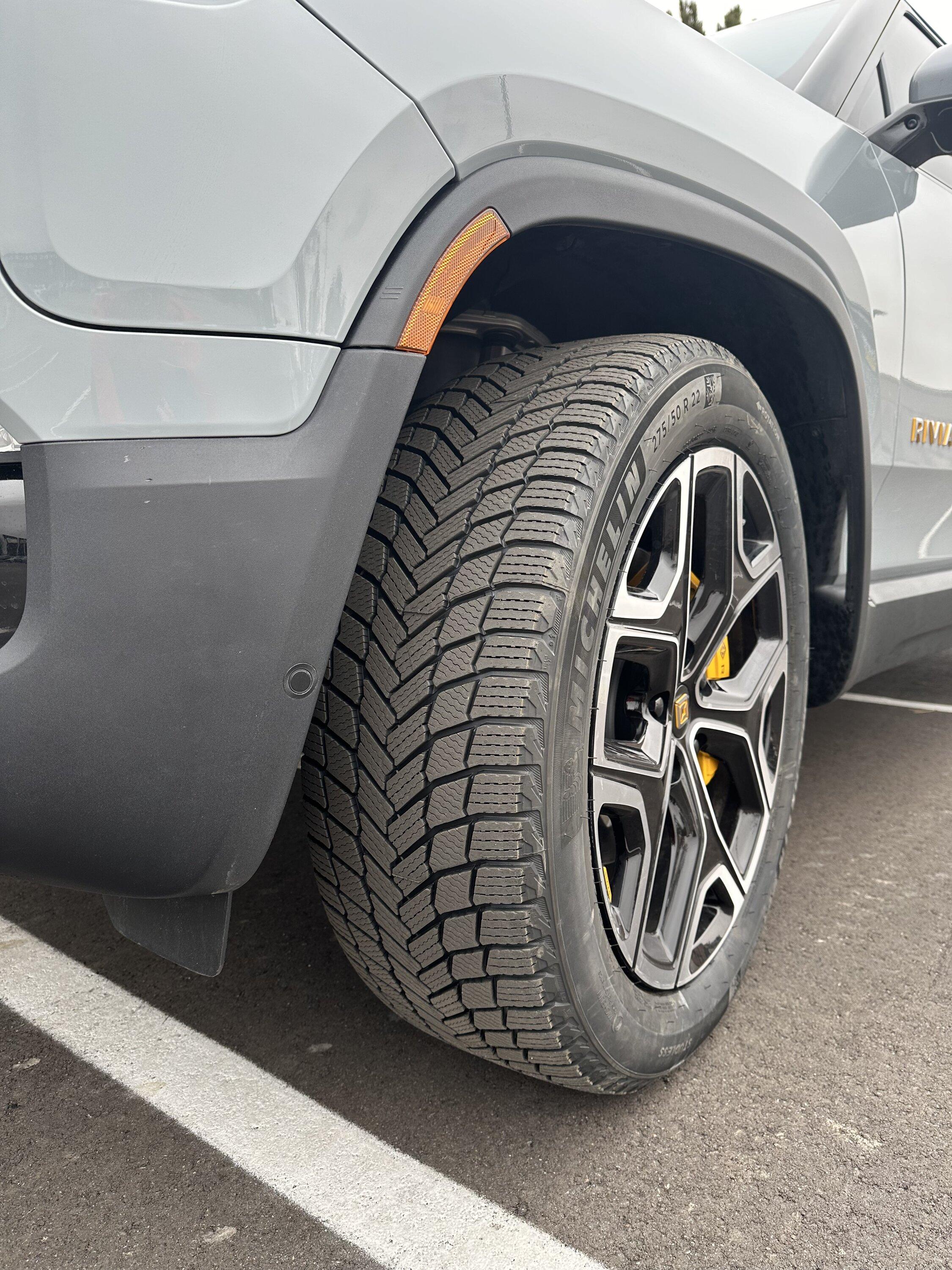

Just had my 275/50R22 Michelin X-Ice tires installed today - huge improvement over the stock Pirelli 22s which were at 5/32” after 11,500 miles. They look great and also eliminated my slight pull to the right. 115H load rating no issue for Discount tire. Excited to get these up to the high country!
