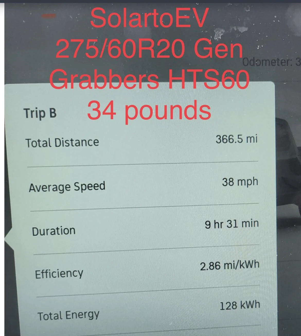

ksurfier
Ken
Aug 23, 2022
58
1,308
1,260
R1S, Tesla
Fake Science Lead
People here are cracking me up…
For efficiency, number 1 is tire weight…
That is one impressive number. How is this tire traction compared to the stock Pirelli? Did you switch from 21" and 22" or just changing the tire size from 20"
ksurfier
Ken
Aug 23, 2022
58
1,308
1,260
R1S, Tesla
Fake Science Lead
You’d have to ask ‘SolartoEV’, his setup…
Always tradeoffs with handling, efficiency and performance….for most, sticking with OEM sizes is the way to go…very few people here actually need the big heavy 50 plus tires, most who go that route see the 1.6 mi/kwh and instantly regret it…
