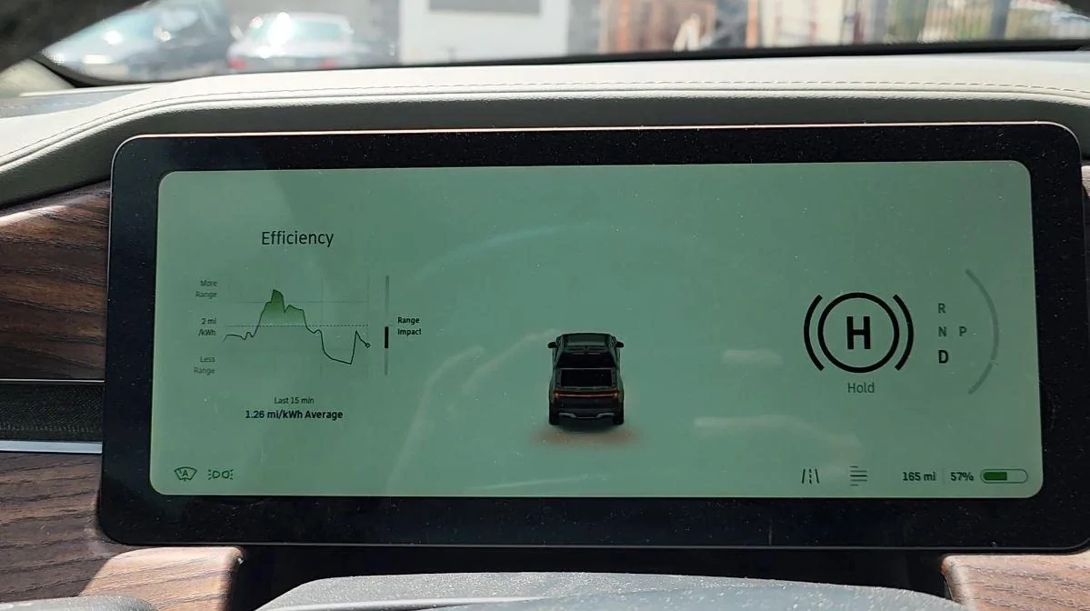

So for people who don't have time for a 10 minute video - who wins? I'm guessing the Ford?
I know how forums and the internet works... I was even nice enough to put the exact time mark in the original post where the pulls happen so you don't have to watch the 10 minute video ;), but I guess reading also eludes those of us in a time crunch :movember:. This one is for you. A little extra information that was not included in the video
Rivian R1T R1S Tug of War on Pavement: R1T vs F350 Tremor Efficiency
Chewy734
Ashu
Nov 8, 2020
1,319
2,733
BMW, Ford, Rivian
Initially the R1T due to instant torque. Then the F350 took over with more lower end/overall torque.
