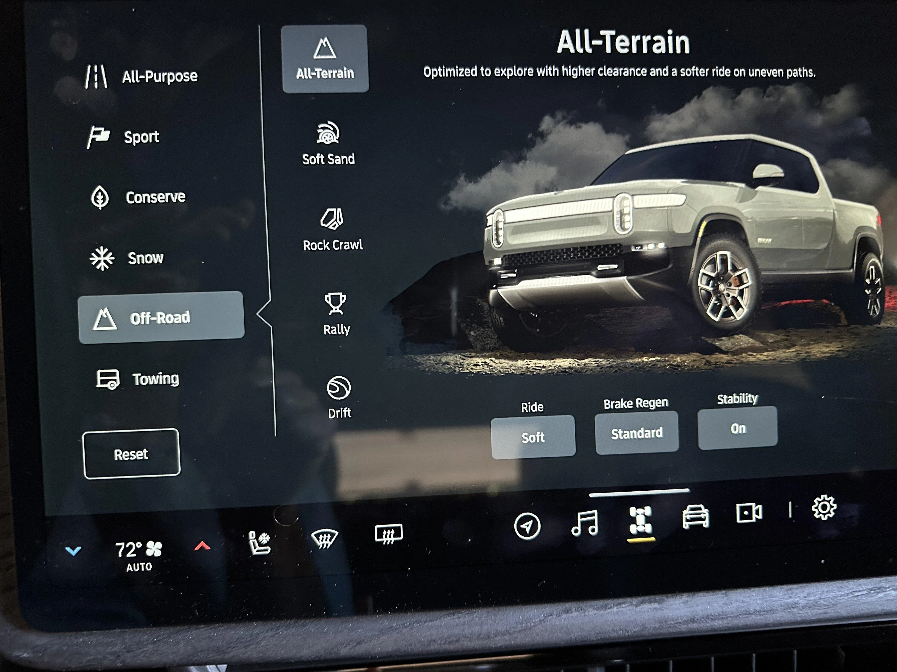

I meant to get it done at 5,000 miles but trips etc got in the way. After a couple road trips past 5K, I. had the tires (20" ATs) rotated (no spare so 4 tire version) just shy of 7K miles. Wear looked minimal and fine.
I don't off road, so far just all purpose, conserve (only on long highway stints in good weather), and towing when towing for drive modes.
The directions to put the truck in "All Terrain" highest had me confused at first as that's not one of the modes. I found "All Terrain" is "Off Road". For those that dont off road this wasnt immediately obvious. I think they should rename that in the settings.
Rivian R1T R1S First tire rotation completed -- my experience IMG_1768
From there picking "Highest" takes a long time to get there. Especially if tire guy is eagerly waiting to get started.

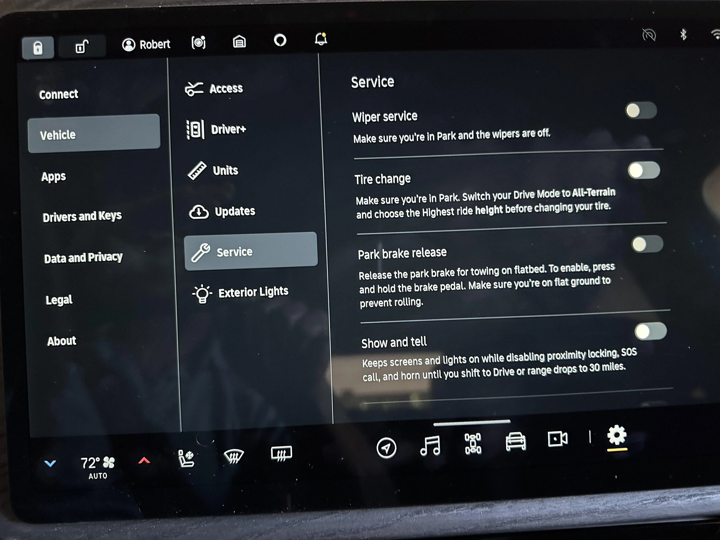

I was unable to swipe the tire change setting under service when at the tire place. I was trying after it was in the highest setting and settled. At home I had no problem engaging it so not sure what was up with that. It just didnt move, no feedback just no swipe detection on that one control. Other UI elements worked as expected.
Just tap, don't swipe.

Yeah did both of those. Front ones didn’t push in and taps and swipes did nothing at the shop. At home tap worked fine.

Glad they took care of you. I just did my second swap at home and just noticed the same nomenclature miscue as well. Surprising they have missed that.

If Rivian knows it has to go into highest, you'd think they'd just incorporate it into the tire change toggle. Tap the toggle -> pop up that states this will raise your Rivian to the highest suspension setting etc. Y/N
