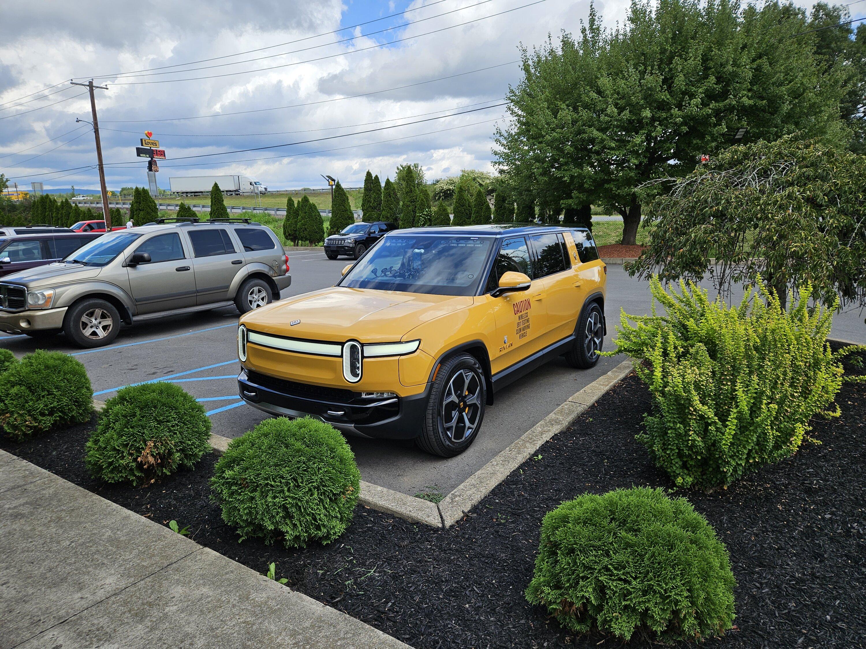

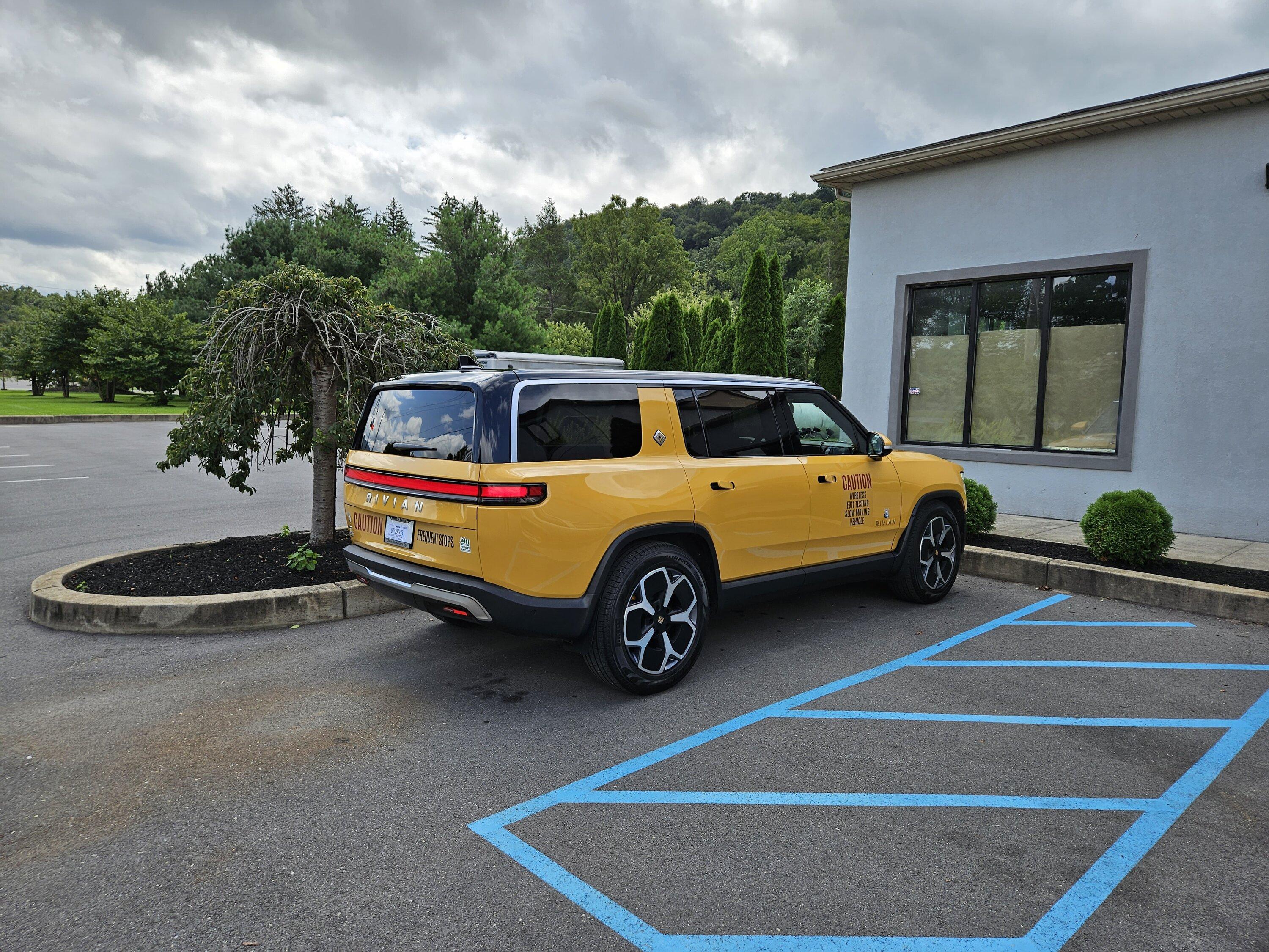

Good to know... My "Tarkus" is three weeks old yesterday with 3.2k miles while drive testing here in PA. Will use the Discount Tires Tire plan I bought for $300 while I'm in Atlanta, GA after Labor Day & 5k miles+... :cool:
Rivian R1T R1S First tire rotation completed -- my experience 20230827_122857
Rivian R1T R1S First tire rotation completed -- my experience 20230827_122838
