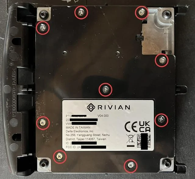

So I like to see how things are built and I figured I should start with the disassembly of phone mag charger. There are other post on how to remove the charger from the arm rest area so I wont post about it. Hope you all enjoy.
Charger removed: Remove Phillips Screws
Rivian R1T R1S Rivian Mag Phone Charger Disassembled IMG_0862

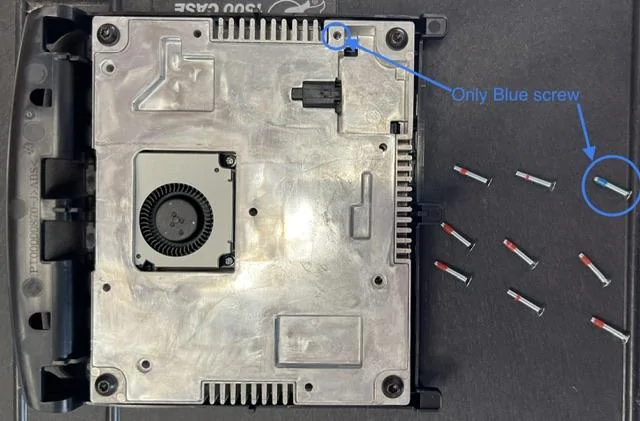

Removed back cove, don’t know why there was only one blue screw:
Rivian R1T R1S Rivian Mag Phone Charger Disassembled IMG_0860

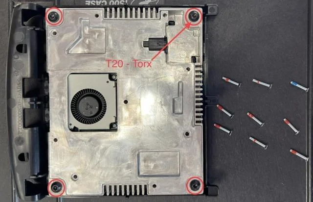

Remove Torx Screws to release plastic cover:
Rivian R1T R1S Rivian Mag Phone Charger Disassembled IMG_0861
Remove back cover:
Rivian R1T R1S Rivian Mag Phone Charger Disassembled IMG_0856

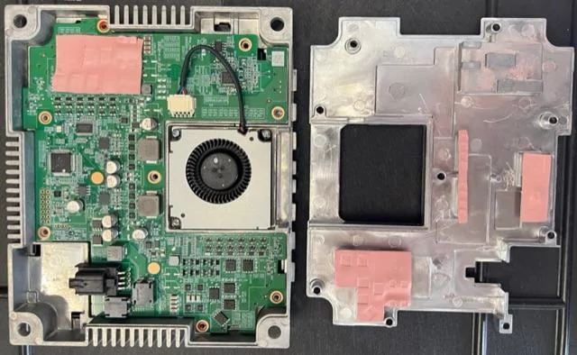

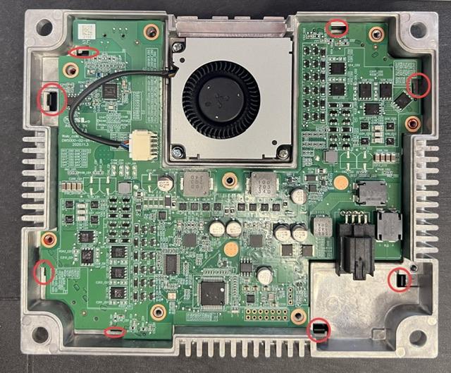

Gently remove clips to get front cover off:
Rivian R1T R1S Rivian Mag Phone Charger Disassembled IMG_0854

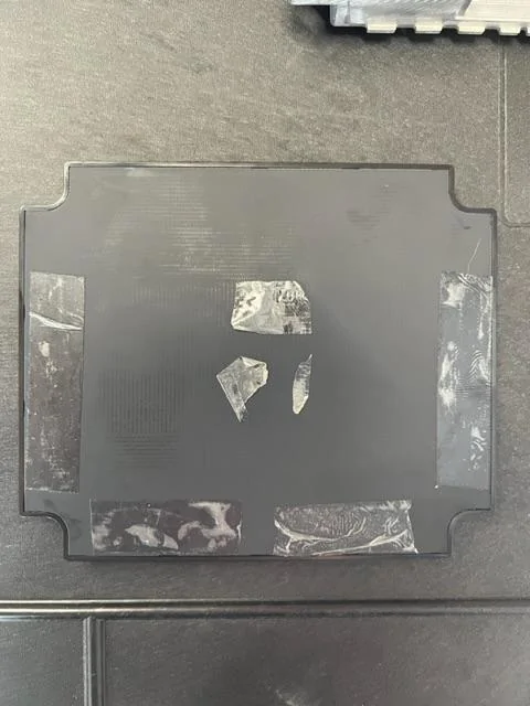

Turn over and remove top cover:
Rivian R1T R1S Rivian Mag Phone Charger Disassembled IMG_0852
Rivian R1T R1S Rivian Mag Phone Charger Disassembled IMG_0851

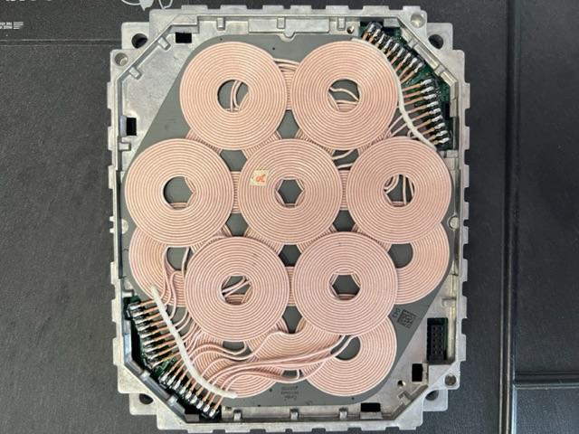

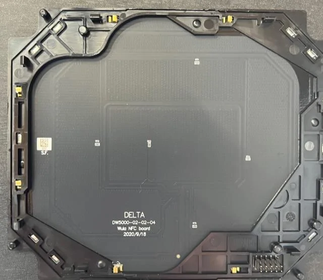

This is the mag charger:
Rivian R1T R1S Rivian Mag Phone Charger Disassembled IMG_0849

It’s amazing that with all those coils, I still can‘t charge my phone. It’s almost as though this wasn’t tested at all. Rivian needs to provide free update to a working version when available.

Sure 17 from what I can see in coils.

I count 18 pairs of connecting wires (9 pairs on the top right, 9 pairs on the lower left) so 18 coils in total I guess? Don't see anything other than coils on that side of the case.
Thanks for the teardown!

Instead of designing a surface for a phone to not slide all over the place on or support for magnetic charging it seems that their solution was to try and pack as many induction coils in there as possible forgetting that it would have to stop and restart charging every single time it moved rendering it basically useless.
I bought one of those aftermarket ones with the magnetic support and that's what the truck should have had from the beginning.
