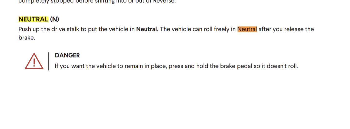

I'm in this right now. Drive motor failure. Tow truck can't get to me because of boulder obstacle. Can't pull it out because I can't get it into neutral.
Does anybody know if there is a way to get into neutral (the car wash mode setting doesn't do the trick)?
Check owners manual but should be this?

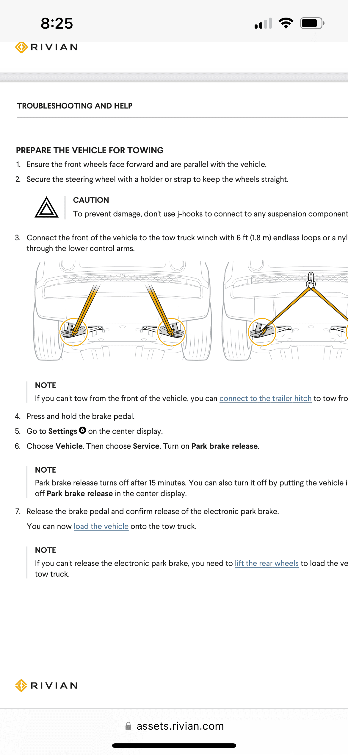

Rivian R1T R1S [Update: Made It Out!] Drive Motor Failure During Off-roading Excursion Through Water Crossing 41825A14-B195-4A6C-8108-5D63749D09B8
Steps 4,5,6 may help you turn off the parking brake. Good luck out there.

Curious, why not use the front tow hooks instead of tying straps to the suspension components?
Tow hooks are technically optional but I don't know if Rivian has actually made a vehicle without them yet?
Yeah, my guess is the manual was written in consideration of then optional tow hooks, and never updated after tow hooks have apparently become standard equipment.

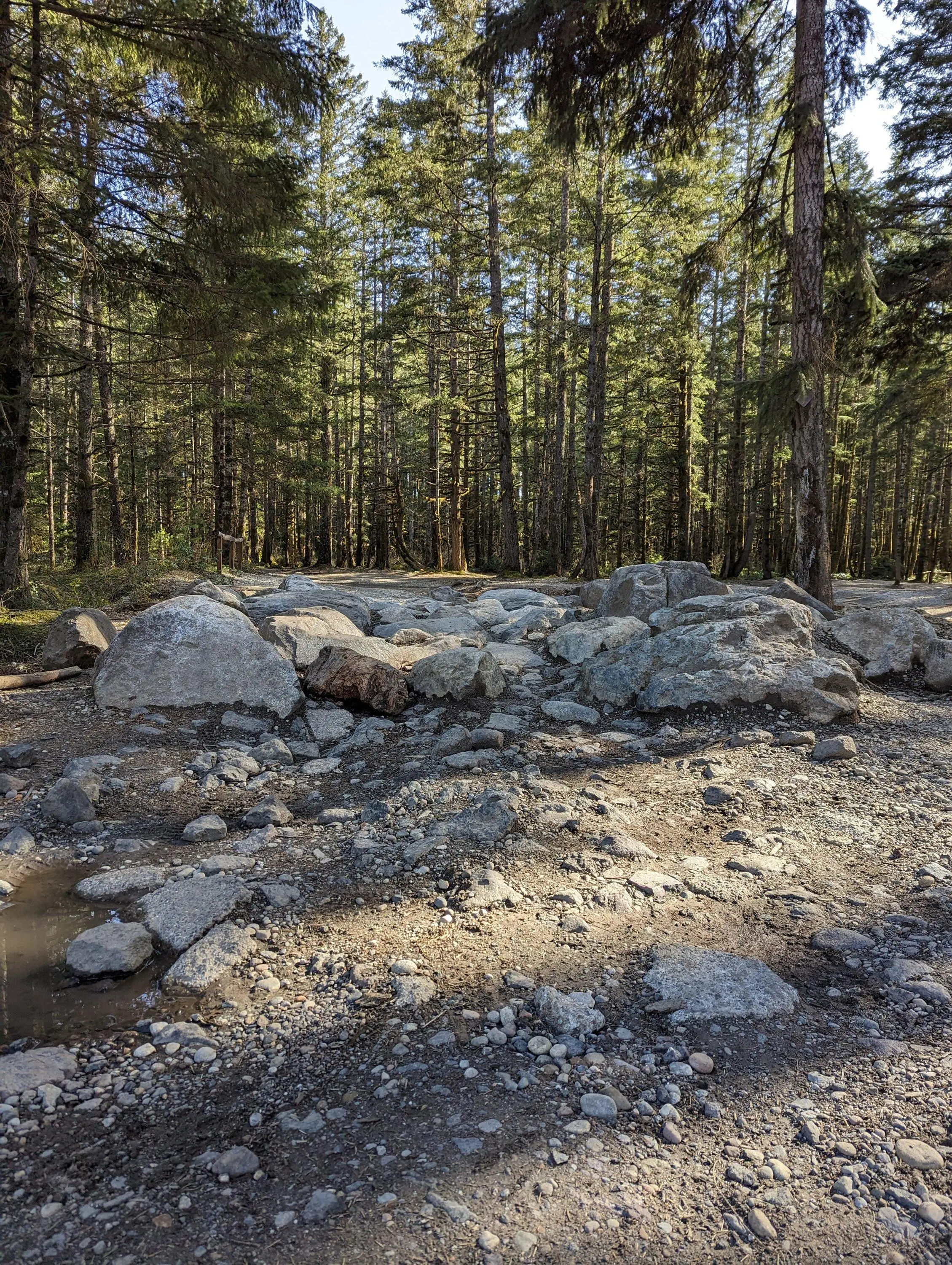

Still waiting for the tow. Next challenge is going to be getting the recovery truck (F-250) over a boulder obstacle. The tow driver is a bit worried that he may not clear the obstacle with his truck. Then, the challenge will be for us to winch the R1T over the boulder obstacle. The flatbed will be waiting on the other side, but, goodness, winching my truck over the rocks has me tense.
