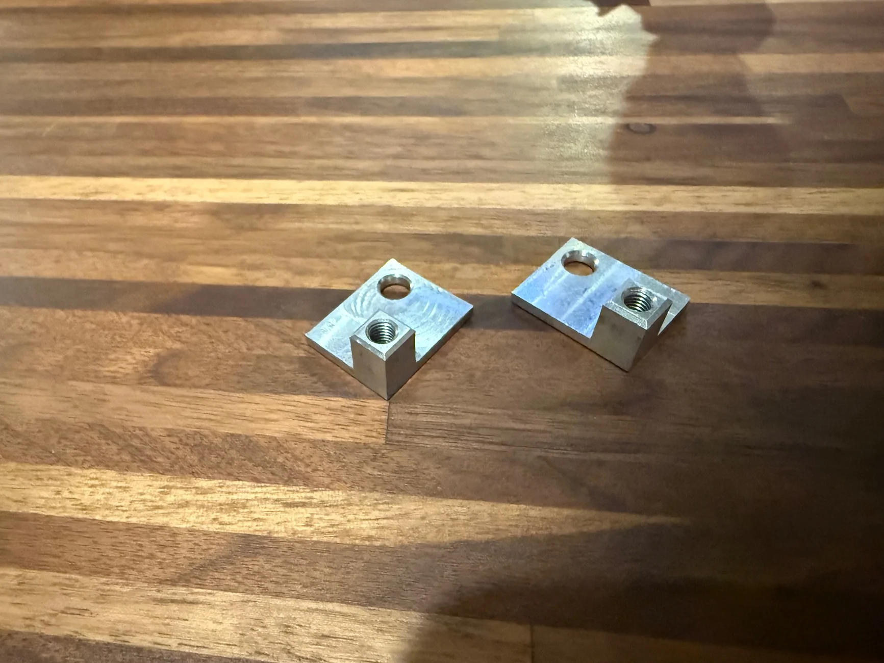

You will need an adapter to move the terminals. Like these:
Rivian R1T R1S 12v Lead Acid Battery Replacement IMG_2225
If you look at the Rivian battery they are in an odd space.
Where does one get those battery adapter? Are four needed for the 2022 or early 2023 R1T with two 12 volts?

Tomorrow from us at soonishev.com. I am going to be posting a couple of new items tomorrow.
4 for Gen1's with two batteries.

Ordered! You're a gentleman and a scholar saving us from an expensive service appointment and overpriced AGM batteries.
I ordered two sets, I assume that's four based on the language on the store page?
