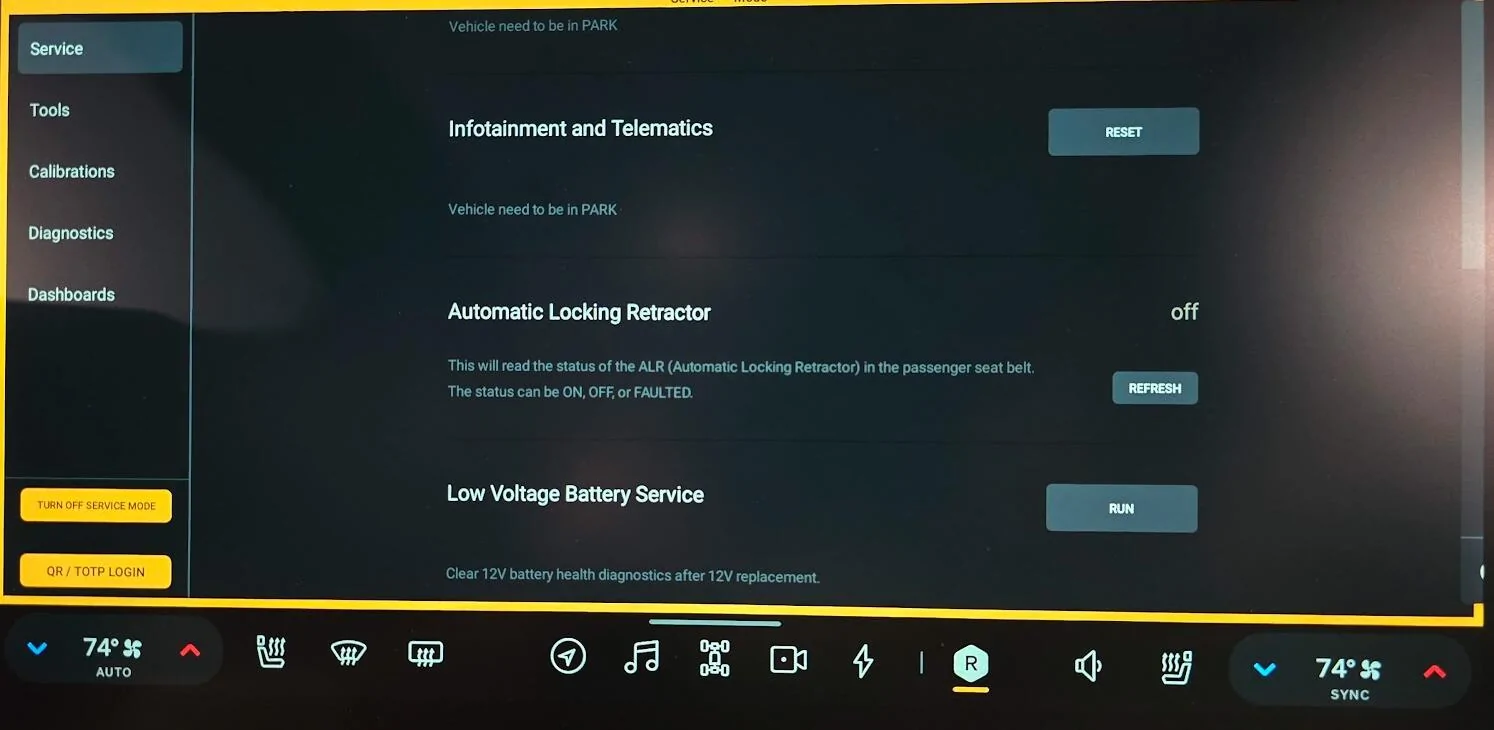

When I saw all the diagnostic screens on my mobile-tech's laptop after installing new 12v batteries (dual), I think I understand why they want to discourage owner-installed batteries.
In all fairness, there IS an option in the service menu exclusively for 12V batt replacement. I would probably suspect that it shouldn't be a big deal to DIY BUT, also understand the many more things a tech can check with the proper software :)
EDIT: Here's the image that I saw and took a picture.
