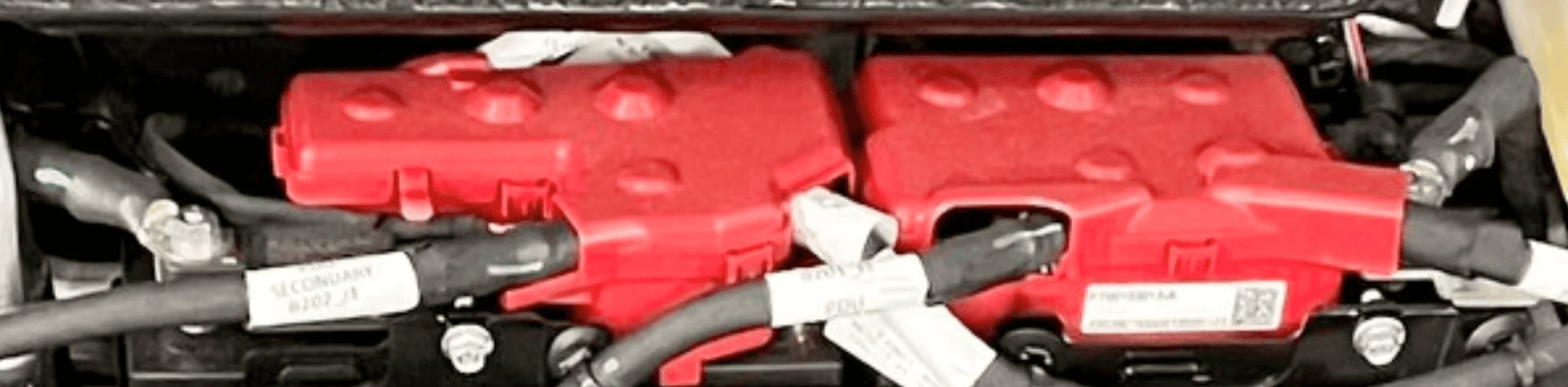

Believe your eyes. They clearly have 6 cells.
You are able determine 6 cells in the photo I posted, or another photo? The red covers are electrical safety guards, different size and shape on each battery. Not sure how that is indicative of number of cells.
I lean in the direction that they are 12v batteries, but I accept the possibility that they are 6v.

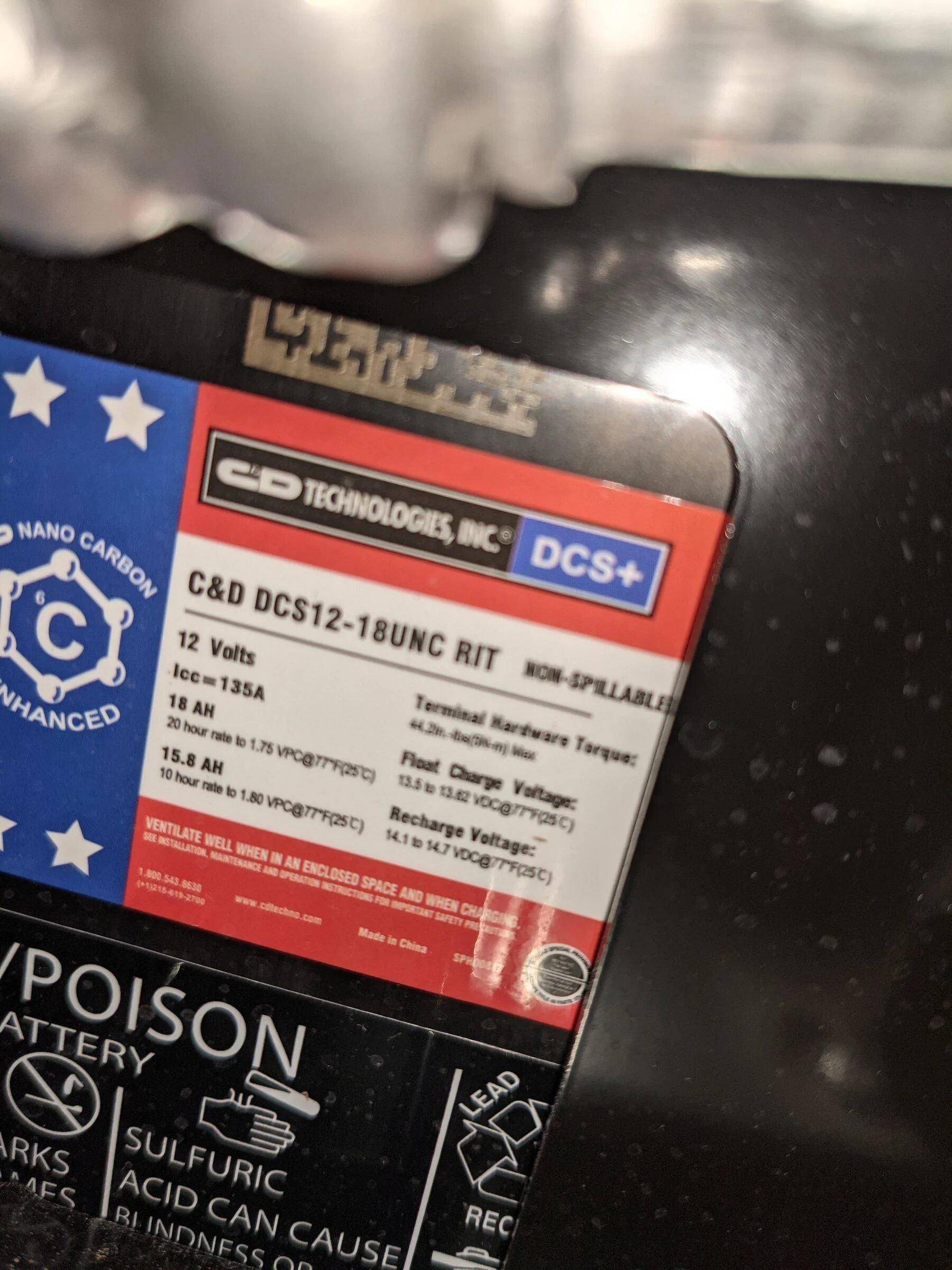

PUT THE NAIL IN THE COFFIN. IT'S 2 12V BATTERIES, LADIES AND GENTLEMEN.
Rivian R1T R1S 12 volt concerns PXL_20220426_230452328
I don't understand this but okay.

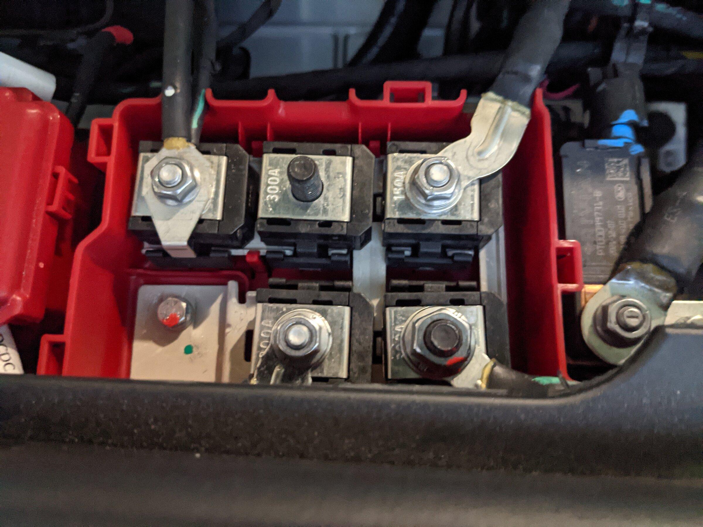

Awesome, thanks for clearing that up!! Deep Cycle Batteries.
2nd pic are fuses.

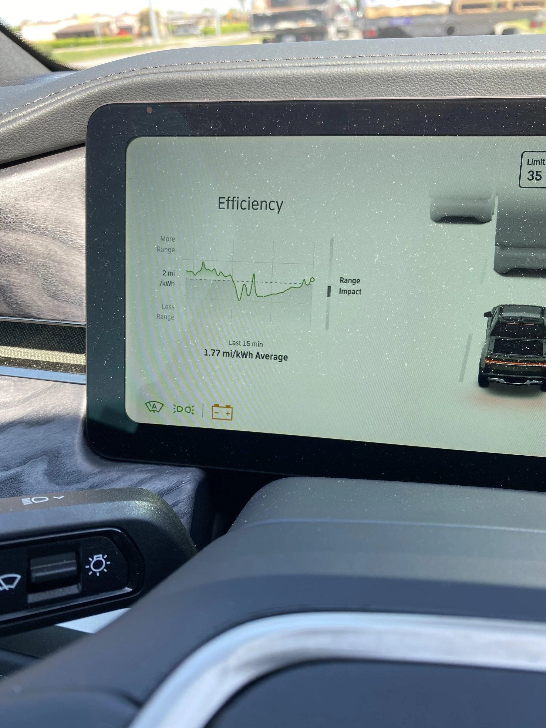

On the topic of 12v batteries, I had this warning light come on today
I was en route to an appointment and continued on for a few miles. Left the truck for about 30 minutes afraid I was going to be in trouble when I got back in but the battery icon was gone.
I called Rivian service before departing and they stated the icon indicated a detected difference in voltage between the two 12v batteries (?), that a sleep cycle while I had been away from the vehicle resolved the issue/cleared the message, and that it was nothing to worry about. I gathered that I was not the first to experience this.
