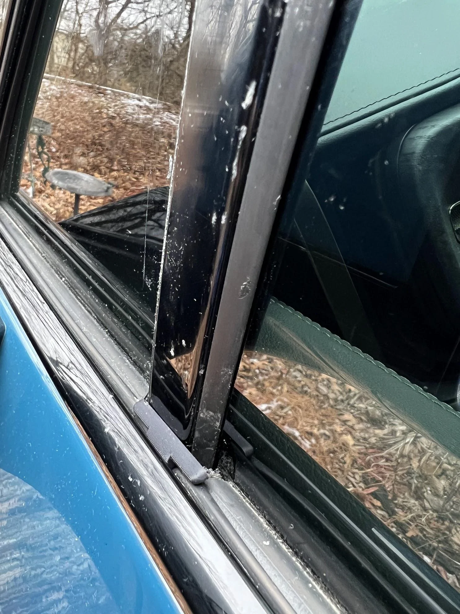

Yet again I'm sharing something silly I made, in case someone finds it useful. Over the course of many miles I'm pretty sure there is either a seal issue _or_ just the tip of the top of the tiny triangle window applique causes the whistling noise on my drivers' side. Either way, it is slightly annoying.
I had been using electrical tape for 17,000-ish miles, and I never find the time to actually take it into the service center to correct the root issue. (Also I hear the triangle window replacement doesn't even work some of the time). I decided today that I wanted something less hideous than black tape on my truck.
I measured the little plastic thinger and CAD'd up a couple of shims that push it firmly against the truck. These have successfully eliminated the noise on my truck.
The models are available on printables.com here: https://www.printables.com/model/363550-rivian-drivers-side-wind-noise-maybe-fix

Nothing was loose, per-se. I had taped around the perimeter of the entire triangle because I was sick of trying to figure out the cause. It was *much* more pronounced/noisy when I had a right-to-left crosswind, for whatever reason.
Regardless, I drove excessively fast with the shims in yesterday (for science) and the noise is gone.

I haven't had a crosswind to test yet, but it just made the existing noise worse, so I suspect it will no longer be an issue. I've heard folks mention it is a sealing issue, and there is prob some kind of Âżlow pressure zone or vortex? (i'm know zero about aerodynamics) formed on drivers side in a crosswind that makes the seal issue worse. By forcing the applique against the glass, I may just be forcing the seal to be tighter. Not sure, but mostly don't care - just want the noise to not be there so I can listen to my podcasts, like you. :)

I had the seals replaced on my truck (I'm mid 2000s VIN), the earlier models were multi-part, the new seals are one piece. Had them do both the triangle window and the main window seal at the same time, totally fixed my issue. If you go for the service, make sure they do *both* the triangle window and the full window as well.
