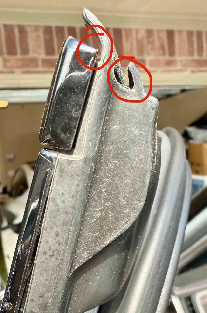

This might be the best improvement of any single change I've done. I filled both of these grooves with uxcell EPDM foam tubing. Don't ask me what sizes as they were left over pieces I had. One wasn't long enough to go the entire way but covered about 95% of it. I think the smaller one was about 3mm and the other was about 4 or 5mm. I basically bought ever size of 2mm to 10mm to work over my truck.

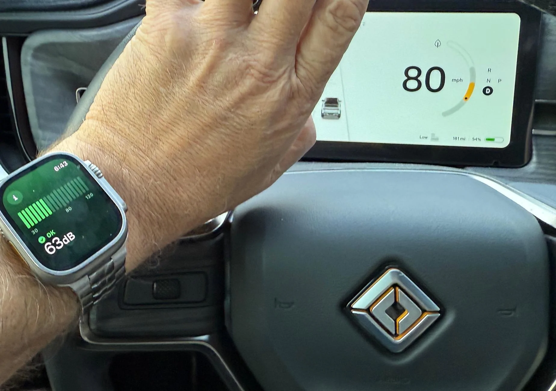

For reference, on my appl watch, with my hand at the 10 o'clock position, I was reading 63-64 db. I need to make some runs with NIOSH SLM which I find to be more accurate but as a reference, my sound level is down about 1 db from where I was at previously when traveling at 75 mph. So I am going faster, and it is still is quieter. The trend is in the right direction.

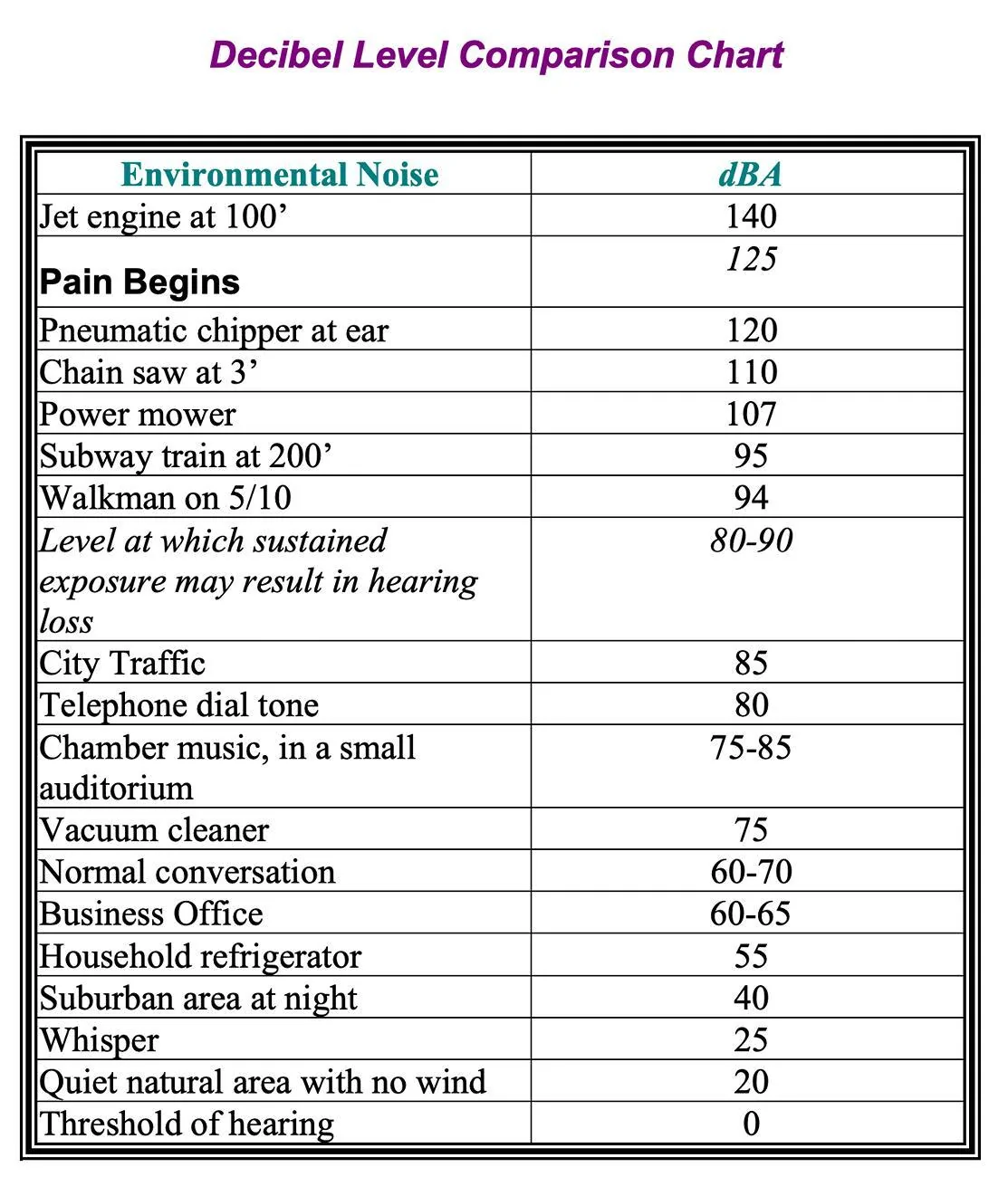

For reference, here is a noise level chart from Yale.
