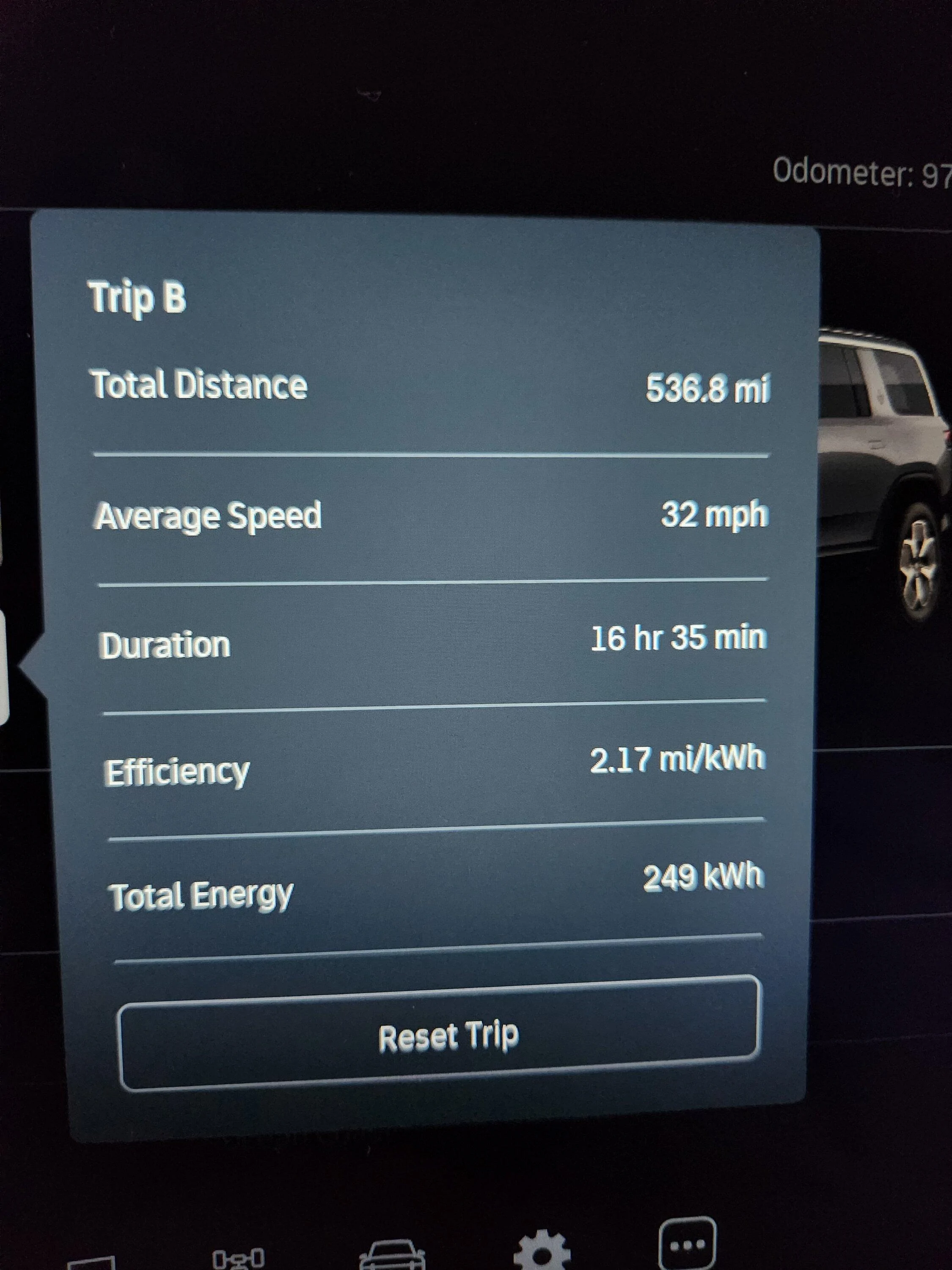

Software
Here are two of mine. Both are a mix of freeway and city.
R1S 21" Road tires, 49PSI cold pressure. Feather foor driving.
#1 Lynnwood to Auburn,WA
#2 Auburn to Ashford WA
21s
50% of the mileage so far
Rivian R1T R1S What's your average Miles/Kwh? 20230704_213142

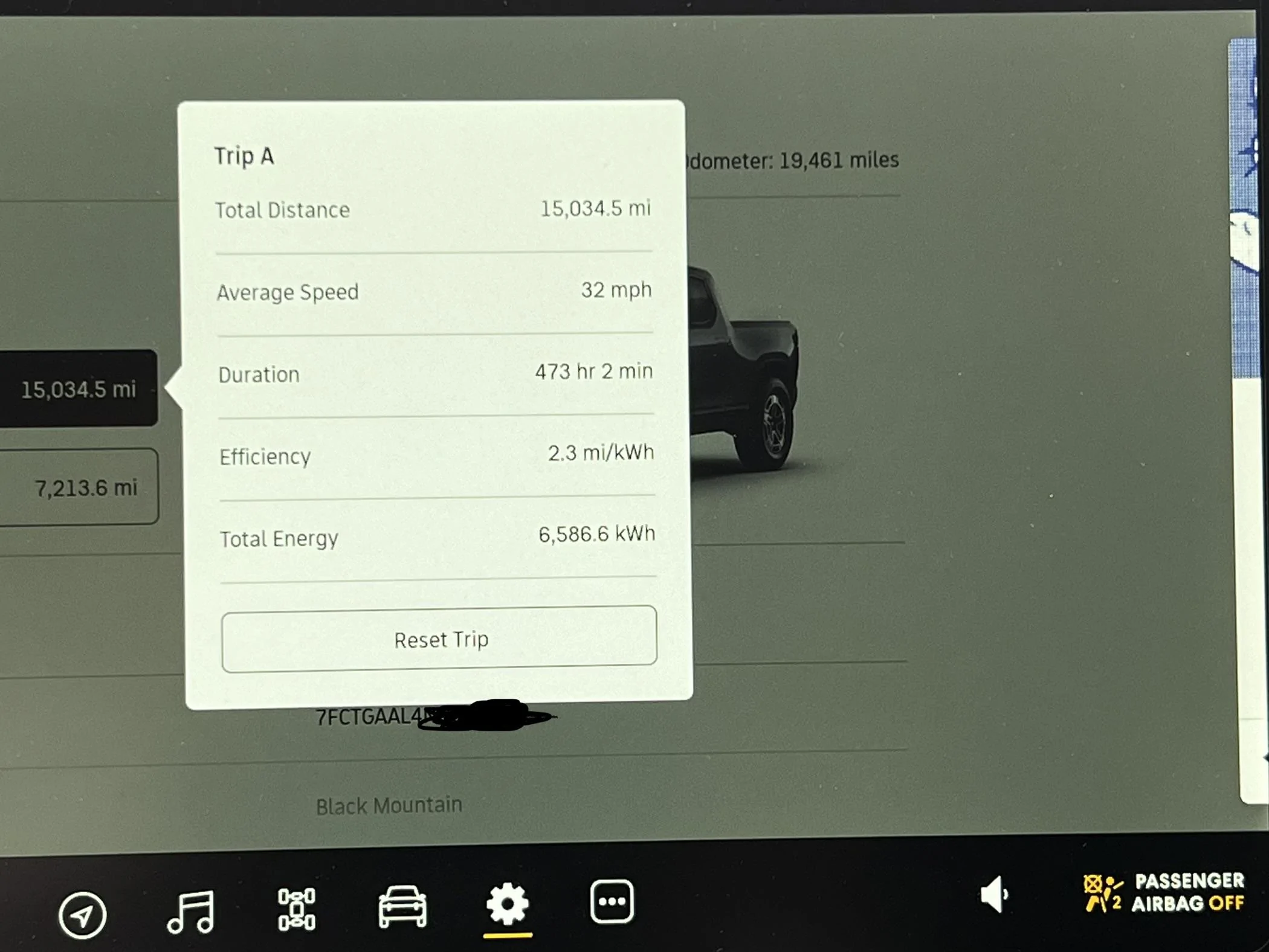

goldburger
Feb 5, 2022
1,734
2,041
Love having 21’s. Really great. ?
Rivian R1T R1S What's your average Miles/Kwh? IMG_8532
