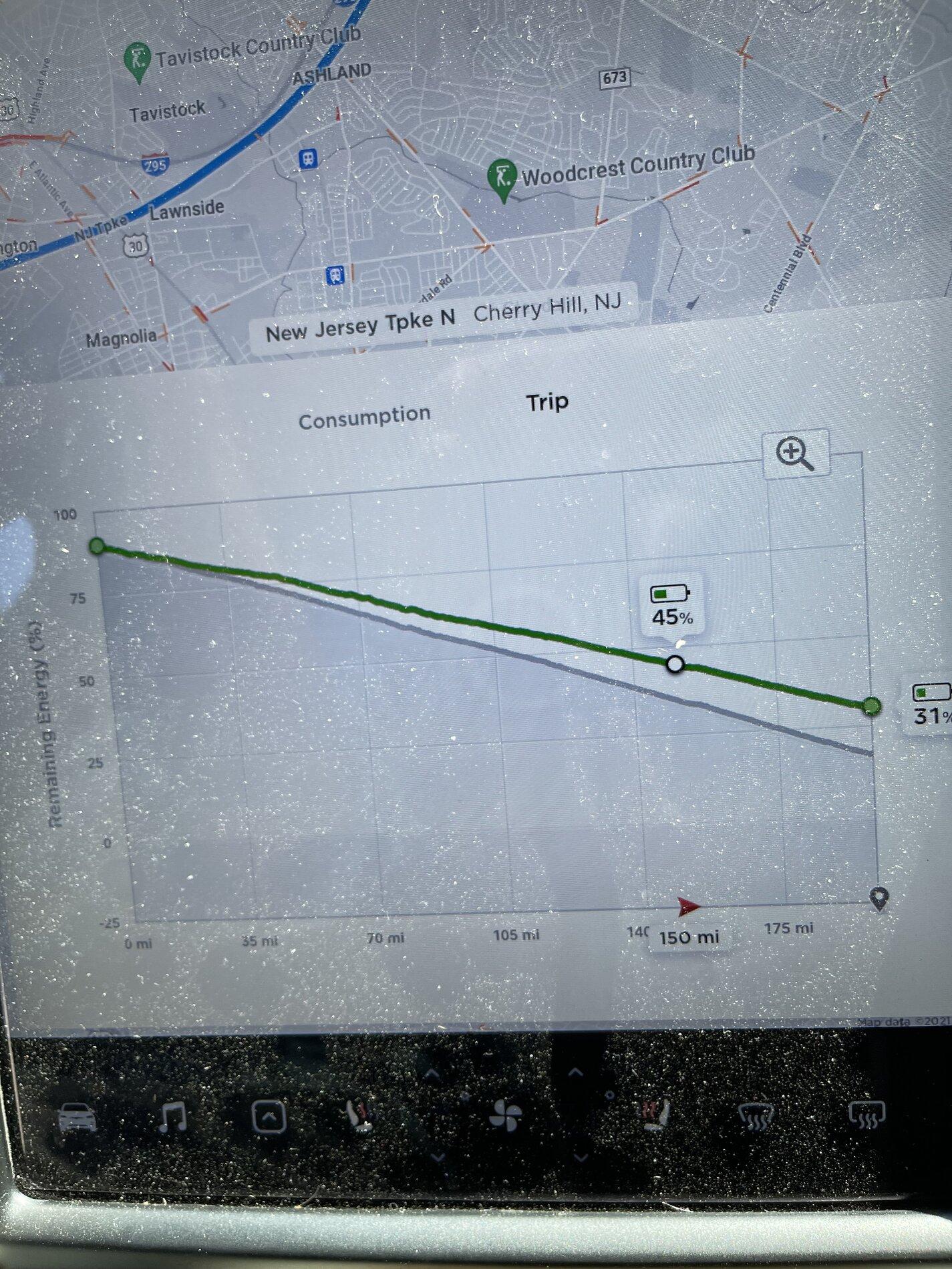

A pilot knows how many gph his plane burns and what it's airspeed (TAS) is and picks an altitude where the wind speed is such that his ground speed is sufficient to get him to his destination with a comfortable reserve. A BEV driver knows how many Wh/mi his car burns when there is no wind an recognizes that head winds don't change his ground speed but that they increase the Wh/mi he will consume. He knows that he may not make it to his destination unless he can lower than Wh/mi number (which he does by slowing down) or can refuel.
Most of you don't want to mess with any of the stuff I have just described and so the car gives you a display like this one:
Rivian R1T R1S What would you do? Get LE version (300+) or wait for MaxPack (400+)? IMG_1580
The gray line shows how much energy the car thought would be used in accomplishing this trip - that you will start out with about 80% charge and arrive with about 20%. Note that the line is not of constant slope because the navigation system knows where you are planning to go, that the speed limits vary and that the terrain isn't level. Sometimes the jogs in the line are much more dramatic than they are in this example.
The heavy red line shows the actual trip consumption history up to the open circle (your location) and a projection based on recent history beyond that point out to the destination. In this case the first 20 or so miles confirmed the original prediction but at that point it starts to become clear that you are really going to do better than the early prediction and at 150 miles you have obviously done quite a bit better than originally thought. Consequently the prediction for the destination is much better than the planner originally said things would be. The planner would use the rated range adjusted for terrain and speed limit to make its prediction of 20% SoC at the destination so obviously the rated range is not the appropriate range to use here. Why not? Probably, in this case, because of a tail wind but a more conservative than average driver might be the answer too. Were I to drive this route a month or even a day later the result might be substantially different. Your job is to observe what conditions lead to better and what conditions lead to worse performance. Or at least to understand what you need to do if the red meatball dips beneath 0 at the destination end of the plot.
There is much more detail on this plot in another thread but the essence is somewhat obscured in that thread by extensive discussion about what the planning system can and cannot know a priori.
The obvious assumption in all of this is that the Rivians will have a similar display as I think they must.

It's inherent with this sort of estimator that it is always going to be right at the end. The real question is as to whether being told before setting out you will have 37 miles range left at destination you can be assured that you will in fact have 37 miles range when you get there. No display can do that because it can't know that it might start raining heavily or that a head wind might spring up mid trip. It is the job of this graph to let you know if something that does impact end SoC comes up in enough time that you can do something about it if that's necessary.
That's especially the case when doing what you've laid out, that of maintaining a fairly constant speed in a highway setting.
This example picture shows that the story based on the first 20 miles can be deceptive with regard to the rest of the trip (especially if it is a long one). But note that just as this display can warn you that you had better slow down and/or charge sooner than plan it tells us, in cases like this example, that we could, on observing the more favorable than anticipated consumption at, say the 35 mile point, dial another 10 mph into the auto pilot. This means more consumption so as we drive at this higher speed the red line slope increases and the red meatball starts to descend the right axis. If it stabilizes at a lower SoC value lower than we are comfortable with we just dial the autopilot back a bit. Getting used to this is what requires the experience and some thought.
