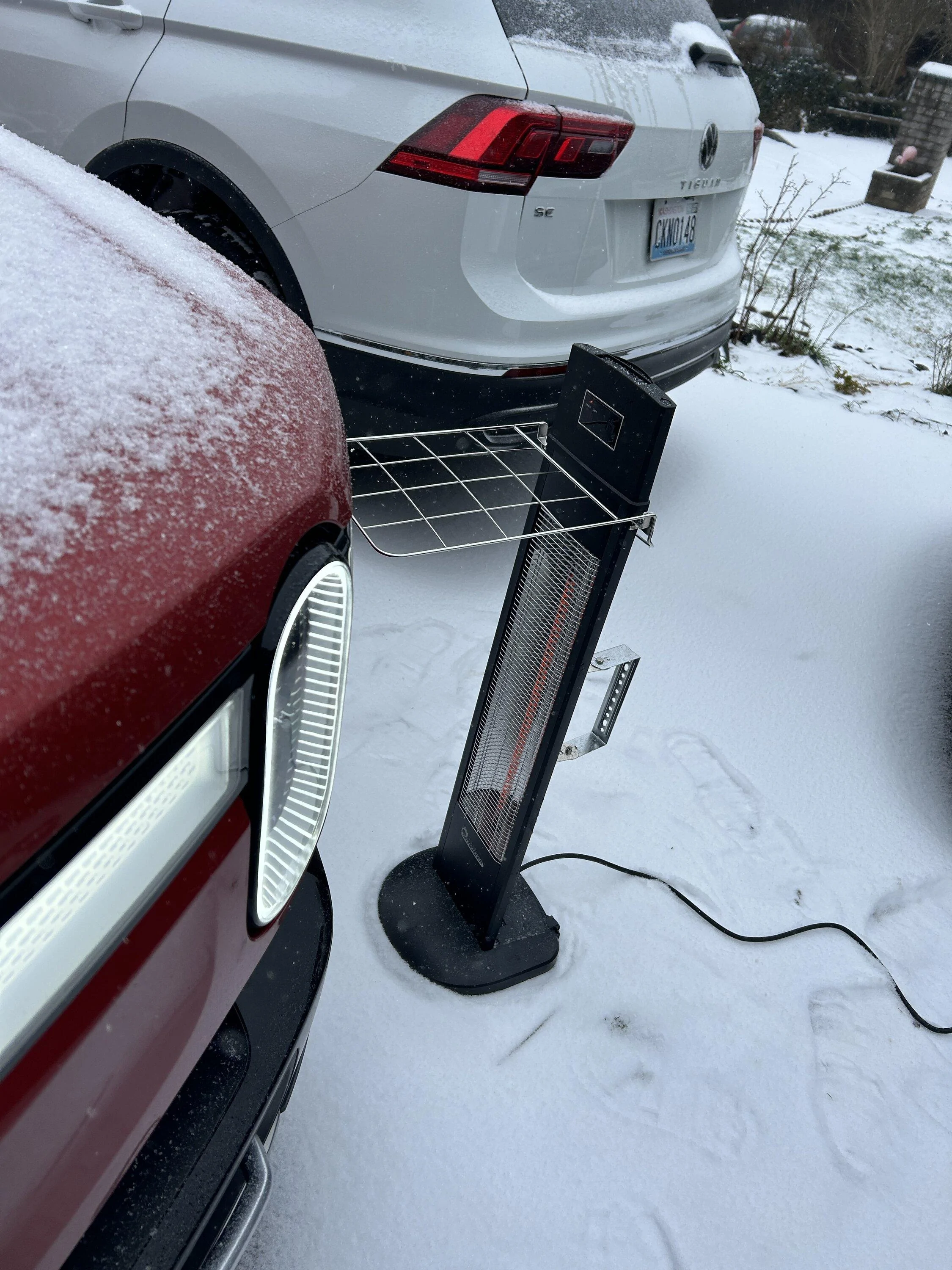

I took a picture of my fix. I had the same issue.
I left it for 30 minutes
edit: also, know that once it came open it didn’t refreeze. I can now open close after going on a drive.

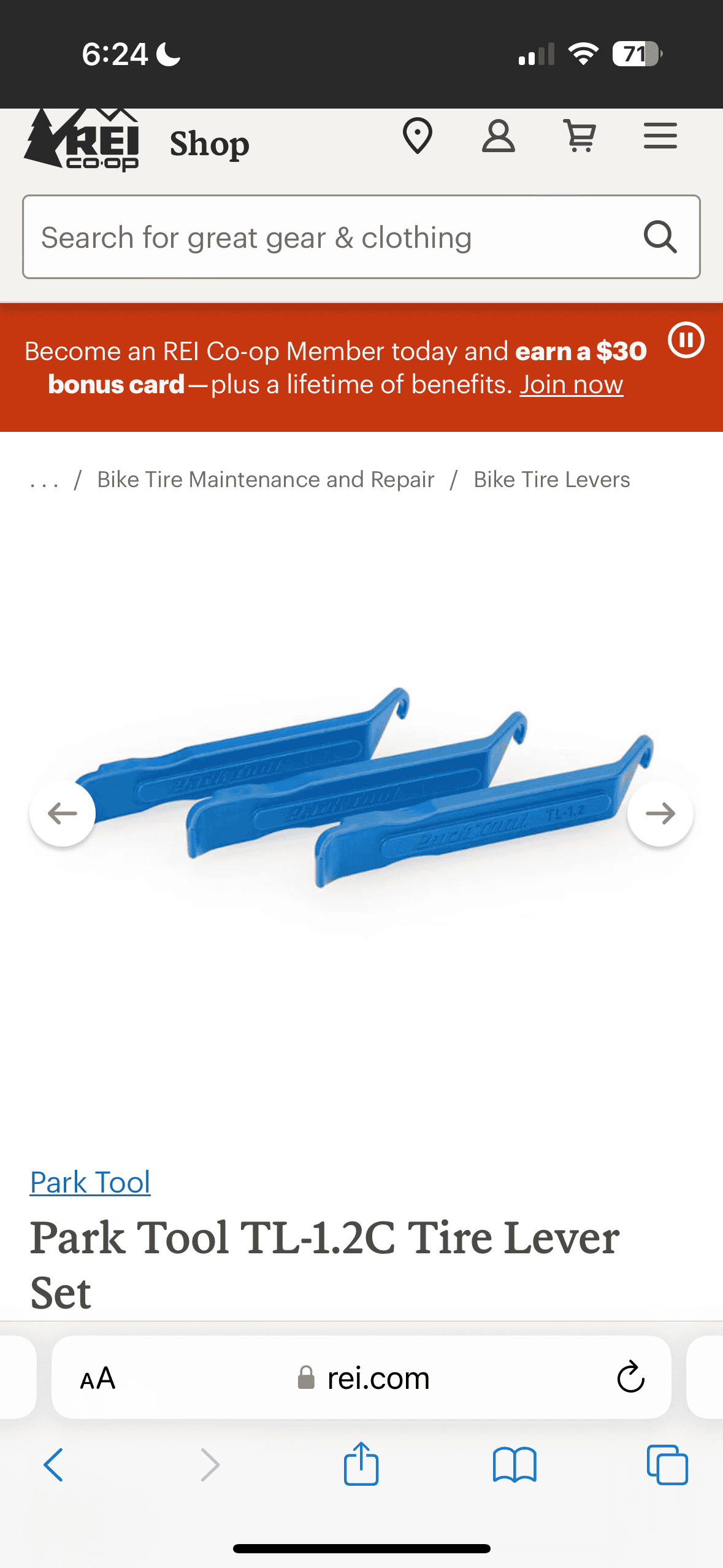

Mine was unresponsive to both the inside and outside buttons. I used bicycle tire wrenches to force it open several times. The wrenches are plastic and did not harm the paint. I keep them in the vehicle for just this reason. I silicon spray lubricated the actuator shaft and it is now working fine but Rivian is replacing the part this week under warranty.

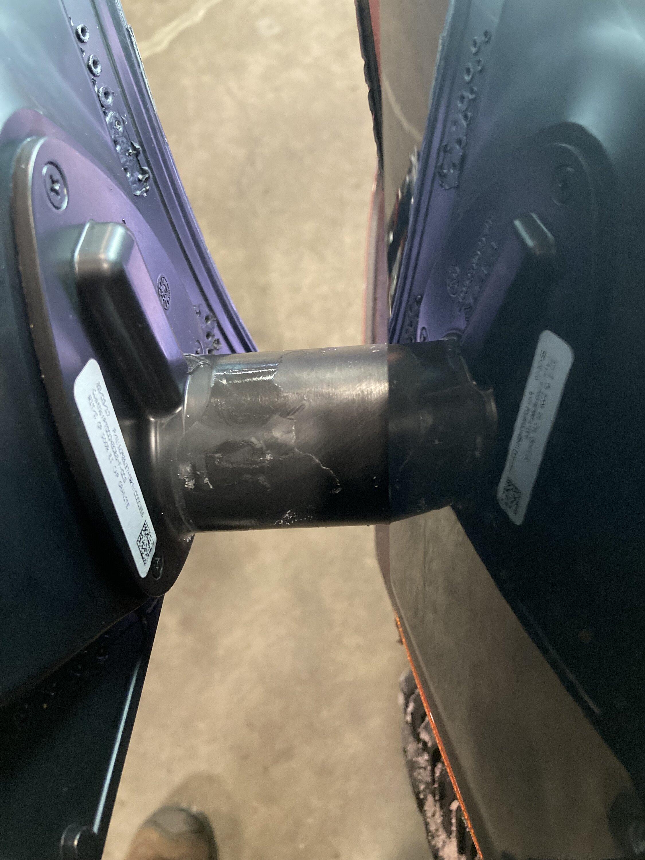

I got it open.
The exterior button was button working as I could hear the motor actuating. I tried gently nudging it but really didn't want to force it. I thought about pouring warm water over it but did not want to indroduce any more moisture into the situation. I tried heating the cab. No good. I tried holding a hot water bottle against the panel but that didn't work either.
I decided to drive down to my shop where I could set up a radiant heater to warm up the whole corner of the truck, like @W1SE did.. It's about a 15 minute drive and when I got there I immediately tried the port and it opened! It seems that the warmth from the drive motors and the cooling system under the frunk were enough to warm it up. Once I got it open, I used a heat gun to melt the frost, wiped every thing down and spayed a little WD-40 on the port door shaft (Y'all remember what the 'WD' stands for, right?). I was also able to use the heat gun to get the tailgate open. It was ice along the entire rear seal. The mechanisms seemed to be working fine.
The issue was definitely the shaft. You can see the ice on it here:
Rivian R1T R1S Cold snap - Can't get charge port door open IMG_1822
It's unfortunate that moisture could get into the mechanism that far.
