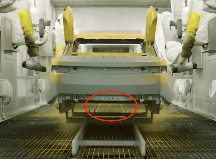

I did notice the floor grating looked new at the start of the video. Maybe it’s serial #00001?
I’m not sure that is the first run through. If you look at the first frame of the video, there is yellow paint on the grate ahead of the truck. Plus the thin tracks that the truck is mounted to (moving along the floor between the grates) look like they are already yellow as well. I could be wrong though since I’m slightly colorblind haha.
Also, what are the chances they have multiple paint booths set up? The equipment is probably very expensive, but they should have multiple set up for higher production volume and less cleaning/swapping paint. Not to mention if one had a failure, it would halt production. Again, I could be wrong though!

There was definitely paint on the floor already. You can see yellow on the floor in front of the sled.
I don’t know the in-depth process, but most of these new paints, especially in the US are now water based. If this paint booth, paints say 1,000 vehicles a day, you would eventually have large build up on this floor grading. I would imagine, if it’s water based, they can wash it off at certain time intervals and capture/re-process. All the environmental steps RJ has discussed, down to small parts shipping bins using ocean plastics, there’s probably not a lot of waste products from the painting process.
I used to work in Fanuc's paint system department. This looks like a bog standard paint booth to me. The grates are usually replaced once buildup is significant, cleaning them off is a waste of resources.
Somehow, I don't think we're anywhere near needing to worry about buildup at current rates...
