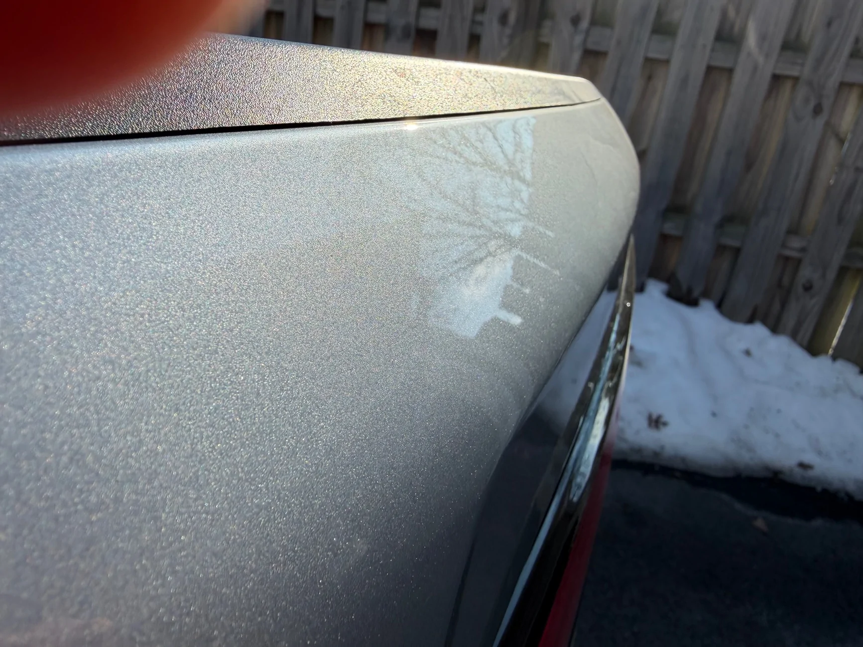

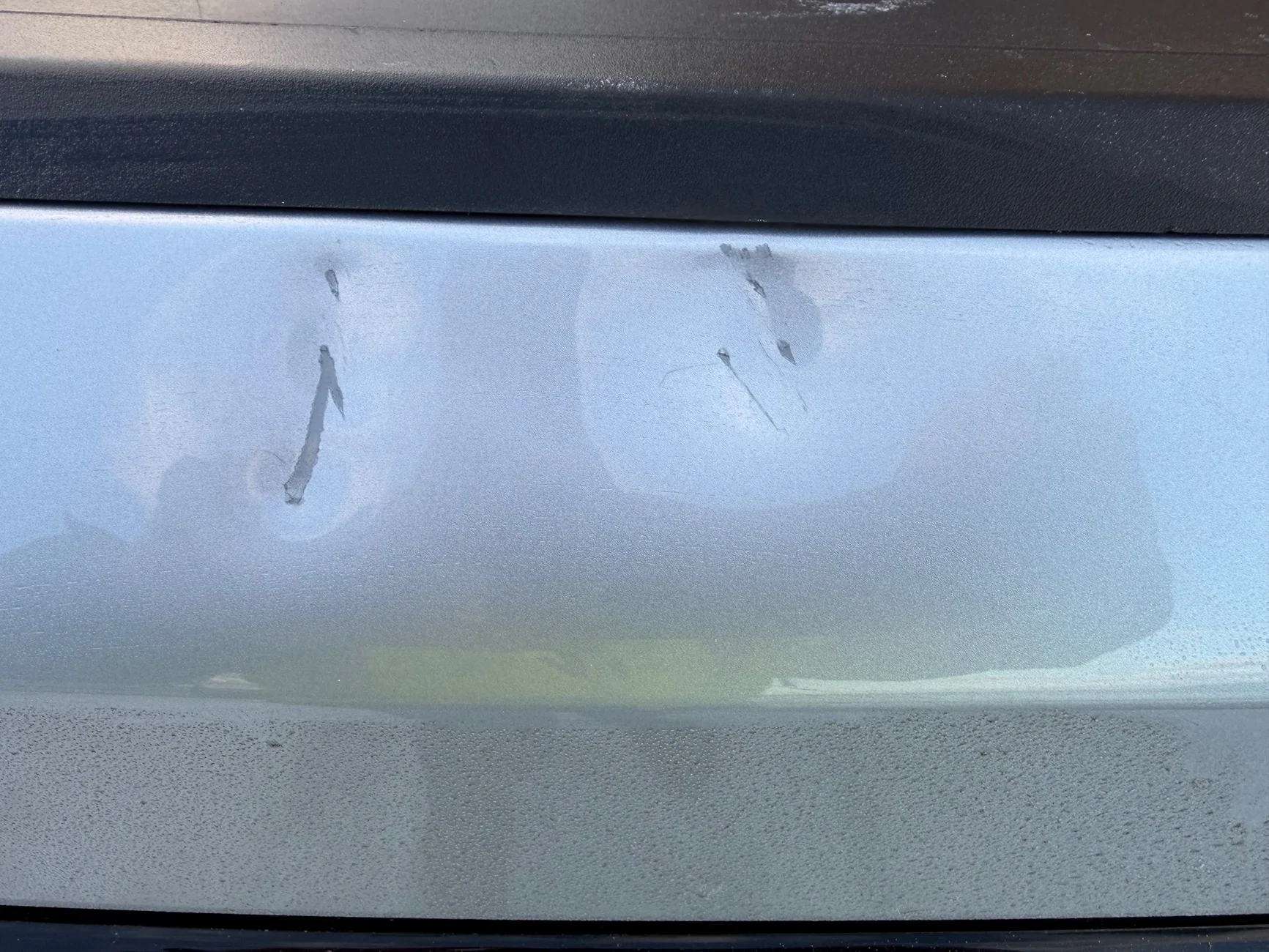

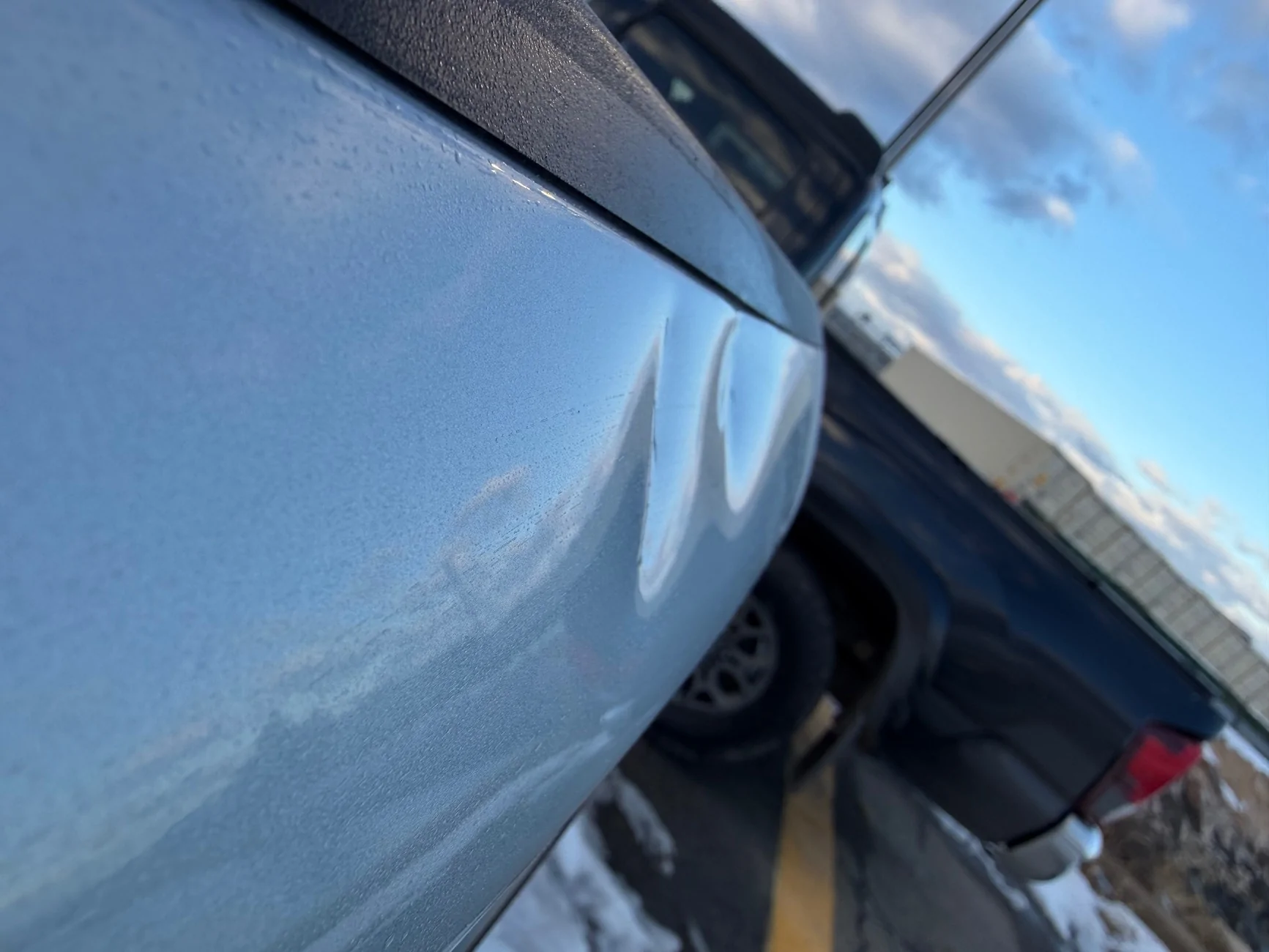

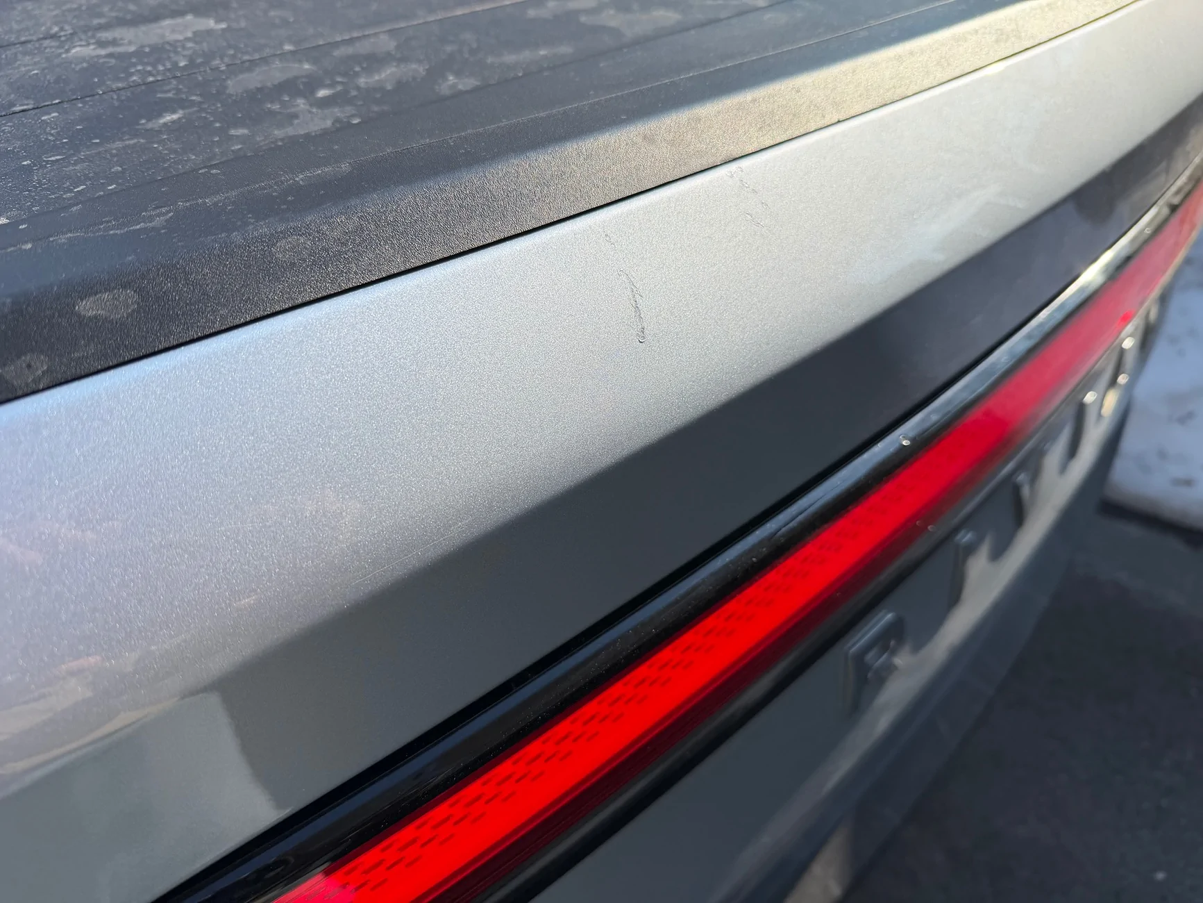

It’s aluminum. I had a PDR repair done recently and the guy was fantastic. You’re not far from me. If you’re interested in the guy I used, lmk. I’ll send his info over. Here are some before and afters of the work he did for me.

Wow, that's a great job!
I thought I read somewhere that the tailgate has a lot of plastic reinforcement inside, and makes it tough for PDR, but that is perfect.

Access on the aluminum tailgate is easy; the metal is the hard part. Aluminum doesn’t spring back like steel, so the tech has to shape it, and it work‑hardens fast, which limits clean pushes. That’s why glue pulls are standard on aluminum, and creases take more skill. Not impossible, just less forgiving.
