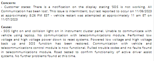

Are you getting an SOS error? Navigation not working?
I had this happen on my vehicle and tried a soft reboot, hard reboot (didn't reboot), and sleep reboot as recommended by the person on the Rivian chat. They also tried to connect and reboot but couldn't connect.
I had to make a SC appointment and it appears they disconnected and reconnected the 12v and then the communication module started working again.
Here is the notes on the invoice
Rivian R1T R1S Truck won't connect to 5G or Wifi?? Also won't hard reboot. 1701436753532

My SOS button isn't working either with a notification. Mine seems to mostly match this scenario. Navigation I think still works, but otherwise the same. Truck still won't reboot. Crap, guess that means I have to deal with a service call. No fun. Since it won't connect to the internet, no app access, which also means it won't be able to download an over-the-air update. Will probably have to wait a week or two as I don't have 6 hours to kill on two round trips down to the service center, but will give them a call.

Communications module failure?

Definetely the TMC. Had same symptoms
