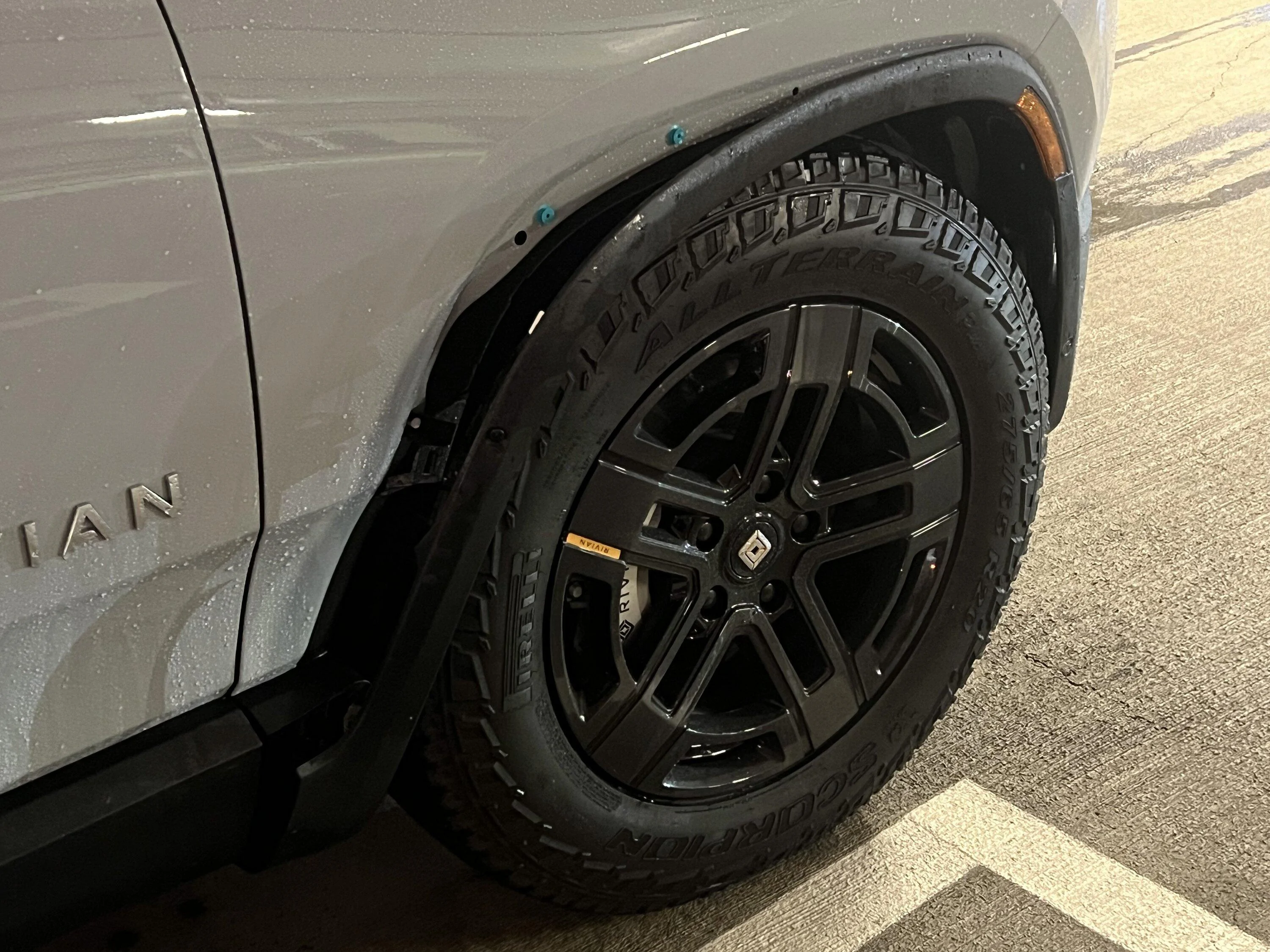

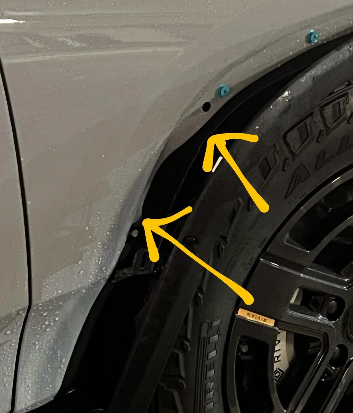

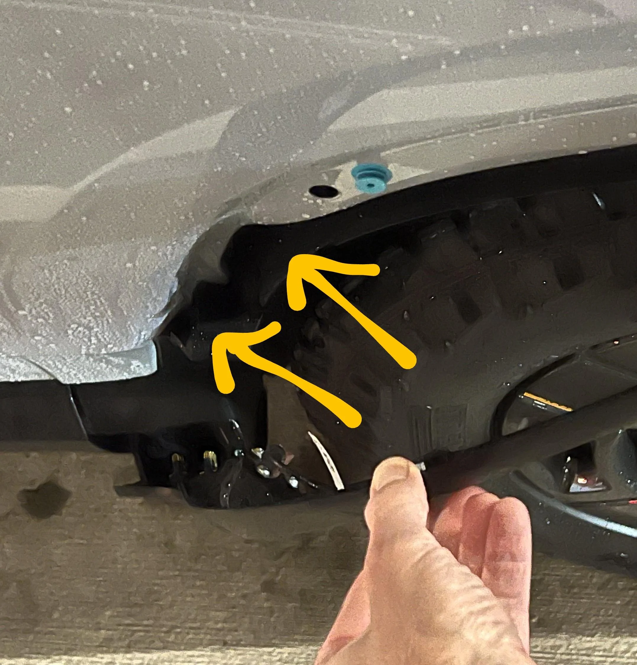

Found this when I got to the office after a rainy commute. Apparently the water spraying into the wheel well from an ordinary puddle on a paved road dislodged the fender flare. The camera still works but the alignment is off because I can’t figure out how to secure it completey - any tips would be helpful. I can’t seem to move the piece far enough forward so I can slide the connectors back into the blue pegs/clips. I opened a warranty claim ticket with Rivian and to my utter shock they told me to take it to a body shop because it isn’t covered under the warranty. I’ve escalated the claim and still haggling with them over it. I’ve never had this happen on any other car I’ve owned, let alone something that is supposed to be an off road rated beast. There is clearly something wrong with the connection/clips that attach this trim to the body. This shouldn’t happen at 25-30mph on a run of the mill rainy day.

That’s what I thought! You buy a truck like this to hit puddles with! A better image of the whole wheel

The upper clips start off seated in the trim piece when installed. They were pulled out of the trim. Should be pretty easy to remove them from the fender and reinstall if the trim wasn't damaged there. Lower ones should just snap back in.

Thanks. Will give it a try. Cant avoid water on a road when it’s raining in an urban setting. Part of life, every car I’ve ever driven has never had a prob.
